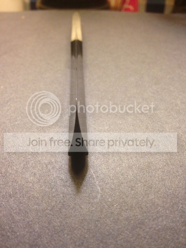

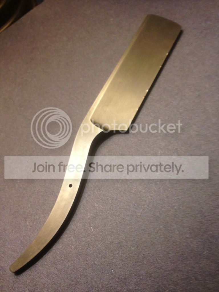

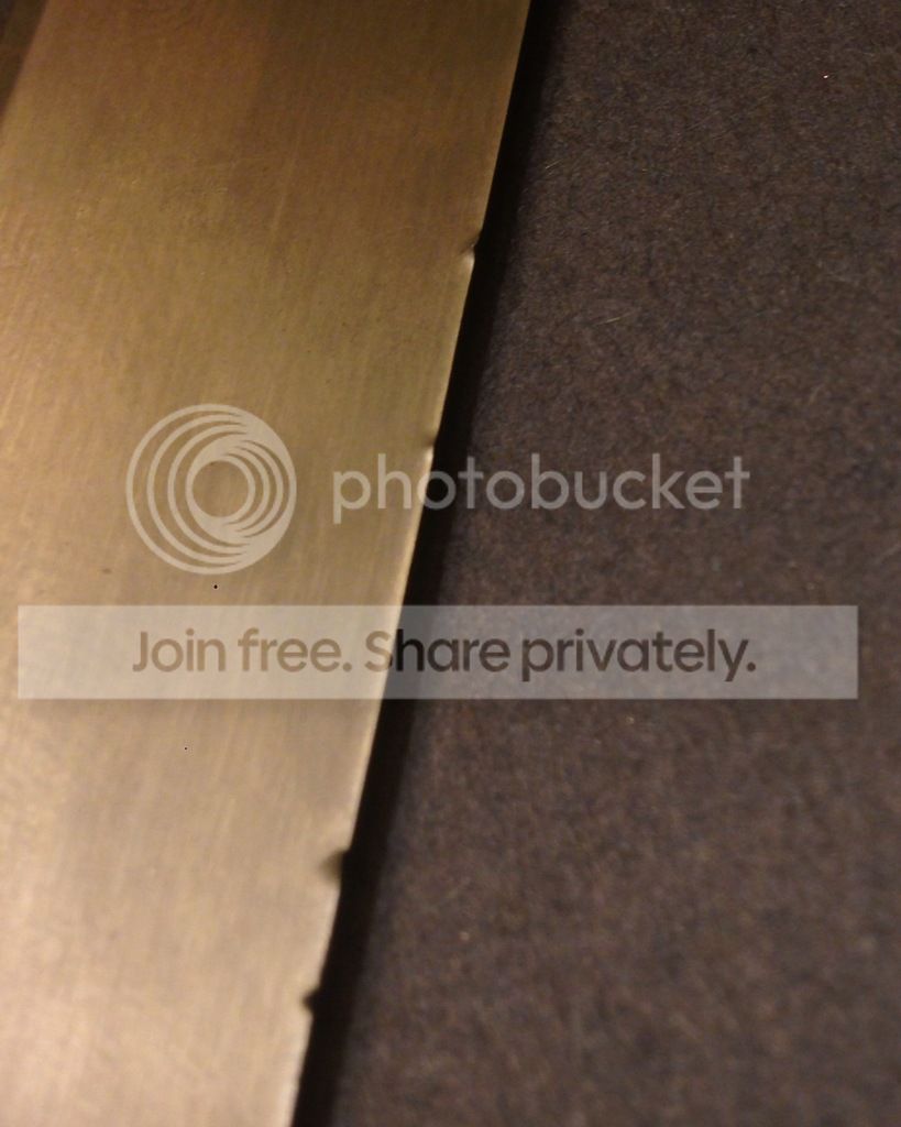

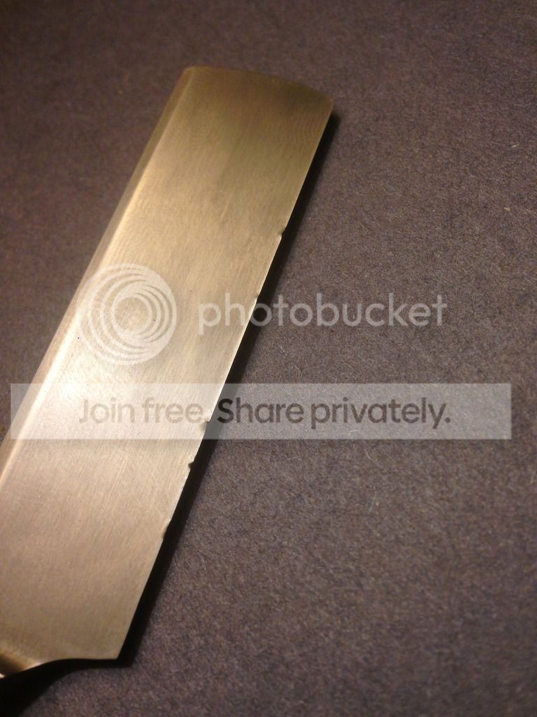

Well, I cracked a blade before.. but this.. this is new. I've spent way too many hours on this razor, only in the end while hand sanding to realize something wasn't right. Here's the weird thing (to me).. up to about the last little while of hand sanding the cutting edge bounced right back when I tried it as it got thinner and thinner, then I noticed my sand paper starting to bur the edge a bit.. then I did this with my FINGERNAIL. Hard to tell in the picture but the steel actually splits super easy, not just bends. What on earth did I do wrong.. I was really surprised, angry, and found it somewhat comical all at the same time. 1084 (the easy HT steel?) heated to 1500 in an evenheat kiln, 130* canola oil quench, 2 temper cycles at 400 for 1.5 hours each. At least that's what I think I did.. I dont drink.. so I'm pretty sure I didn't do anything out f the ordinary haha
I have another razor I did at the same time only rough ground so far. I'll obviously be redoing the HT on that thing.
I'd really like to come out on top and at least learn something from this experience, so any input would be much appreciated
A couple of my Wharncliffe knife blades have done that when I got the thickness of the edge less than .008". At .007" the edge can be flexed with my fingernail. At .004" the edge breaks.
Have you tried setting the edge back just far enough for the edge to be about .008" thick or thereabouts?
That's what I was going to saw, at that thickness even hard steel won't take much to deform.
I agree that the edge is probably too thin. Without some skill and really good equipment, you really don't know if the edge is .005 or .002" thick.
Other suspect is that the blade/edge is too hard.

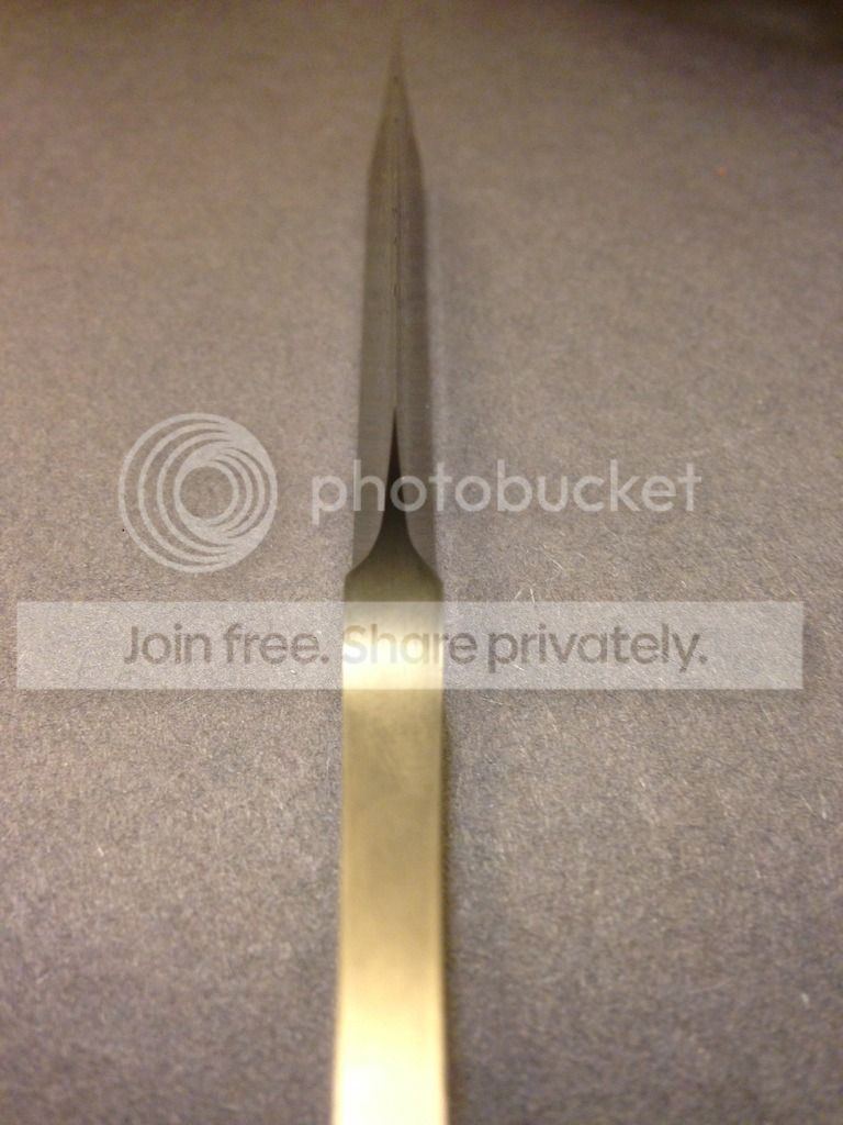

Thanks for the comments. If I take the edge back that far it will mess up the geometry needed for honing a razor, this is 1/4 in thick at the spine and already at 13/16 to the edge. I could try but I might just hang this one up on the wall of shame.
Stacy, if the edge was too hard would those pieces not break off rather than tear and bend? Not trying to question your knowledge Ive learned a lot reading your posts I'm just trying to wrap my head around what I've done wrong here.

I used an 8" wheel to rough grind this one, then went in with a 5" wheel to hollow it out more after "HT" :rolleyes: . You could use an 8" wheel on a 7/8 or 8/8 razor though, I think it ends up being called a quarter hollow grind.
Yea 1/4 spine and you can go around the 7/8 razor give or take, it depends how high you take the grind and how much shoulder you leave to give you an exact angle when you hone it, but everything I've been looking at was basically in around this. I'm still learning the geometry. The first razors I made were small fixed blades, with not nearly enough thickness to the spine for the blade's height,. I didnt even know that was a factor when I started on these.

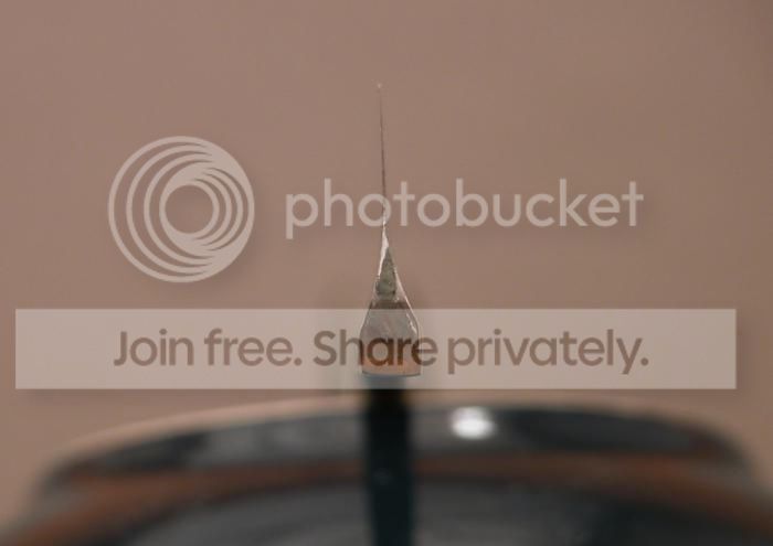

One of the members on a razor forum posted this in reply to a question I asked on thickness, it's .004 at the edge and .010 1/4 in from that.

So do you guys figure steel at that thickness will deform from pressure of a fingernail at say 59hrc? Not trying to beat a dead horse here I'm just confused. That's in around where my HT should have gotten me, or is my blade too hard, too soft, or wha. I cant chip the edge it just bends then tears.
