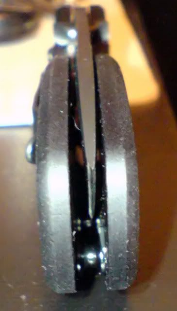

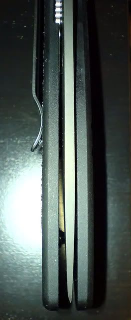

In the below picture (S60V Blur) you see how the blade sits relatively centered when closed. I was looking at mine and it sits slightly to the right (see other pics) Sorry for the bad quality, just used my cell phone instead of my DSLR :D
Now is there a way to "realign" this so it is centered or should I take it back? I remember the guy who was showing it too me saying that they "crank" that center screw because he couldn't open it at first and had to loosen it. Does this affect it in any way? *edit* Could the liner lock be pushing on the blade slightly causing this? Seems like it.

Tweaking the pivot/handle screws might help center the blade a little more, but honestly, if you're going to carry and use it, as long as the blade isn't rubbing against the liners (which it doesn't appear that it is), you should be fine. You've always got Kershaw's CS and warranty to fall back on.

My Speed Bump blade is slightly offset like yours. Its because of the brass washers. One is thicker and larger in diameter than the other. There are no issues, and does not hit the liners so dont worry.
Ok, I took a closer look at the Blur and why the blade was not centered and it was because the pivot screw(?) was loose. Took out my trusty torx bits and tightened it up a bit and...BLAMO!! now it's all straight. Guess the guy at the store loosened it too much when he was showing me it. So happy now. Thought it was "defective".

tcc, I had the exact same problem with my Blur, and I'm certain it's because of the liner lock pushing on the blade, as you suspected. I tightened the pivot screw slightly, which moved the blade toward center but not all the way there. To get the blade perfectly centered, I'd have to tighten the pivot screw such that the blade couldn't open easily, if at all. I wish I knew how the blade got so perfectly aligned in the picture you posted for comparison.
When it comes to tightening the pivot screw, I noticed that there's a very small difference between just right and too tight, so I also applied a tiny amount of medium strength thread locker (blue Permatex) to keep the pivot screw at this exacting but ideal setting. Now it's closer to center, so I don't have to worry about the blade scraping the inside of the handle. Also, notice that when you place your thumb against the blade to open or close it (assuming the knife is in your right hand), you push the blade away from the inside of the handle, which ensures you won't scrape the blade even if it is off-center with only a little clearance between it and the handle.
Seems like designing this knife with larger diameter washers on the pivot screw would have fixed this flaw.
