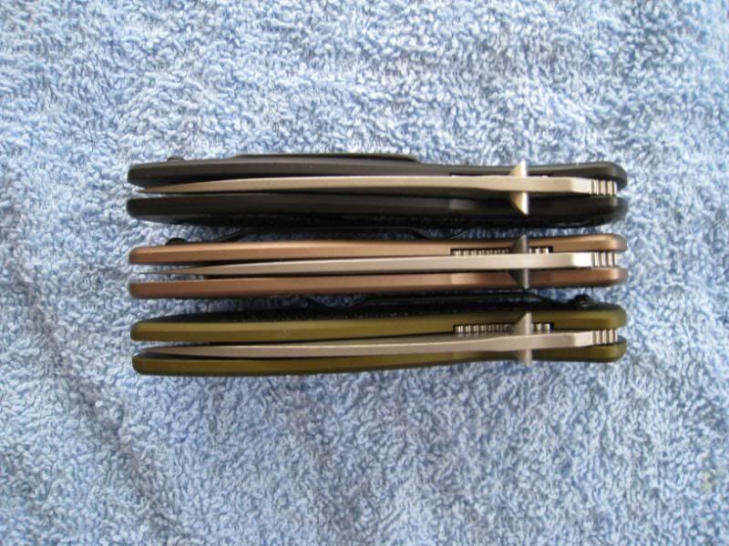

Hey guys, here's some more pics of the three Blurs.
Top to bottom: S30V, SG2, S60V.

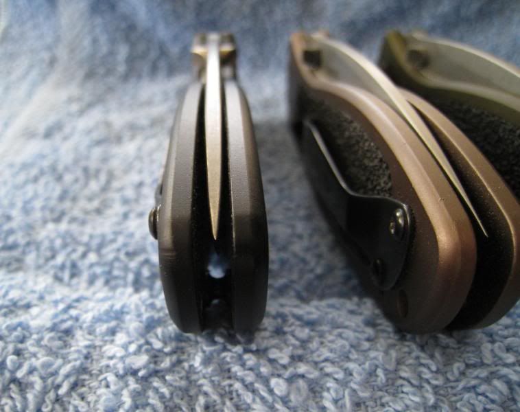

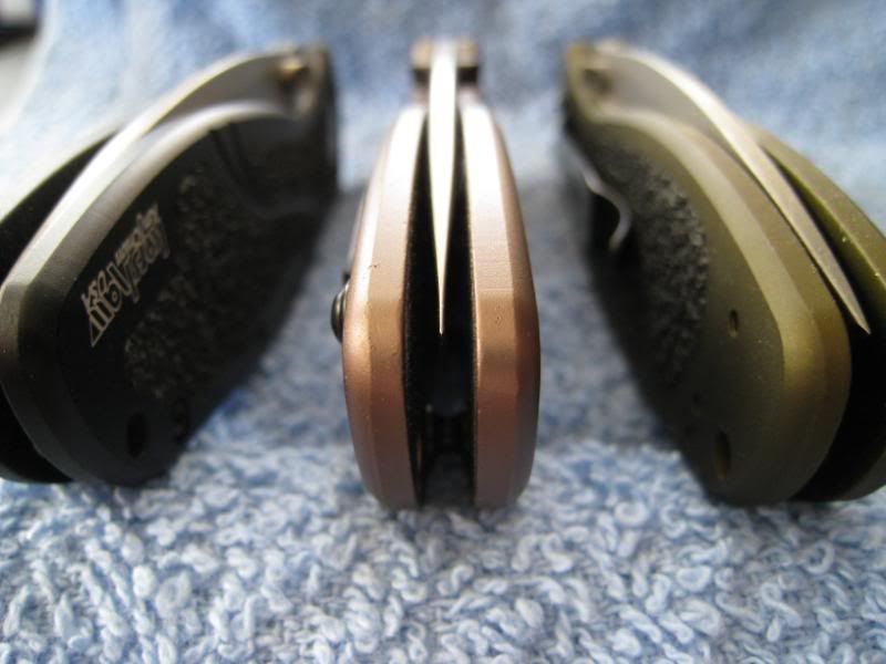

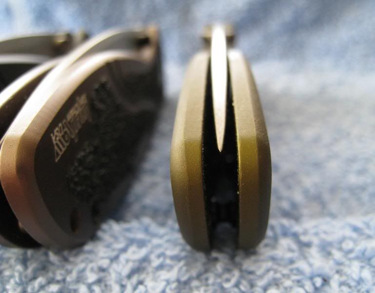

The Macro function of the camera distorts the alignment of the S30V and the S60V, so here are some shots of each:
S30V (Ugh! Gotta work on that tip a little bit!)
SG2
S60V
My point of this is that the S30V is not aligned as perfectly as the other two. Now I could spend some time and tweak the handle and pivot screws, but since the blade is not touching the liners, I'm satisfied. I carry my S30V (and the SG2, look at the edge width compared to the other two...it's a scalpel!), and the slight alignment problem isn't an issue to me. Please keep in mind that these are production knives, not customs, so the tolerances will vary from knife to knife. Believe me, if Kershaw thought for a moment there was anything that wasn't up to their standards from a mechanical standpoint, you wouldn't have the knife in your hand today. If it were a cosmetic issue, there'd be XXXX stamped on the blade, but the knife would still be 100% sound mechanically and fully covered under Kershaw's warranty for mechanical issues.
So I guess if you're going to carry the knife, it's going to get beat on anyway. If it's a safe queen you're looking for, there's always Kershaw's excellent CS. There have been post after post about someone not liking this or that about their Kershaw, and all have been resolved to their satisfaction, or better.
So I think calling an alignment problem a "flaw" is a little over the top.

The S30V Blur SPX picture's is a classic example of this. Personally in my eyes, the blade is within tolerances of leaving the factory. I'd be satisfied. If it doesn't pass stanton2's QC, then there are avenue's to get it taken care of. Did you take any of these avenue's stanton2?
