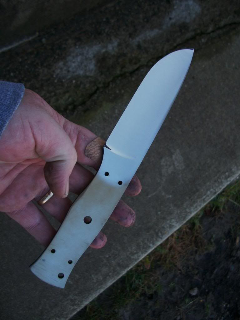

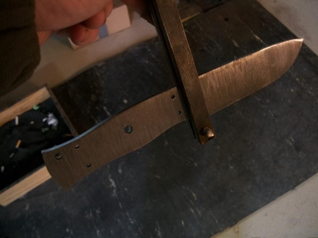

ASWELL I FREE HAND GRIND ALL MY BLADES, I HAVE THE CLAMP U SEE IN THE PICS ON THERE TO KEEP MY PLUNGE LINES IN ORDER

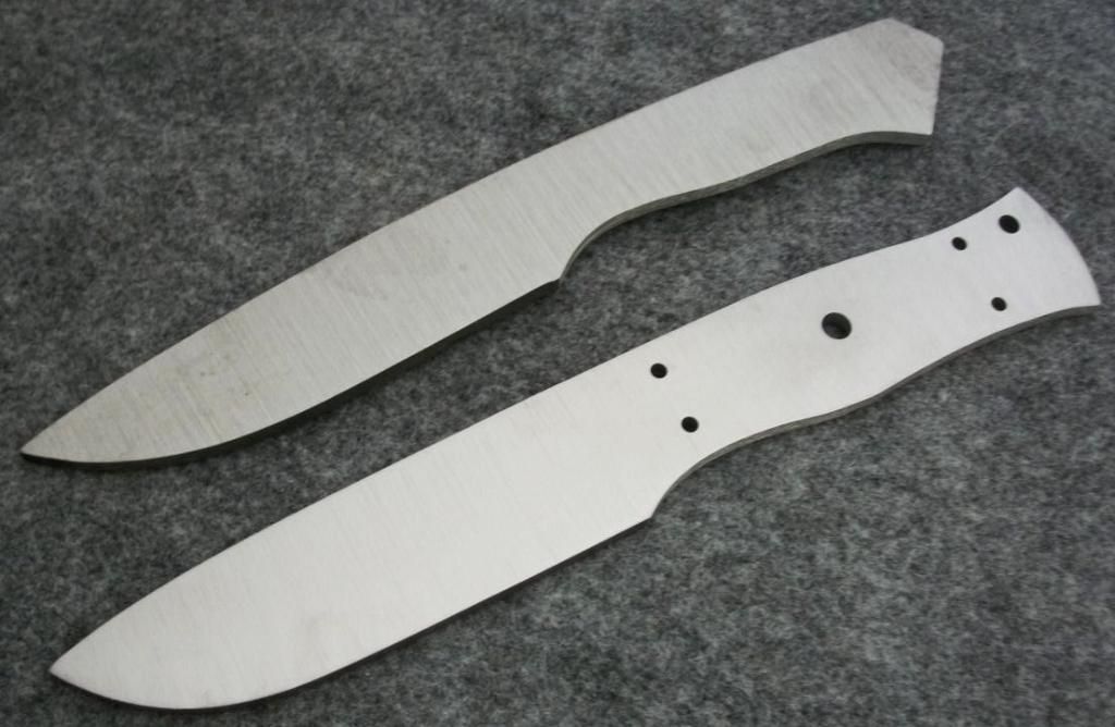

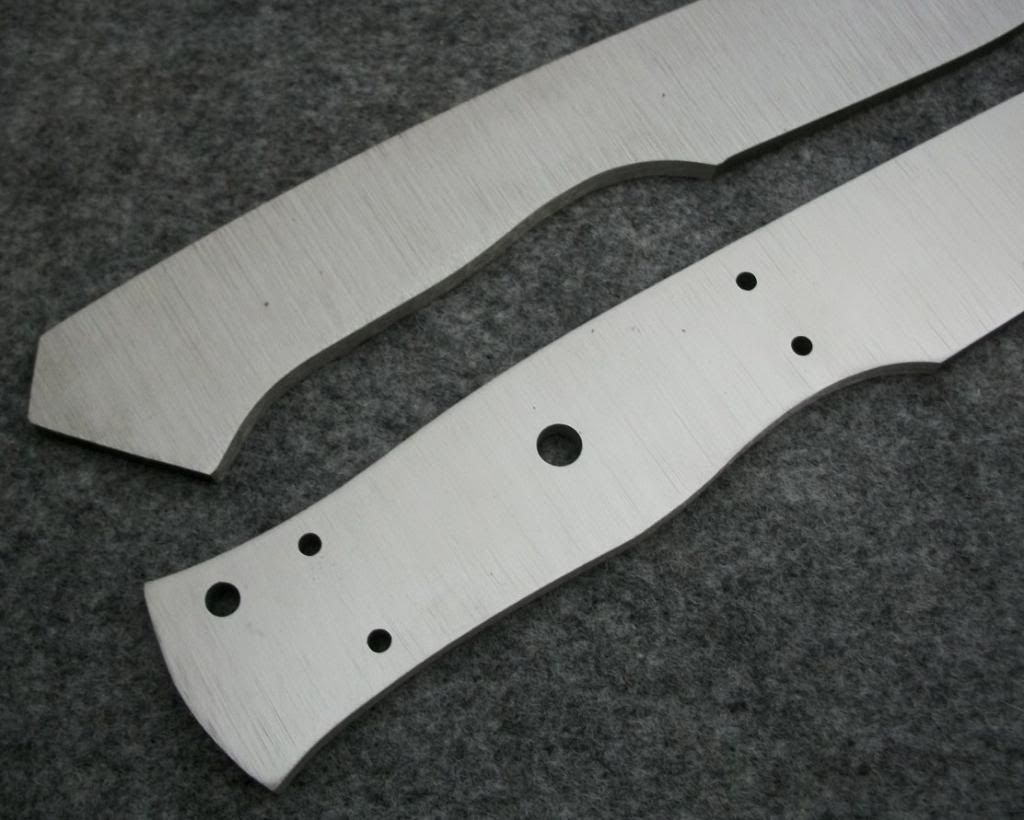

1095 STEEL / 5/32" THICK / PROFILE THE BOTTOM ONE IS THE BUSHFISH
I NORMALIZE 4 TIMES AFTER PROFILE IS COMPLETE, BRINGING IT UP TO A NON-MAGNETIC STATE AND LETTING IT COOL TO ROOM TEMP
NOW BACK TO THE GRINDER TO REMOVE THE SCALE
NOW START GRINDING, IM GOING WITH A FULL FLAT GRIND
NOW I FINNISH SANDED TO 1500 GRIT ALMOST MIRROR FINNISH

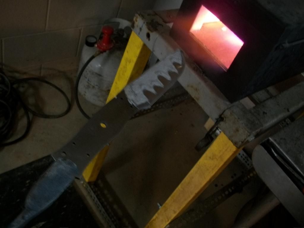

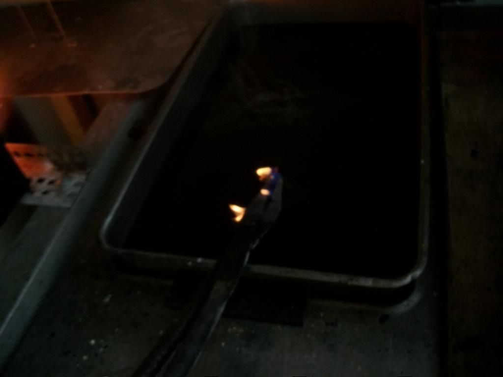

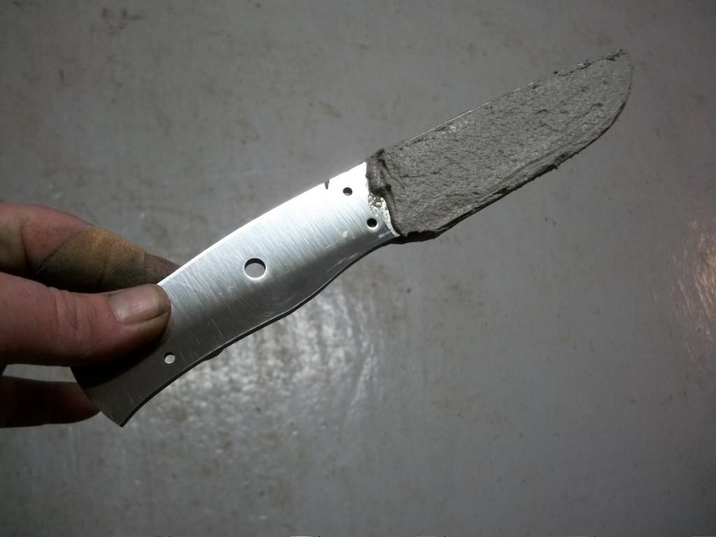

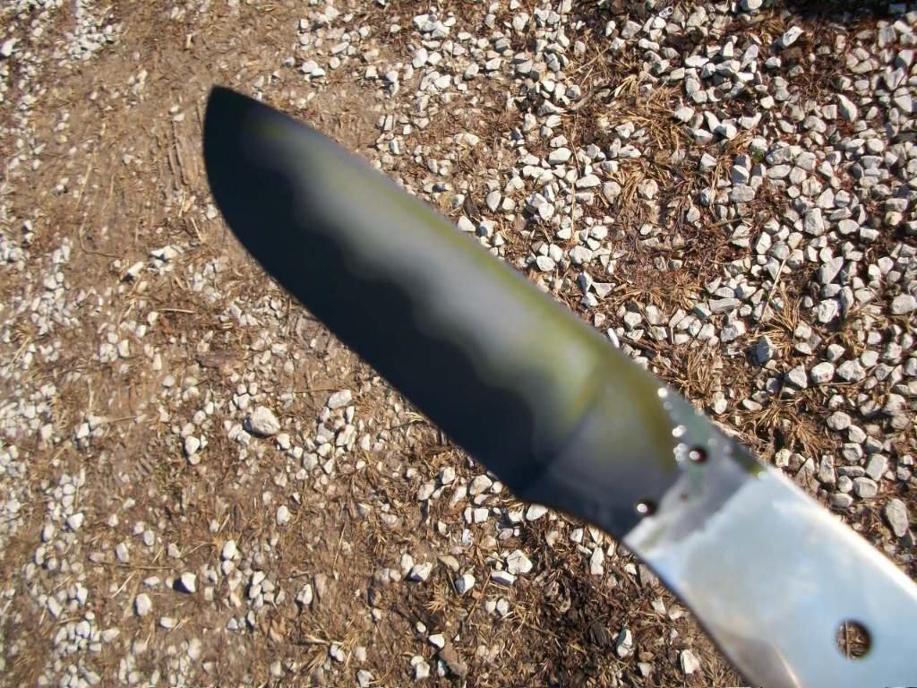

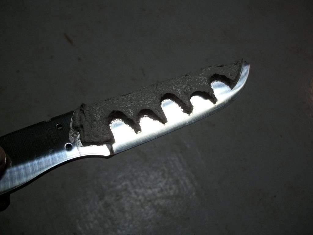

NOW FOR THE FUN,HE WANTED A "HAMON" ON THIS BUSHY,APPLYING THE CLAY COAT AND MAKING MY LINE

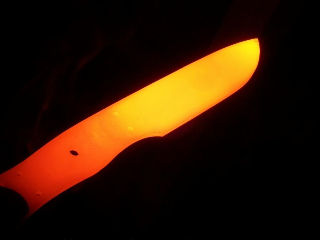

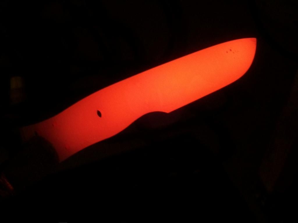

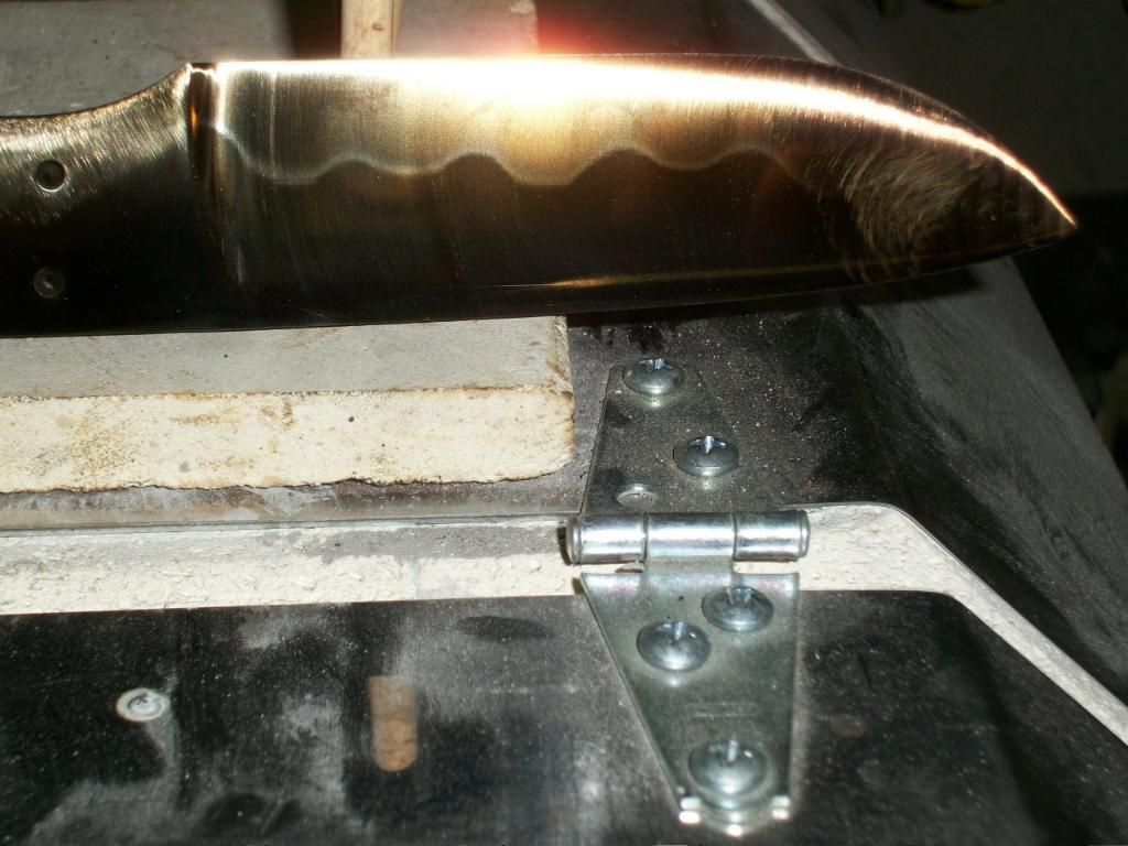

NOW WERE READY FOR THE FORGE AND A FAST QUENCH

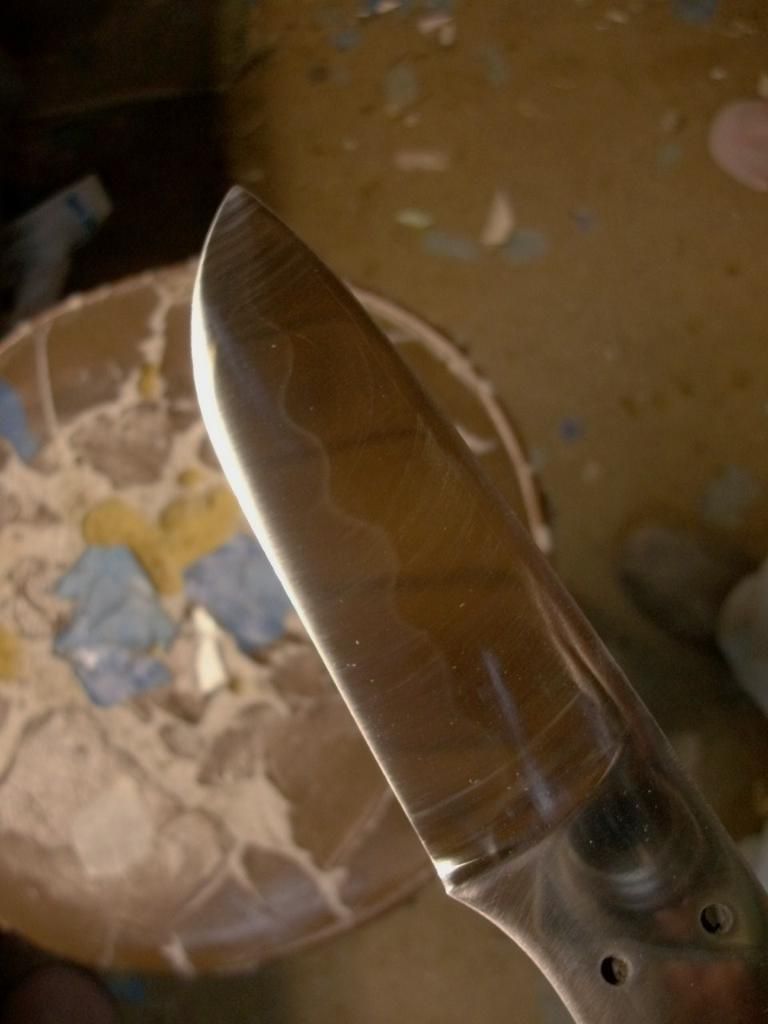

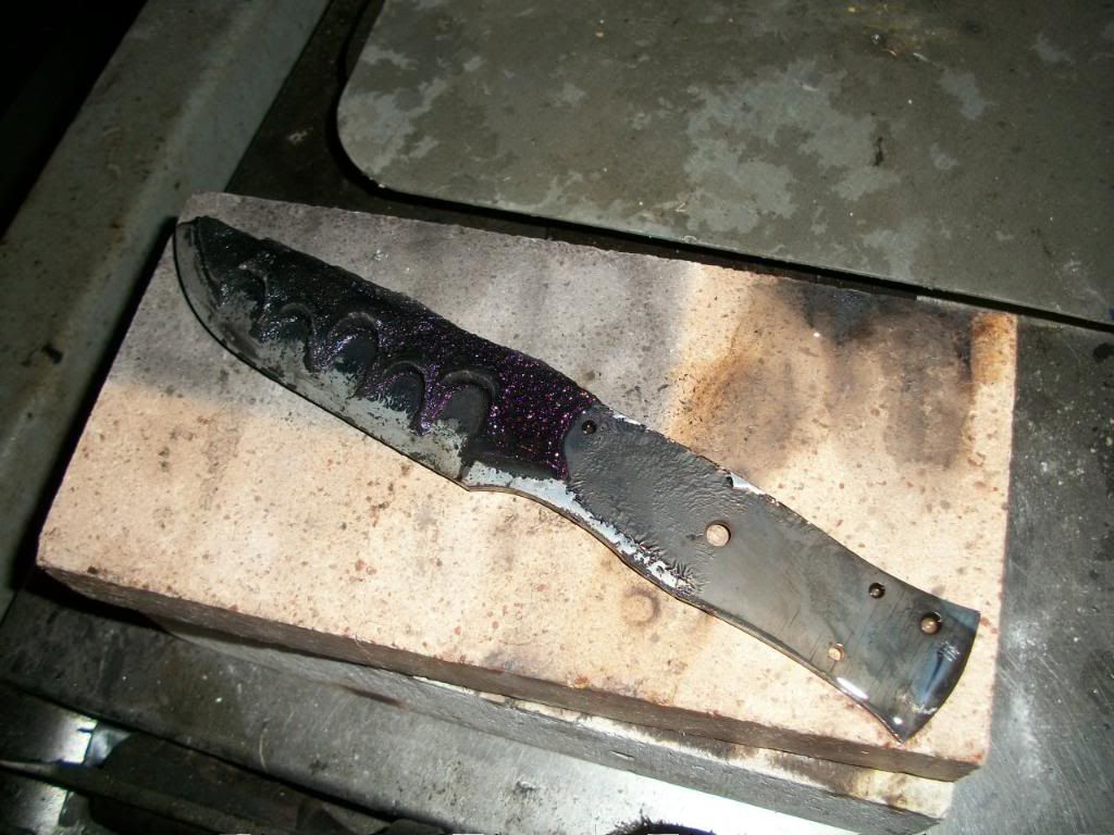

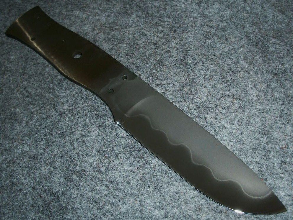

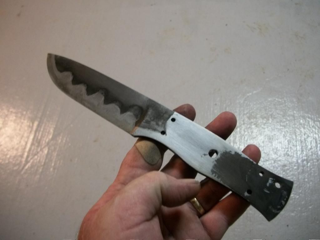

NOW TO REMOVE THE CLAY AND SEE WHAT KINDA HAMON WE ACCOMPLISHED
WELL IT WAS TIME TO START THE SANDING AGAIN UP TO 1500 GRIT AND DO THE HEAT TREAT,SORRY FOR THE THUMB PRINTS IN THE PIC THE LINE IS SHOWING BOLDLY AFTER THE TEMPER CYCLE
BEFORE H/T
AFTER H/T

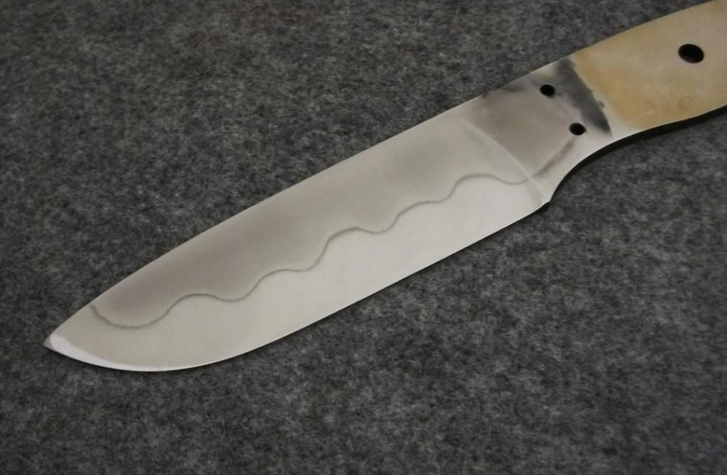

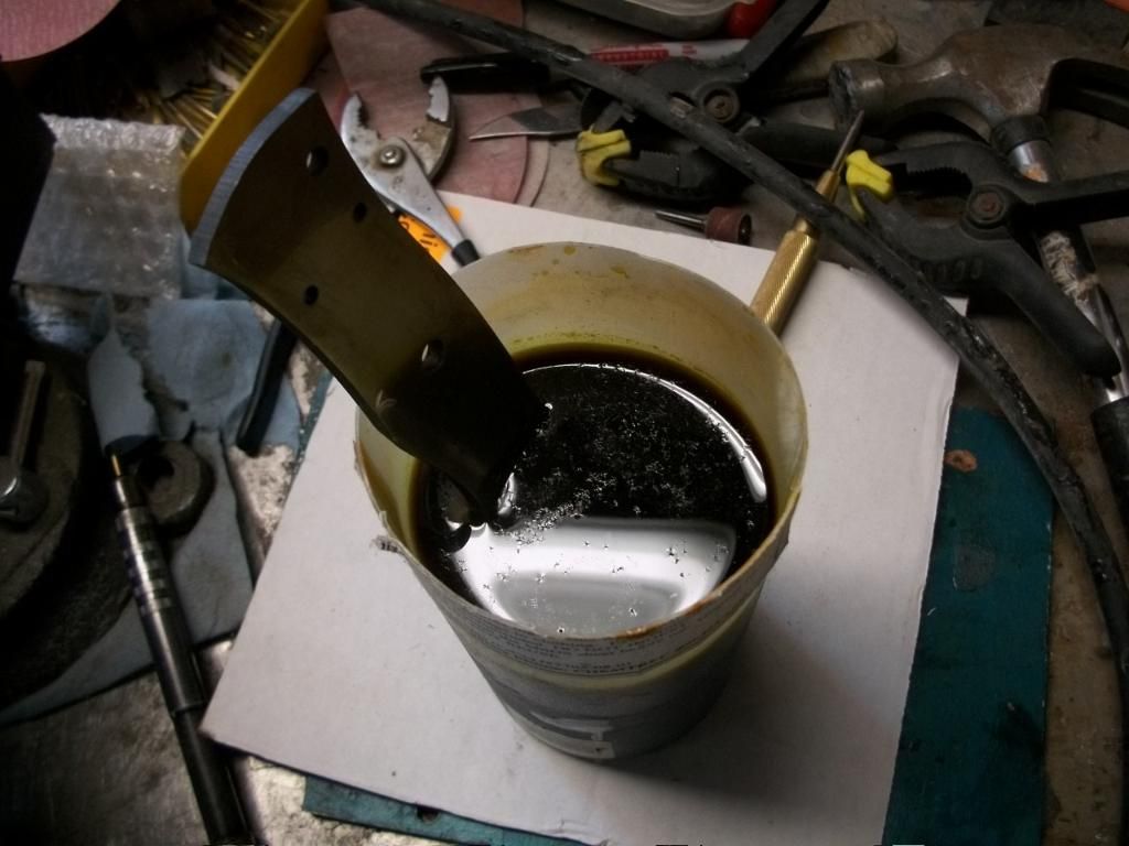

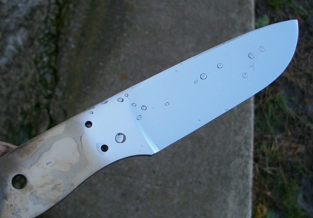

OK TODAY IT WAS A QUICK BUFF TO GET THINGS STARTED TO REMOVE THE STRAW COLOR FROM THE BLADE FROM HEAT TREAT, THEN A WASH WITH SOAP AND WATER SO THERE IS NO RESIDUE ON THE BLADE BEFORE THE ACID BATH
OK NOW IT TIME FOR A ACID BATH

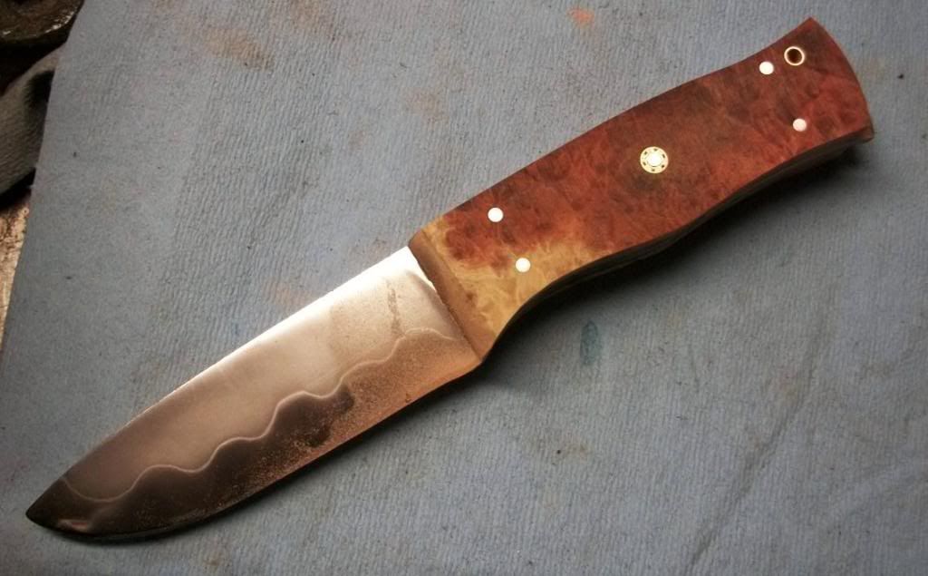

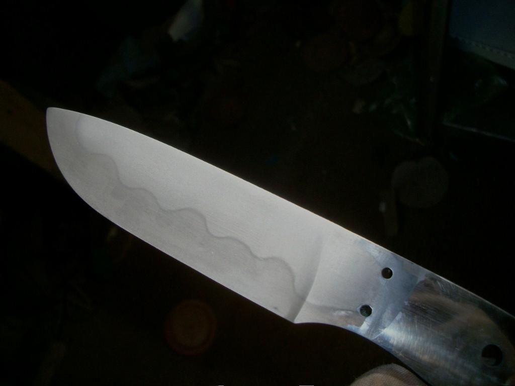

THEN A QUICK WASH WITH WATER AND TOWEL DRY, THEN A LIGHT HAND SAND, THEN A LIGHT BUFF AND WOW!!! CHECK OUT THE HAMON

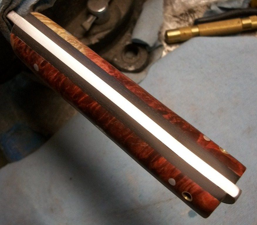

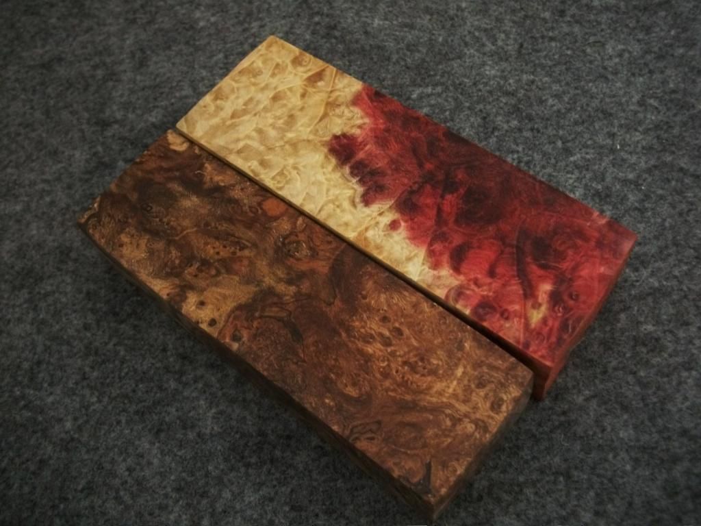

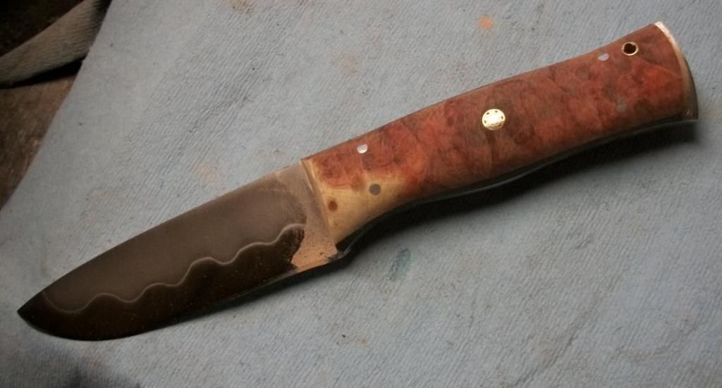

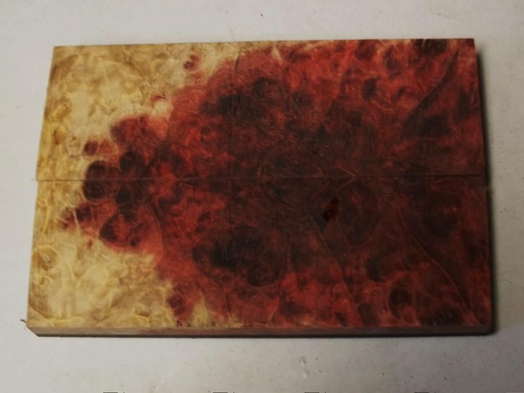

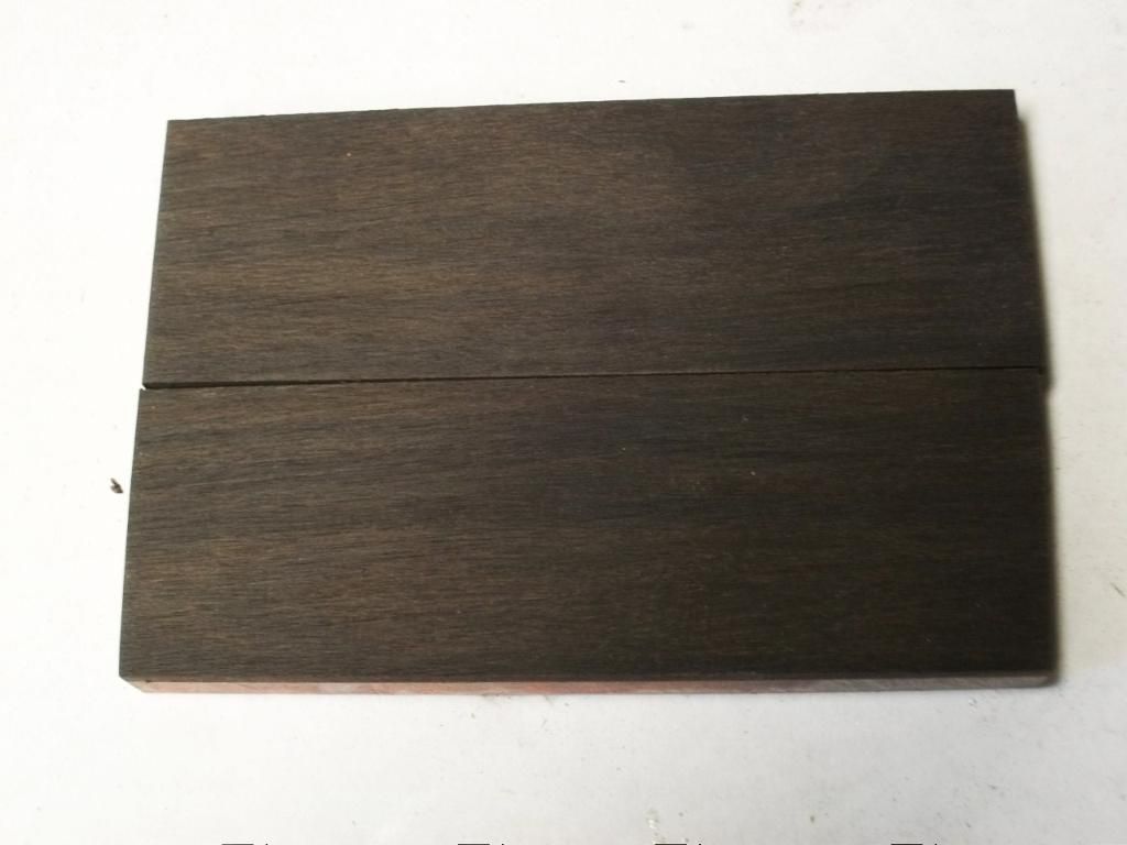

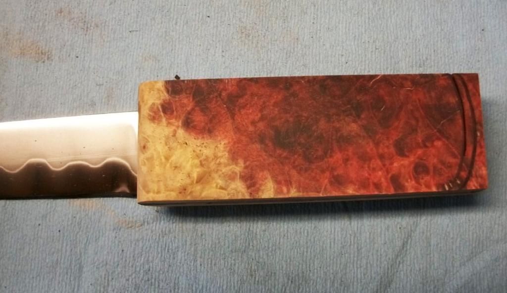

NOW WE ARE READY FOR THE HANDLES STABILIZED MAPLE BURL OR STABILIZED FLAMING BOX ELDER
YOUR CHOICE CHRIS MAKE YOUR MOVE WHICH DO YOU WANT?

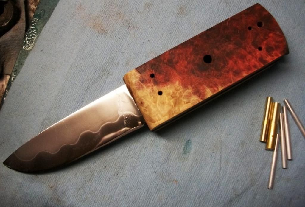

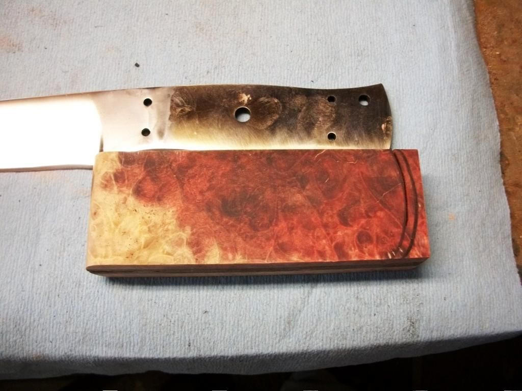

HERE WE GO CUTTING THE BLOCK INTO SCALES, FLAT SANDING THEM ,CUTTING A PEICE OF EBONY FOR LINERS BONDING THE 2 TOGETHER AND SANDING THERE RADIUS,DRILLING ARE HOLES FOR PINNING,SHAPING AND FINAL HAND SANDING
TO SEE THE FINAL FINNISHED PRODUCT PLEASE USE THIS LINK THERE WERE ONLY 40 PICS ALLOWED PER THREAD PLEASE CLICK HERE TO SEE THE REST OF IT
