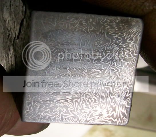

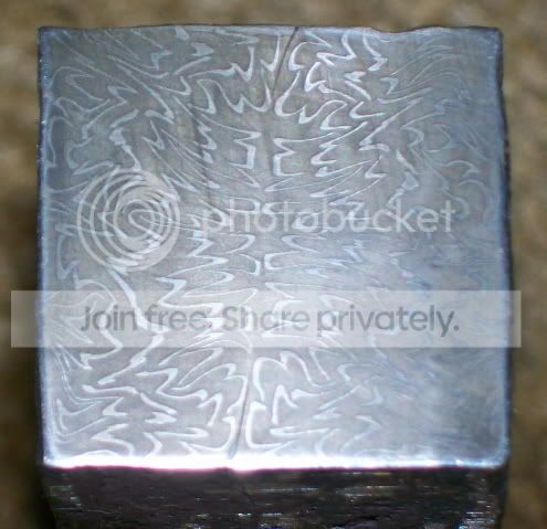

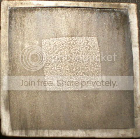

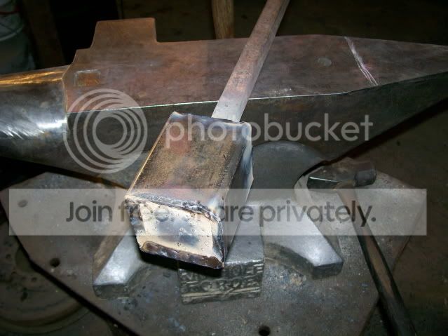

Here is the first mosaic I've done in a can, the powder was 1084 the main billet was a w pattern of 1084 and 15n20
Really cool pattern. Great job.:thumbup:
Soory for the noob question. Is the 1084 sacrificial to get the smaller damascus billet inside? Thanks!
Thanks for the comments fellas.
Edro20 I used the powdered 1084 to incase the main billet so to get mirror images if I were to acordain cut it or tile it and to have extra material to use for bolsters, the billet was long enough I will get a blade and some tiles out of it.
