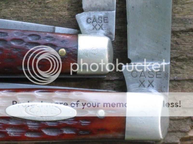

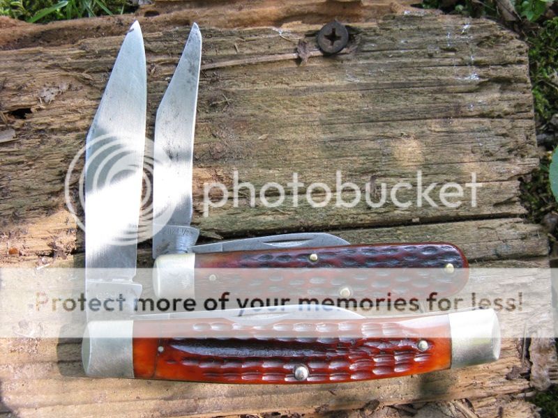

I am new at the whole vintage knife thing, but these look genuine to me. Did I get taken, are these fakes, or is it just because of the sharpened down blades and crack in the bone on the back of the 6292 that they came to me so affordably?
62024 1/2 and 6292
Not the best shots because of the mid-day sun, but you get the idea.
They're worn but they're the real deal. It does depend a lot on condition but even some mint oldies don't sell for much more than new ones... some sell for a lot more... it depends on how excited collectors get about a particular pattern.
The blades look like they have a lot of life left.

I think so, too. Both look like they have seen some good use, but depending on how old they are and how they were actually used they don't look to be in bad shape at all for good work knives.
The very things you noted will kill their value as a collector's piece but certainly won't hurt their value as a tool. If I were you, I would probably take some acetone, a brass brush and a cotton swab and clean the crack, the pin, and the small piece of cracked bone as well as I could. I would then carefully apply some water thin "super glue" to the the same areas. That should keep the piece on indefinitely.

I don't know what they cost you so I can't address their affordability BUT I'm digging the bone on the pile side of the 6292. See what appears to be a trench down the middle of the cover. Some would consider that a flaw but not me. That is a "bone marrow canal" cavity. Case used to be a "waste not want not company" and they used pretty much whatever bone came to hand. For a guy like me that gets into sub-categories", etc. that is a desireable knife. As to the crack, use it with a bit of caution, keep an eye on it, and if it starts to separate anymore, put a bit of Super Glue's "Future Glue" in the crack. Both knives are very nice. I'd keep both if I had them and leave them just as they are. There's a lot of character in both knives. Just apply a light coating of oil to the blades and spring and oil the joints and you're good to go.

I'm with you Ed, I really like the cavity in the pile side 6292 bone. None of my other Case bone knives have this (well, except the deep canyon chestnut mini copperhead, of course). Not as exquisite as the one on your barlow, but nice nonetheless.
I haven't even cleaned them yet. They just came in today's mail. As for price, I'll just say that these two together cost just a hair over what I paid for my 6232 from 1978.
