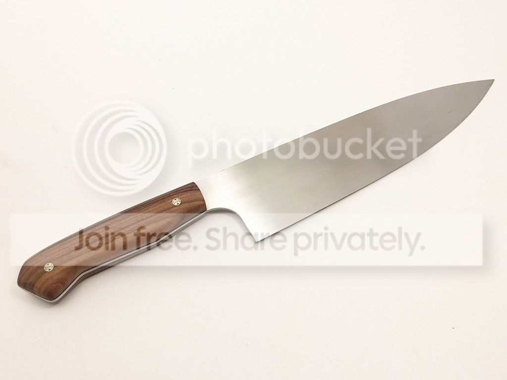

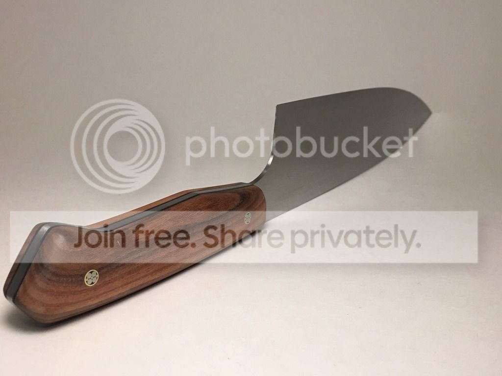

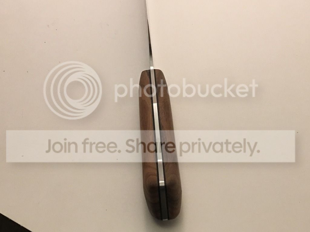

My first Chef's knife
Jan 16, 2016
56
8" AEB-L .098 thick from Aldo
3/16" brass/silver nickel mosaic pins
Bolivian rosewood handle with black liner.
2" tall at the heal
This is my first Chefs so any thought good or bad are appreciated
Great job! For a first chef's knife, or your 300th, it looks awesome! I might would have the handle extended a little more further forward, but that's just me. You should give yourself an "atta boy!"
Looks really solid! The best evaluation is using it every day--you will find all of the flaws pretty quickly. There are a lot of features of kitchen knives (like all knives) that come down to individual preference, anatomy and use, but there are a couple of things that come to my mind:
1) The area behind the heel where it curves up to the handle appears to have square corners. If you are holding the knife in a pinch grip, these will dig into your fingers. Try rounding these out.
2) The scales end pretty abruptly at the base of the blade. Again, this looks like it would be uncomfortable in a pinch grip. Try rounding this area, and thinning the scales out at this point. I've got my Henckels Chef's Knife in front of me, and the scales themselves thin out to just under 1/4" at the forward end, and the bolster continues to narrow down to only about 3/16" at the base of the blade. I wouldn't recommend emulating very much about this knife, but it is very comfortable to hold in a pinch grip. Even if you are leaving a ricasso between the scales and the blade--in the fashion of Japanese kitchen knives--you may want to make this transition a little bit easier. I angle the forward edge of my kitchen knife scales at about a 45º angle so my thumb can rest on this spot comfortably.
3) Kitchen knives see a lot of water, heat change and stress--even if you are diligent about keeping them out of the dishwasher. I recommend three pins or corby bolts. Bob Kramer uses one bolt on each end and a mosaic pin in the middle.
That said, you have clearly done your research on what makes a good knife. A lot of people's first chef's knives have odd and impractical shapes, and axe-like grinds. This looks like a really classic German pattern with a thin edge--I like to shoot for 0.005-0.008" behind the edge for this style. You also took the edge all the way to the heel, which I think is non-negotiable on a chef's knife.
I think you should make more of these.
Chris
I like it very much, especially the handle.
I am used to seeing rosewood on guitar fretboard and after oiling and playing for a while they are dark brown to almost black, that rosewood is quite pretty!
Thanks for all the replies. I completely agree with the suggestions with lengthening and tapering the handle. I will be rounding the edge's to be more comfortable also. I started this hobby around a year ago and have you guys to thank for all the suggestions, comments, links and advice you have offered others that I have learned from. Thanks for such a great forum. This knife shows me how much I have learned here.
