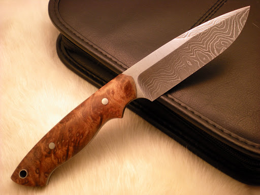

Well this is one I have been looking foward to making for a while and finally got it done! This is my first knife out of damascus and I am pleased as to how it came out.
overall length: 8 1/2"

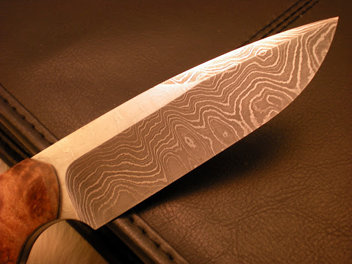

blade length: 4" of 5/32" hollow ground Alabama damascus. Now I decided to do a two tone etch on this knife, so the blade and the top clip have a deep high contrast etch but on the flats I did sort of a ghost etch, which is a lot lighter etch and then completely buffed out! This gives the knife a bit more depth in between the ricaso and the blade grinds!
Handle material: WSSI stabilized redwood burl, with stainless pins and stainless lanyard tube.

Very nice Jason,congrats on your first damascus,did you make the billet?
where did you put your makers mark?
Marc
Jason,
That's one hell of a good lookin blade! The fit and finish of the handle is excellent as well, very nice contours.
Murph
I must have used the wrong pic, I actually only put my mark on the spine of the knife because I did not want to mess with the blade faces! And no I did not make the billet, but that will be coming soon!!!
I will put up the right pic in a couple, that shows my makers mark on the spine!!!
Are you sure this is your first damascus? Hell, I can only imagine what the following ones will lok like. Congratulations! :thumbup:
Beautiful work, as usual!
The Damascus and Burl look great together and your grinds and etching are smooth!
