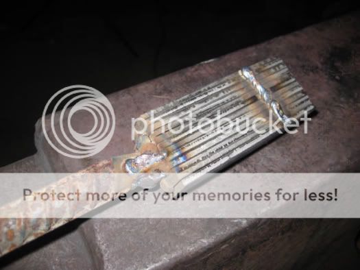

Many weeks ago around the time I started my Japanese Tanto, I decided to try my hand at forge welding. I read a bunch and asked some questions and decided that I could do it with just my forge and hammer.
I started with 6 layers each of 1080+ and 15n20 making for a stack of about 1.5" x 1" x 3". (Please don't laugh at my welds, I know I suck at it. :p)

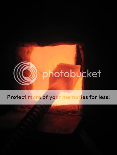

I was nervous as it went into the fire.

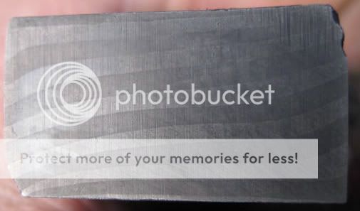

After the first weld I forged it down and quickly knocked the end off and etched just to get a little of the immediate gratification.
I then cut it in 3 and forge welded that stack. I drew that out and made it a little more rounded and twisted it 360°. After forging that flat I cut it again and stacked it.. so what's the count? I figure it should be 72...
Well with forge welding temps, compounded by the number of heats to do this by hand... and then add in the nervous factor which had me forging this really hot, concerned the whole time that my welds wouldn't take.. (and fluxing the thing like mad)...
Looks more like I have my original 12 layers. :p:p:p ...:rolleyes:
Still, I'm pretty happy with the result. A little tighter pattern would have made for a better contrast but I'm not complaining.

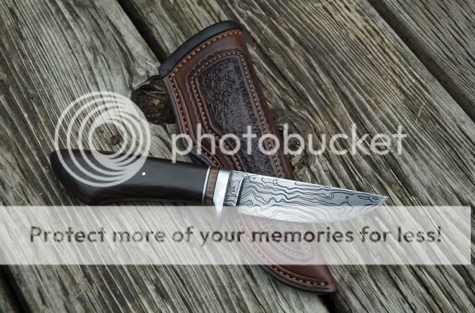

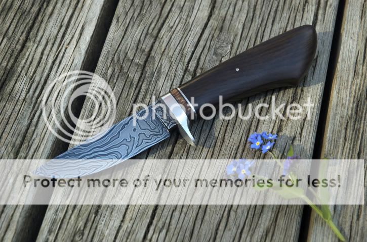

Specs are:
-3 1/2" guard to tip with an OAL of 7 3/4"
-guard is 416ss with Koa spacer (flanked by g10)
-handle is African Blackwood

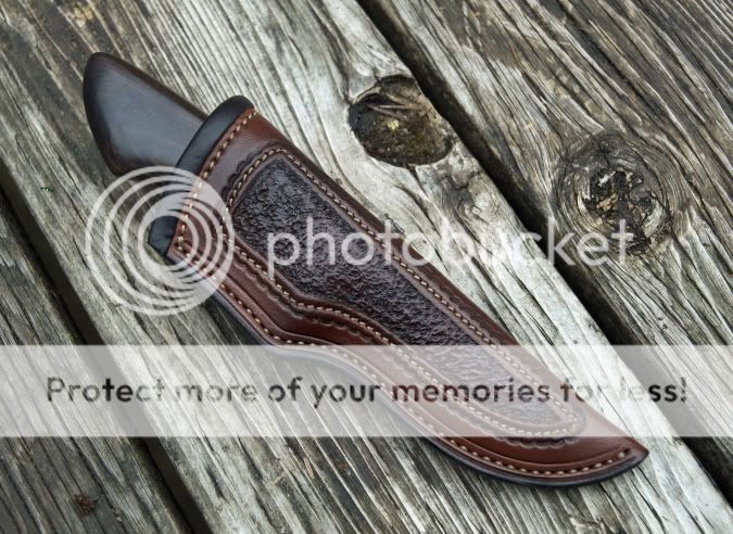

Sheath to follow... gotta think of a design.
Funny thing though is that I'm sure you'll recognize that this looks quite a bit like a Sendero knock off... I drew the handle about 6 times and I think unconsciously I arrived at this and then it occurred to me that it looked a little familiar.. This has really shown me the genius of Mr. Fisk's design. After trying so many handles with that blade shape, I really couldn't see any other that looked so balanced.
Thanks for looking.
**EDIT** Sheath finished

I'm sure you know the feeling of all this work and never knowing until the very end whether the welds worked or not. I did have some minor scares along the lines where the twist was forged flat but they came out with the grinding, thankfully.
I should take a pic of the spine because there you can see the twist.
