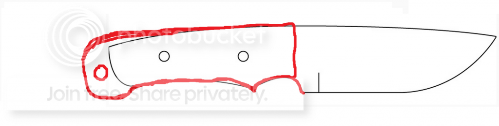

So I just got some 440C in the mail from Jantz so I am going to start on my first "real knife" this weekend.
I drew this up in Adobe Illustrator and am mostly happy with it, but the handle kinda bugs me. I need to print it out and make cardboard cutouts to get the final dimensions I want, but I am looking at making it 6-7 inches long from 1/8" x 1.5" bar stock with the blade being just over 1.25" at the widest point. My goal for the knife is to just be a nice utility/hunting/fishing fixed blade.
Just a quick sketch to save me from typing so much, but extending and widening the butt will help, just a typical handle, it is your first knife anyways so no need to be fancy
Here is another one, with this all I did was crop out the butt of the knife, flipped it, so now it is on an incline towards the blade, just round it off and it will be fine
I like your design but keep it simple. Personally I would prefer something a little more pointy but I'd only drop down the tip of the knife down another 1/8 of an inch. The finger choil seems a bit off, maybe even symetrical. As you suggested, a cardboard cut out will help a lot and give you a good feel for what you like or don't like. Good luck and keep us updated on your progress!
I like your pattern but would however make the blade not as wide and the figer notch longer and a little deeper. Frank

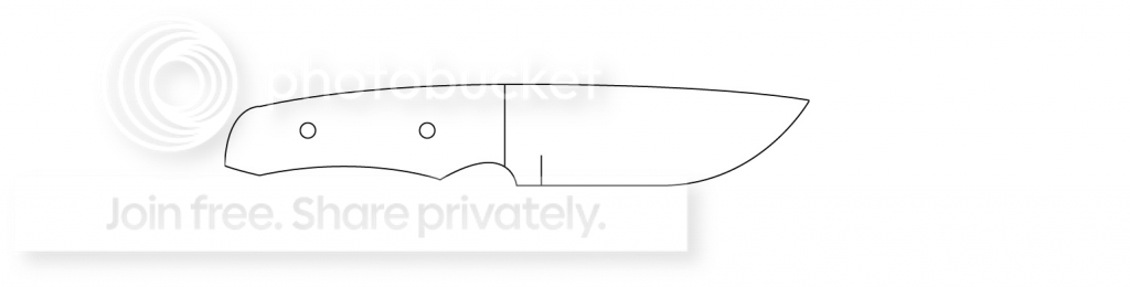

quick update to the illustrator design going off kershaws modification, and yeah that front choil was annoying me bad.
Another revision, dropped the point, raised the edge and added a bolster, but I think the bolster might be going away, or getting changed...
Like I always say to people asking for design input, make a model in wood or cardboard first to see how it feels

Well, I cut it out in a scrap piece of pine wood today, sure glad I tested with wood before going straight to the steel, the handle needs to be about 1/2" longer, the bolsters need to be bigger, and the blade needs to be 1" - 1.5" longer imho...
Made the blade and handle longer, forgot to re-space pin holes but thats fine. the cutout actually feels really good in my hand now!
I think I am just about ready to get this knife cut out of some steel.
