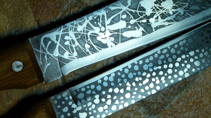

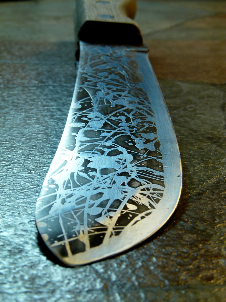

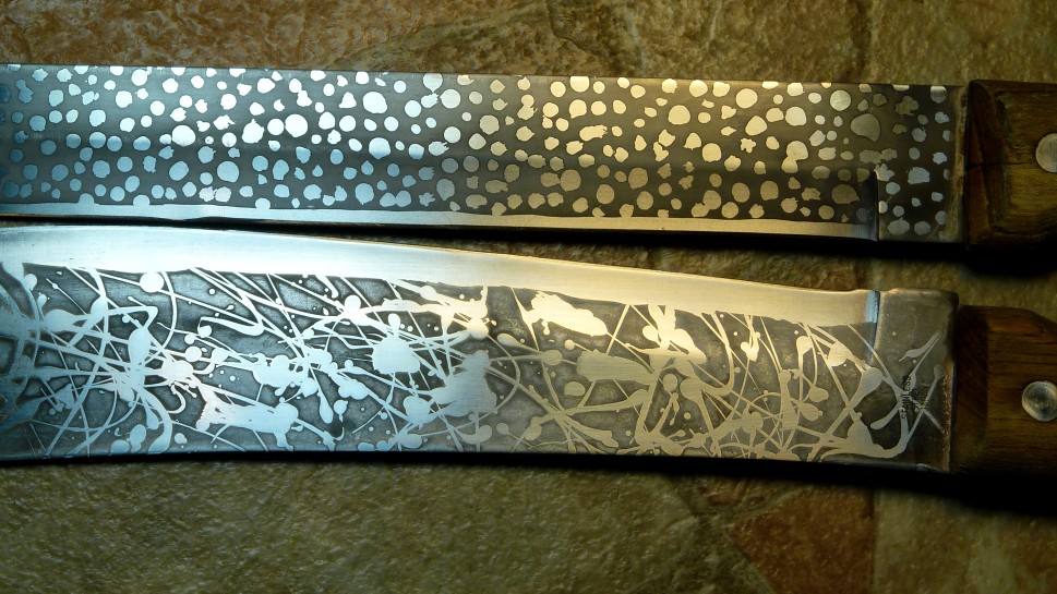

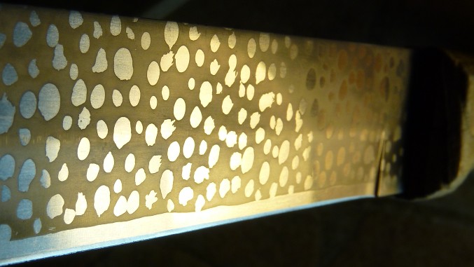

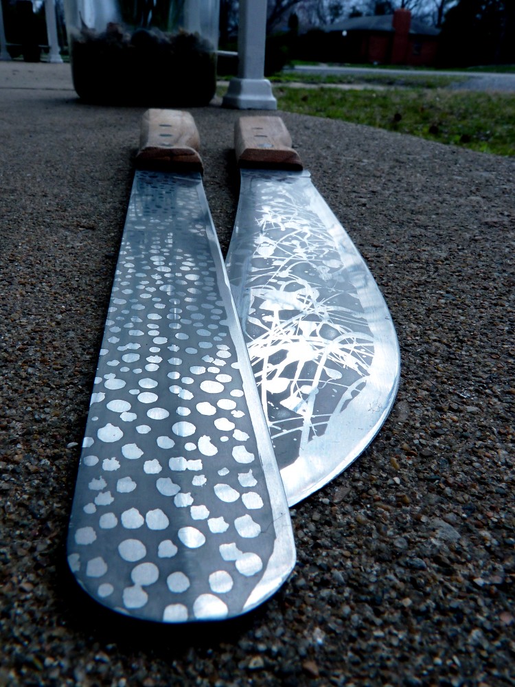

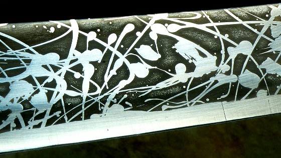

I found two old and tarnished knives in a box. Both knives are cheap stainless junkers. I sanded/buffed them both to a high (not full mirror) polish that could be used to easily read reflected text. I really didn't worry about getting every scratch out as these are proof of concept blades. The goal was to test the paint application methods and etching methods. It took about 30 minutes a blade. All my knowledge was gained via YouTube. Please tell me what you think of these first ever "customs". Let me know what you would change and advice you have gained through experience.

Definitely like the splotchy one better than the polka-dots. Keep practicing, I think there's some promise here.
I agree with the promise part but I like the dotted one. It looks like a whale shark. (An actual whale shark, not the knife)
What'd you use to etch them? And what was the process in general. They look really nice. I haven't had much luck getting stainless that dark.
Nail polish covered the shiny spots. Maybe the pink helped! :) I used a battery charger with salt/vinegar solution and cotton balls.
Make your pattern on a very clean blade, nail polish is very cheap and easy to use.
Allow lots of time for it to dry, the globs take forever to set up.
Mix some salt in a dish with vinegar. (You will do electrolysis as a side effect and make chlorine and hydrogen gas. Don't huff the fumes but it's no big deal.)
Dab a cotton ball into the mixture.
Red + lead clipped to the blade, Black - lead with the cotton ball.
The best results came from keeping it moving and not dabbing it.
I only etched for about 3-4 minutes a side, it was really quick using the 6 volt setting.
