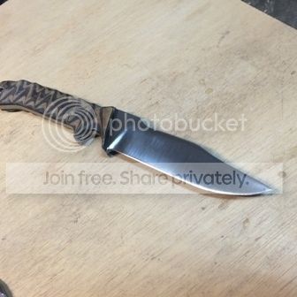

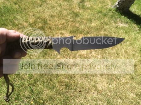

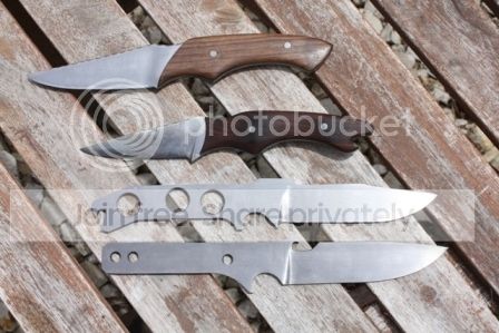

These were my first 4 knives. Let me know what you think.
The first one was made out of 1095, and ended up with no plunge lines at all. Plunges were all but impossible on a 4x36. The wood was some exotic scrap that I had laying around my garage for about 15 years so I figured it would probably work alright.
On the second one, I had cut a notch out of platen area of the 4x36, which allowed me to attempt a plunge. I was really unhappy with the design of this one in the end, but it works great.

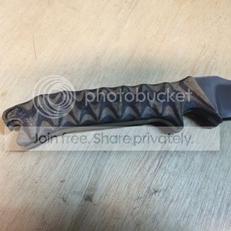

The third one is 0-1. I tried harder to get a proper plunge, but ended up with a weird sweeping plunge. I also tried my hand at home micarta for this one. I had put an acid etch on it that I was unhappy with, so I scotch brighted it off.

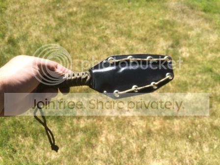

the forth one I made for friend. Also 0-1. I acid etched this one too, and was happy enough to leave it. My first attempt at a Kydex sheath as well.

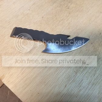

Still in progress is this EDC idea.

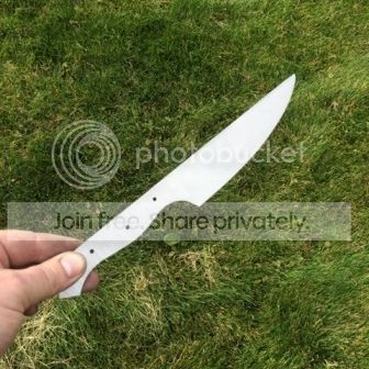

And right now I am working on some AEB-L kitchen knives.
I am trying to make 6 of these at the same time, and plan on giving them out as Christmas gifts. Flat grind, with no plunge. I figured since I just cant make a good looking plunge, I would just omit them. In some ways its harder to eliminate it, but I think the final product would be much nicer.
In a 2 of these, I already have a slight bend. I plan on having these plate quenched. Would that take care of the bend? I've read on here a few people say to just hit it with a wooden mallet pre HT. This terrifies me. I afraid Ill just make it worse. Any advise on how to get rid of it would be appreciated.

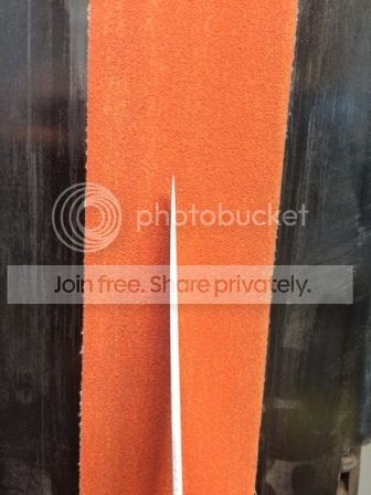

Also, I am loving my scotch brite belts, but they are starting to get clogged up. Is there a way to clean/dress these belts?
