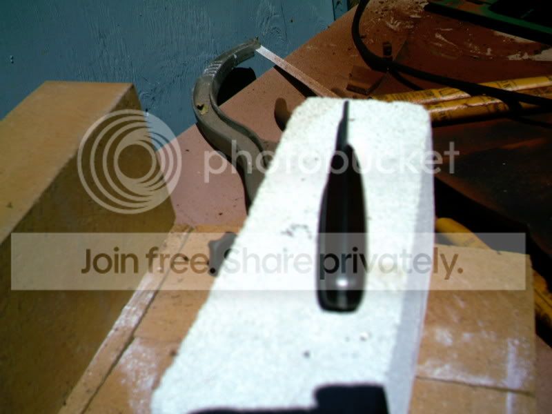

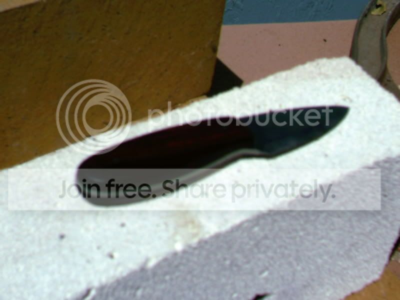

Hi everyone. Thanks to all of the members here on BF I was able to learn how to and finally finish my first knife. Well, it still needs to be properly sharpened.
Steel: 1/8" 1080 that was generously given to my by pimp'n squee or as he is called now J.McDonald Knives.
Heat Treat: Done by me, not to sure how that came out so we'll see how it does during everyday use.
Handle: Cocobolo finished with tung oil
Pins: 3/32 nickle silver
Dimensions: 6" overall; 2 5/8" blade
Sheath: Haven't made one yet, that'l have to wait until I get a little more spare time.
Sorry about the lame pics, my cheapo camera sucks It refuses to focus on close objects, and I can't afford to build a light box right now.
Right after HT and 2 temper cycles:

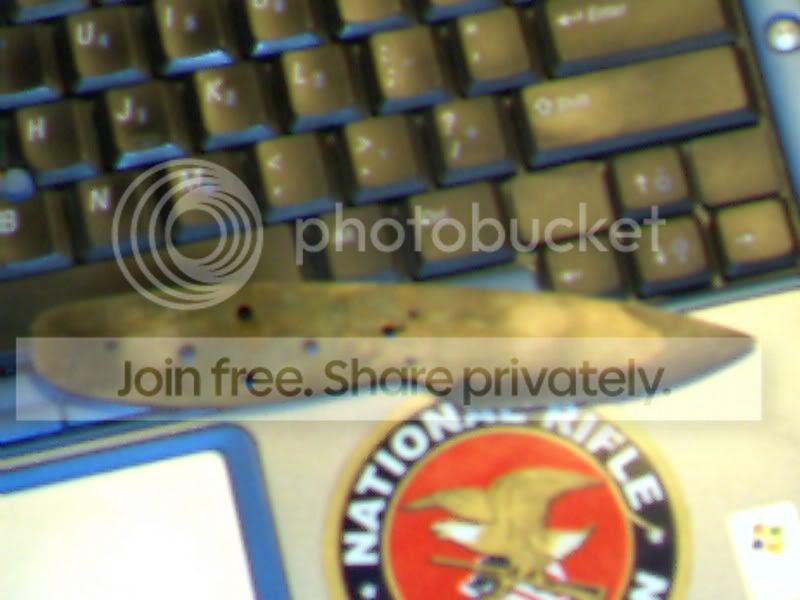

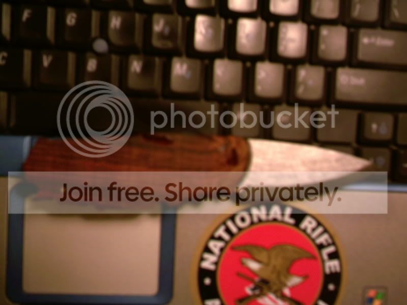

Handles epoxied on:

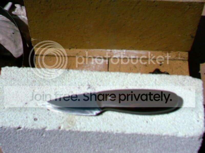

Finished: (don't know why it looks like there is a big scratch on the blade in the first pic, cause there ain't one. Blade finish isn't perfect but there ain't any scratches that big. Blade is finished to 1000 grit then steel wool.)

Great looking start! Looks very comfortable for the hand and nice overall design!
Great looking knife, Stingray. The pics will come out better if you back away a little so your camera can focus, then use the software on your computer to magnify the pictures.
Turned out great man. I'm glad to see you finished it finally. Can't wait to see what you do with the other 6" piece i sent you. One good piece of advice that Luke (swede2207) passed onto me was to make the same knife again to see how well you can duplicate it. If you are able to duplicate the knife and can hardly tell them apart or the second one turns out better then that shows a lot of skill.

Another thing I wanted to ask.
I finished the handle with Tung oil, two coats, but it still feels tacky. Will the tackyness go away on it's own? Or do I have to do something?
I followed the directions on the can of oil: put on generously then buff with a clean cloth after 5 to 10 minutes then wait 24 hours and do a second coat. Well, it's almost 24 hours after the second coat and it still feels tacky. So what's the deal?
Try letting it dry outside in the sun for half a day or a few hours. Also try going over it with some 1000 or 1500 grit. It may take a day or two for the tackyness to go away. Let us know how it goes.
In direct sun, your handle could change colors and such. I'm no expert, but I wouldn't follow that advice. No offense Jacob.
Alex
That's a nice looking skinner. Did you treat the blade? I am working on my first also, nice job. It's addicting isn't it!!
If memory serves, cocobolo is a pretty oily wood. I seem to recall Bob Flexner commenting that finishes have a hard time curing when they come in contact with the non-curing oils in the wood. Further, the remedy for this would be to flood the surface with a fast, aggressive solvent (e.g. acetone or lacquer thinner), wipe off the excess, allow the residual solvent to dry off for a minute or two, and apply a washcoat of shellac.
Of course, any method that would lock the natural oils into the wood would also lock tung oil out. However, a wiping varnish with a low gloss or satin sheen like Formby's Tung Oil Finish or Waterlox could duplicate the look of pure tung oil.
Also, that's a very good looking knife. It's very smooth and uncluttered. The scales definitely add a touch of class to what looks like a genuine, hardworking knife.
