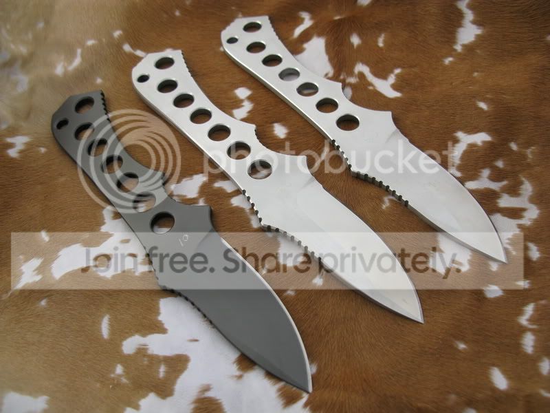

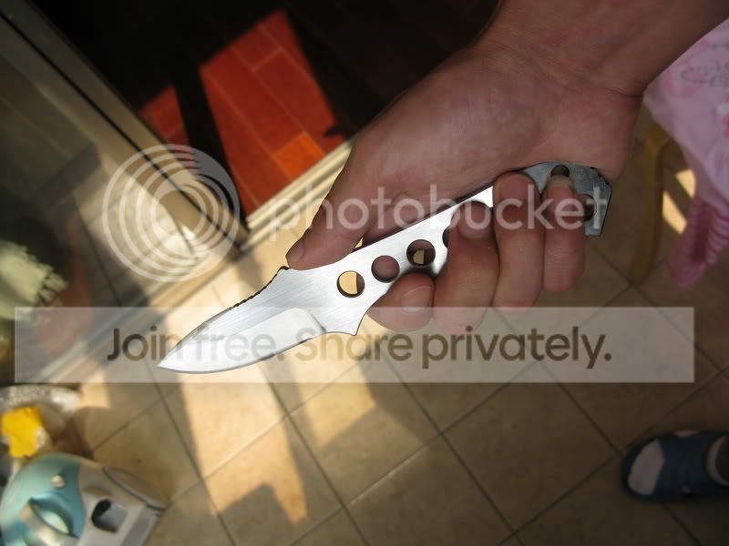

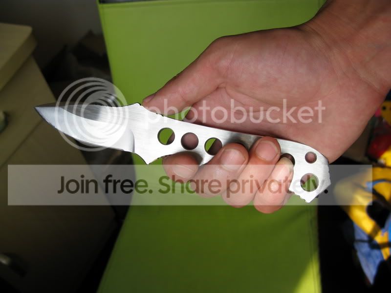

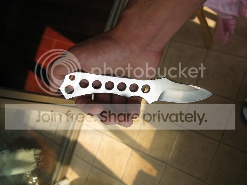

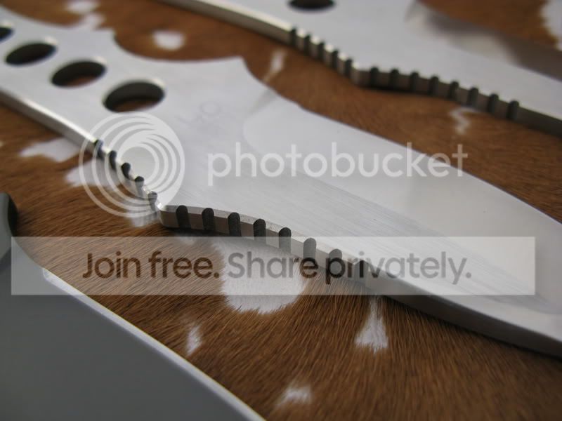

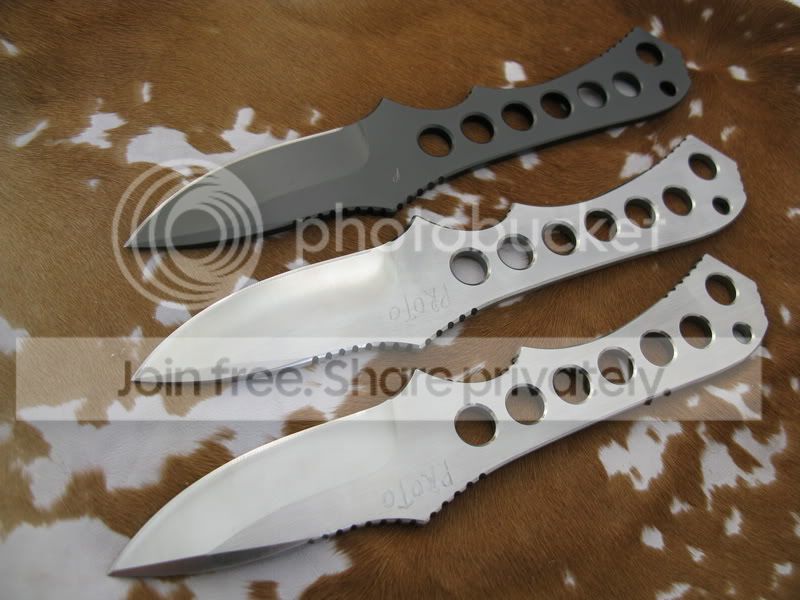

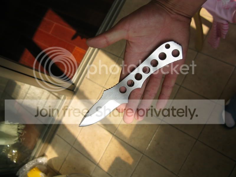

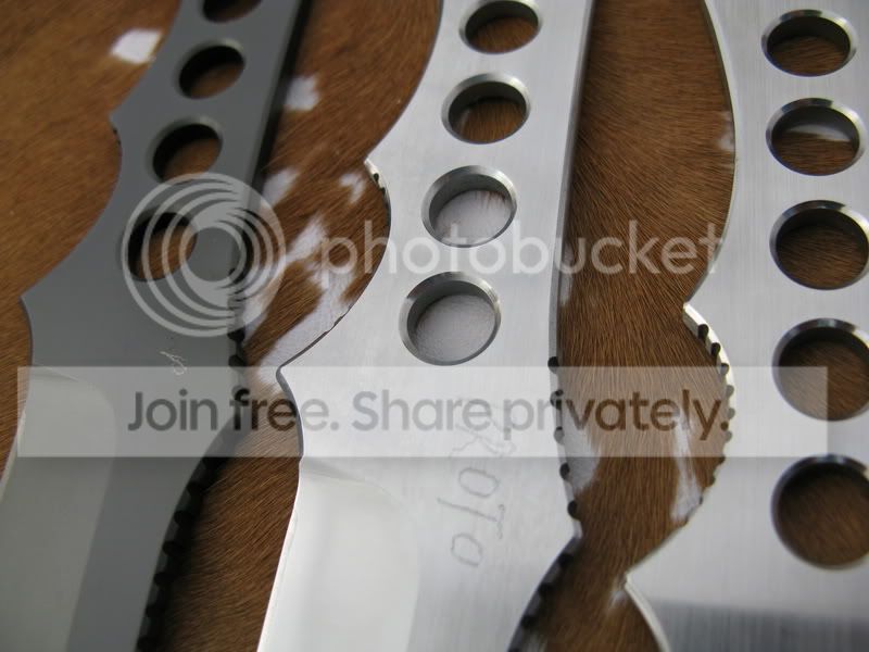

I began this about 1 years ago.In order to make a cheap full size handle EDC fixed blade.Today I'm very happy to bring this to you friends.
It's about 20cm long(8" overall), 8.5cm blade. made of 7cr18 @58HRC. thickness 4mm, weight:127g

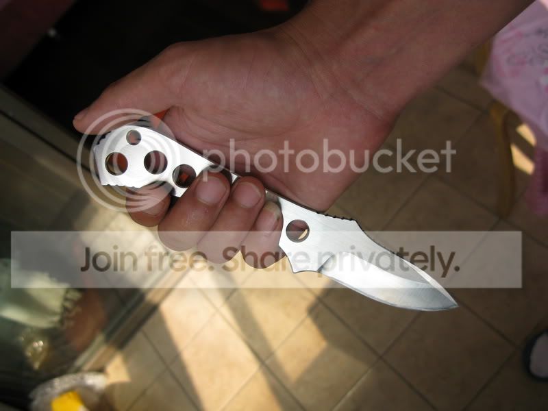

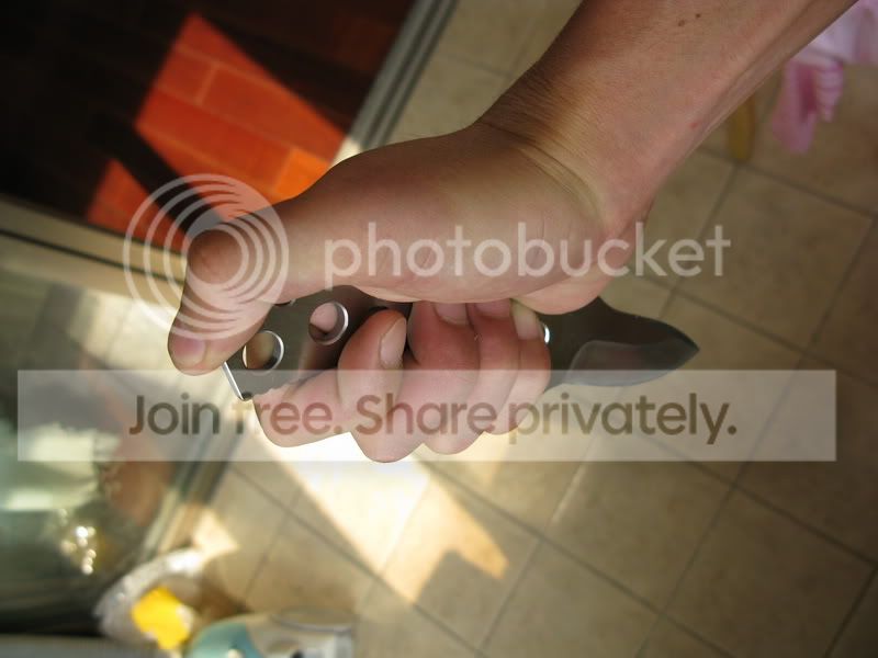

As the shape was cut,redesigned and cut, redesigned many times, it felt comfortable now .

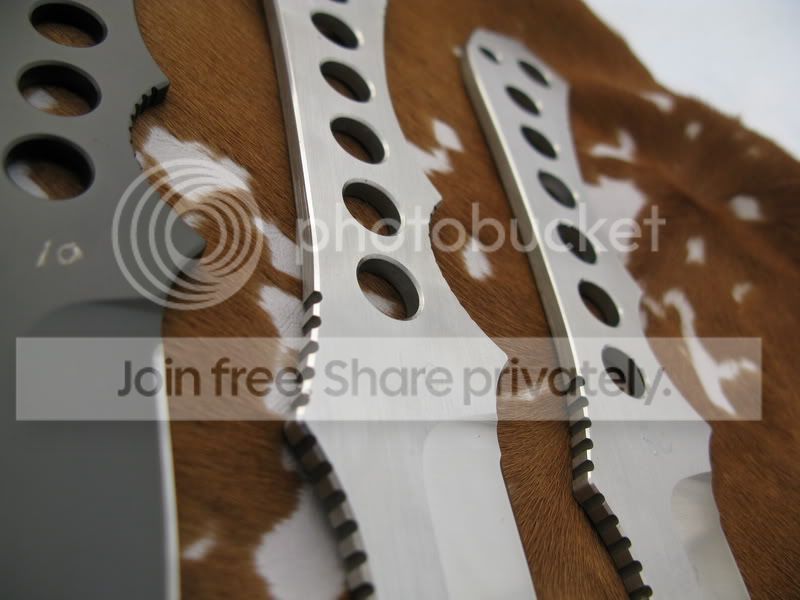

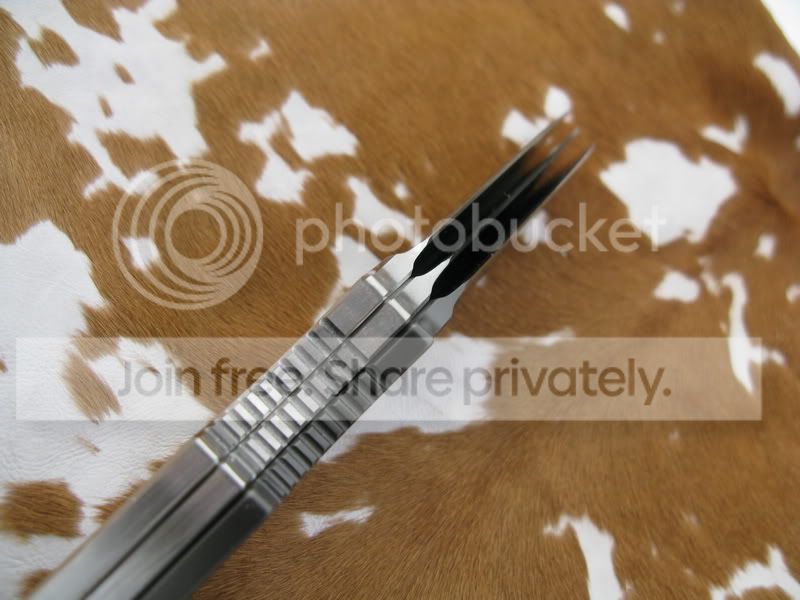

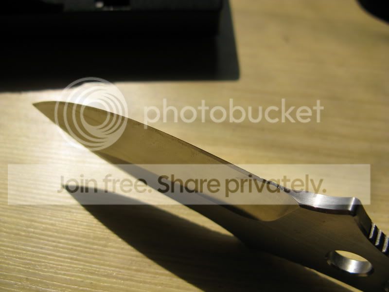

I did some test about cuting and edge retention,after cut 98 time of 1mm thick hard paper.
The last cut:
after cutting:
The spot at the end of the edge appeared when I used it to cut J.Neilson edge.
no sheath yet,under producing......

looks good, I like your work. Please show the sheath when finished. Thanks for showing us your knives.
It looks really good to me. I'd just go with a simple kydex sheath on that, perhaps even one that locks into the first hole in the grip.
Oh I like that a lot. Plans to export/sell them? Price converted to USD?
Design wise, it reminds me a lot of Crawford's neck knives.
Great design. A version with handle scales would also be pretty awesome.
I think you are filling a good niche in the knife world affordable EDC worthy fixed blades are really in demand IMO.

It feels comfortable without scales.but Scales are in my progress
