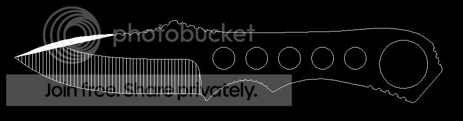

I'm so sorry,there's not much break through in this knife,it's a very simple normal and common blade.It can't be much different from others,I just want to make a useful knife,it must has handle and edge. For the shape,I draw on paper,then cut hard paper board to feel the sense in hand,then draw it in CAD with bezier,then cut it in 4mm steel sheet,feel and redraw in CAD,and so on.I'm still so sorry for no much change from other knives,maybe only some details are modified with my personal appreciation of the beauty.

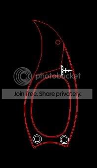

Maybe I will bring you some with more difference later,like this penguin,I name it penguin.it's my second design after my guitar.

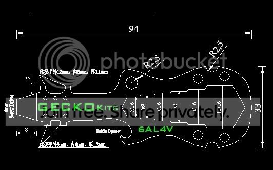

and my guitar:
At the beginning,I want to make high performance titanium Penguin,but I have some problem with shape changing while heat-treating.So this blade come early before Penguin.

That guitar looks like a great concept for a Ti keychain tool.

The penguin caught me, too. It looks QT and comfortable as a user in daily life.
And I have to say the Guitar is one of the best stuff I ve ever seen among our communities.
