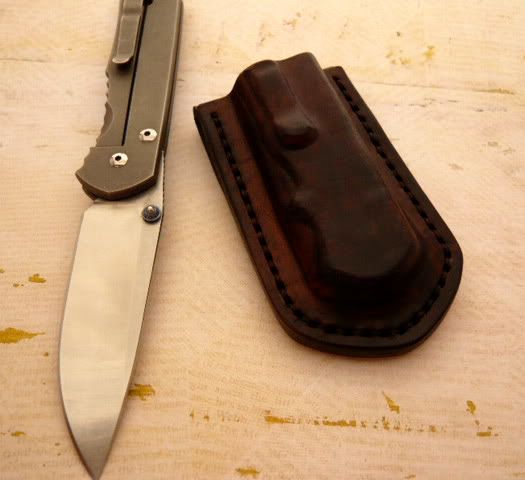

My first folder sheath...WIP photos (lots of 'em!)

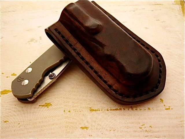

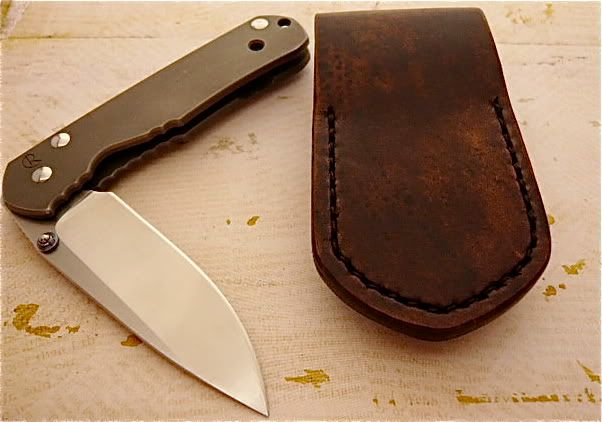

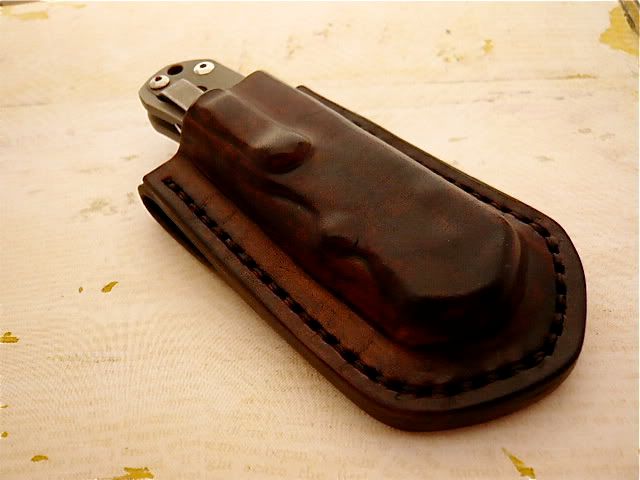

Here it is all done after top coat (Tandy Satin Sheen) and some more buffing:
The dye still looks mottled and a little iridescent after all is said and done, and it's still not my preferred look, but it doesn't look bad I suppose. It was a fun experiment and the next one should turn out better now that I have a feel for it.
rayban, I wore this sheath on my belt this afternoon, and it is really too tight as is. I'm sure it will loosen up with some use, but I'd be surprised if it became too loose. The knife snaps smartly in place when inserted, and pulls my pants up to my armpits when removing it.
Nice, one thing you can do is to just form with your fingers around
and over the clip portion, doesn't need to be too sharply defined
plus it will help not to compress the finish of the leather in that area too.
