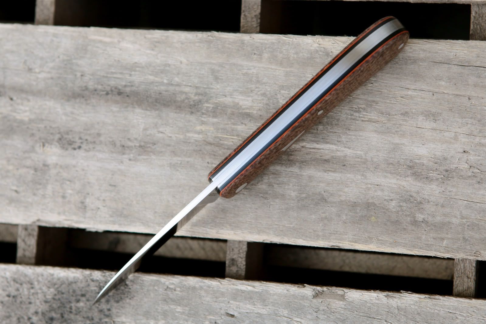

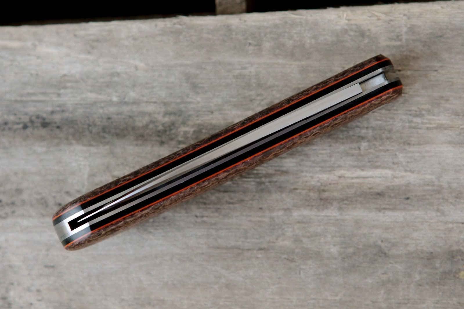

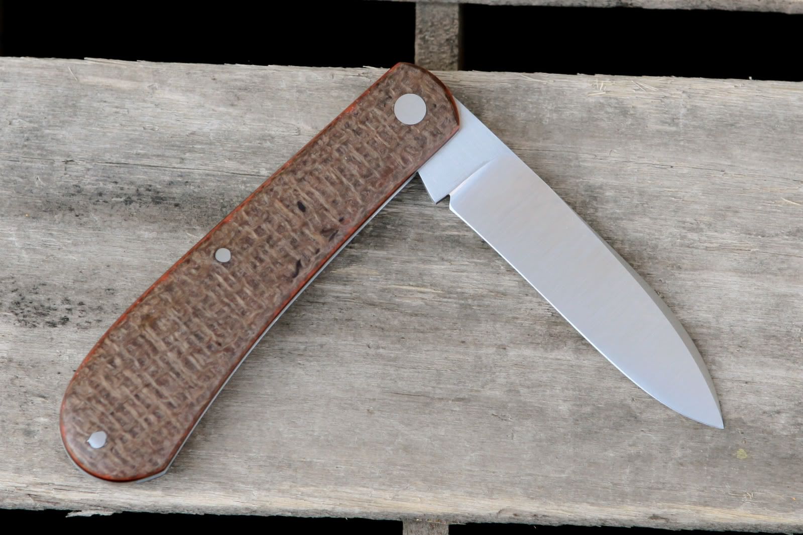

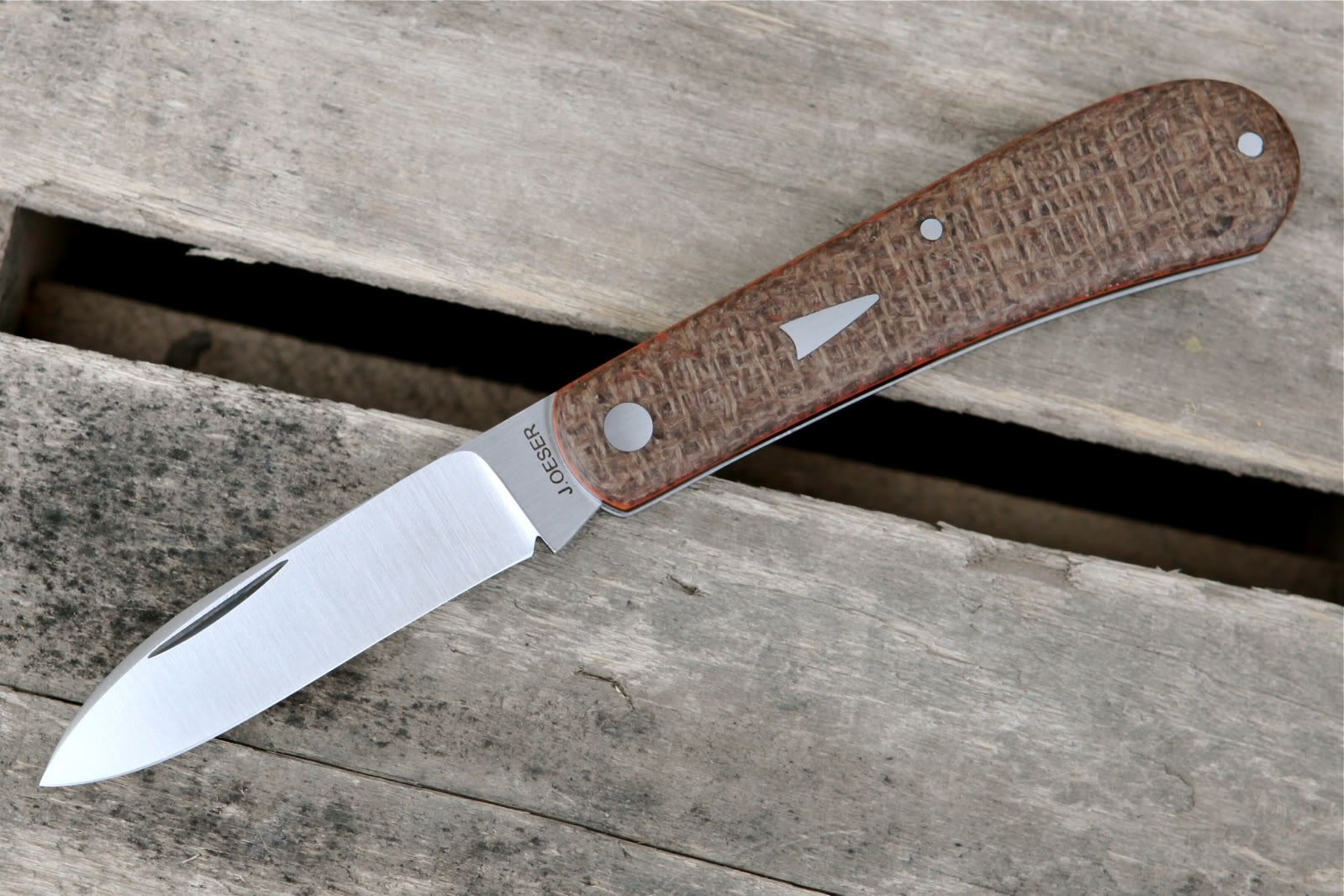

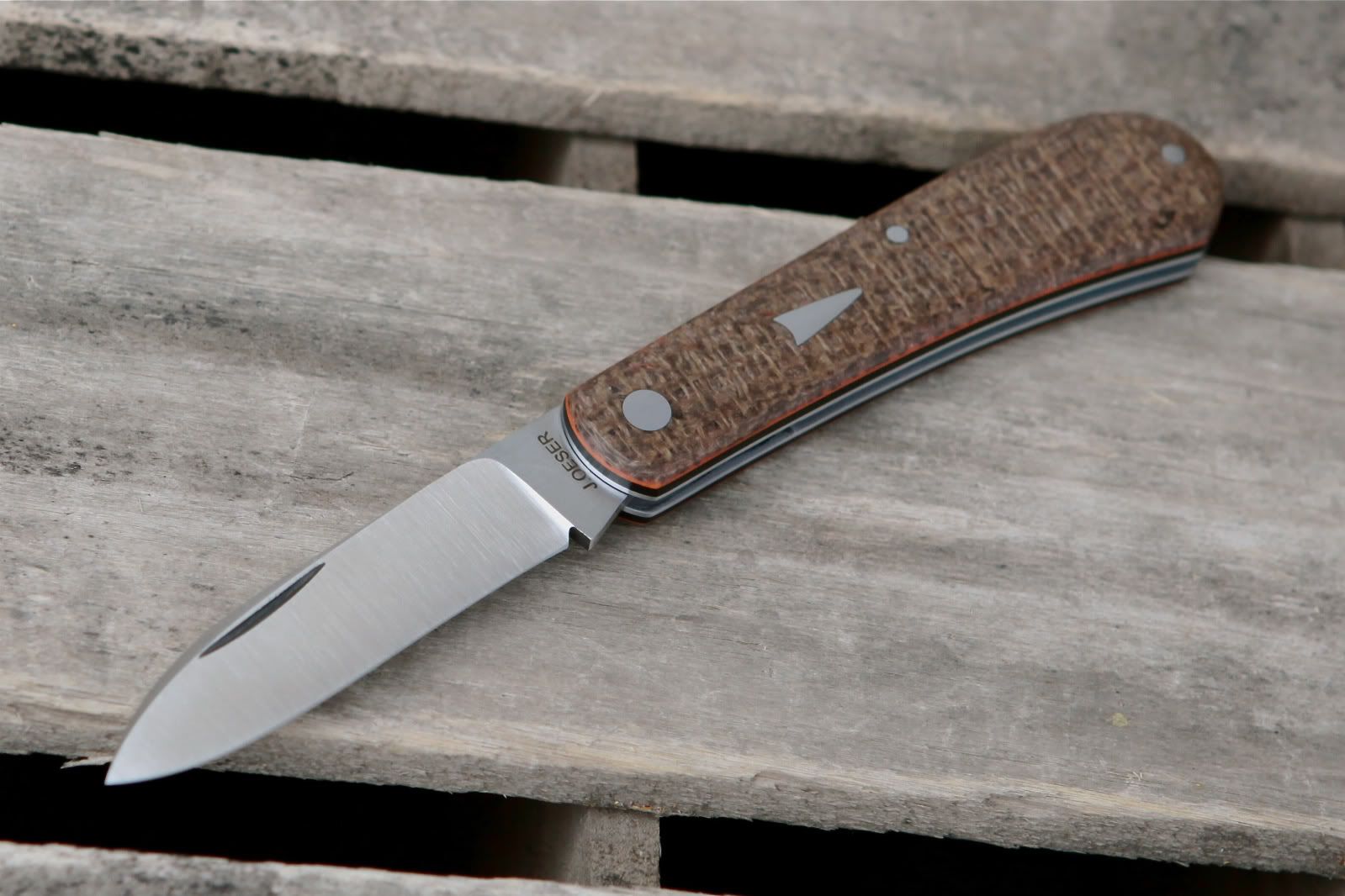

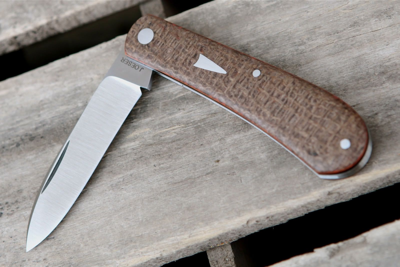

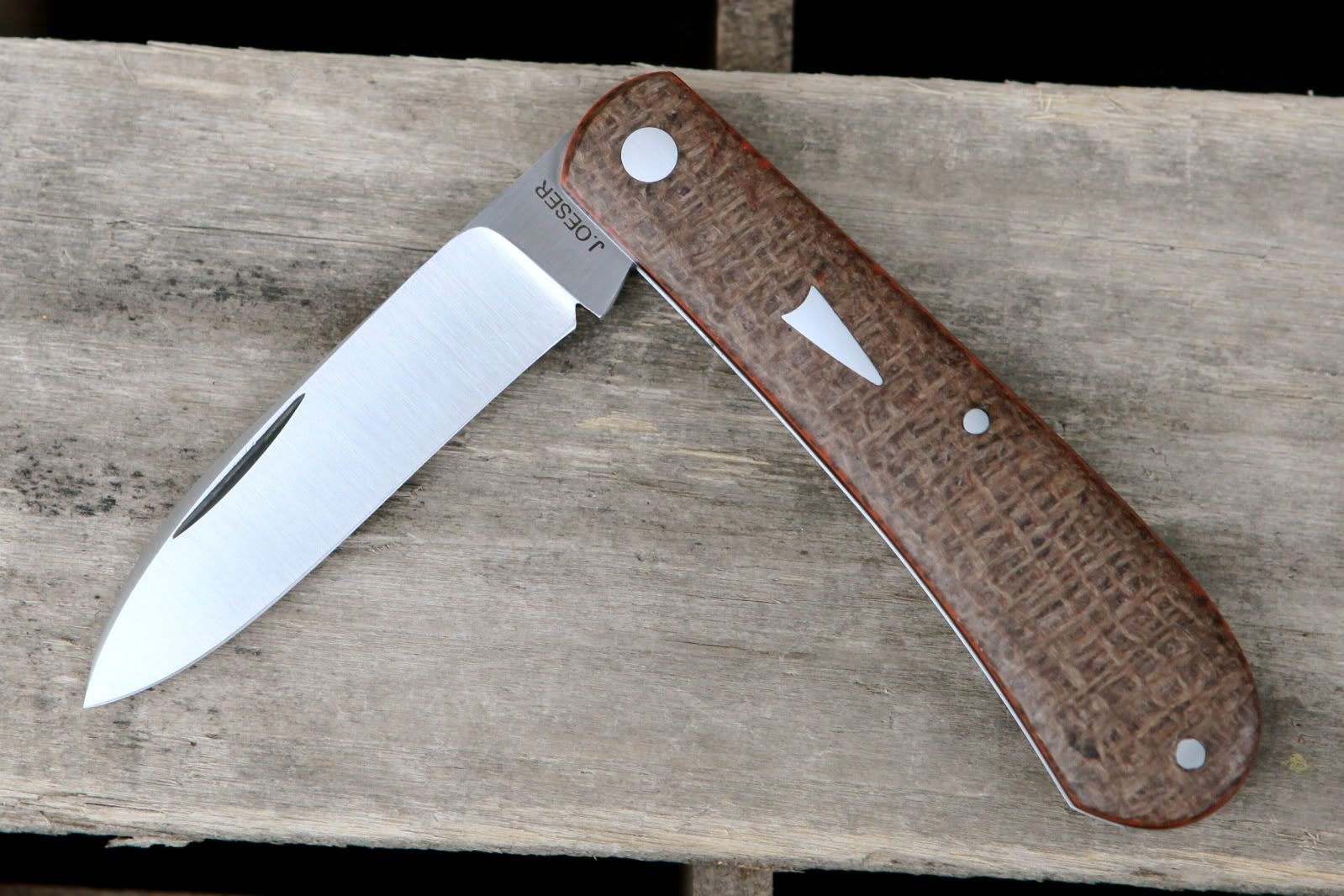

Well, I guess I am finally crazy enough to try doing one of these. I am a huge slipjoint lover. They take me back to watching my grandfather pull one out of his pocket to do just about everything. I have greatly admired the work done by Bret Dowell, Rick Menefee, Ken Erickson, Kerry Hampton, and of course Tony and Reese Bose, just to name a few. When I started out I asked Bret for a pattern and he graciously obliged by sending me a Tony Bose Zulu pattern that he had just picked up from Mr. Bose's shop. This has been my favorite pattern since I first purchase a Case/Bose Tribal Spear. So naturally I had to make this first.
I made quite a few mistakes on this one. I was just happy to get the blade resonably centered. I need practice on my peening too. In fact, I messed up so bad the first time I had to take it apart and try again.
I now have even more respect for the folks that make these on a regular basis. They make fixed blades like I have been making seem like a walk in the park. This was a major learning experience and certainly won't be the last.
Here are the specs:
Blade/spring Steel- CPM 154CM
Blade thickness- .103"
Closed Length- 4 1/8"
Handles- Shadetree Natural Burlap over orange and black G-10 with arrow head sheild.
Any comments or suggestions are welcome. Please be gentle and keep in mind this is my first.

Is the pivot pin that big? Or is there a smaller pin going through a bigger piece that is only on the scales (like on some sodbusters)?
What did you use for the nail nick?
Bruce
Thanks everyone!
Bruce, yes it's a smaller pin in a larger one. I did the nail nick using a 5" 60ish grit wheel dressed to a 45 degree angle.
