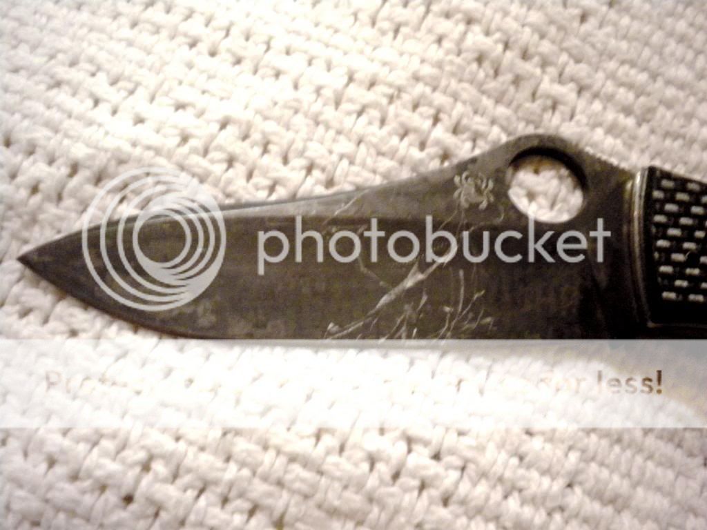

I did a patterned patina on my Woytaz Tanto:
Almost looks etched. That's a mix of mustard and hot sauce.
