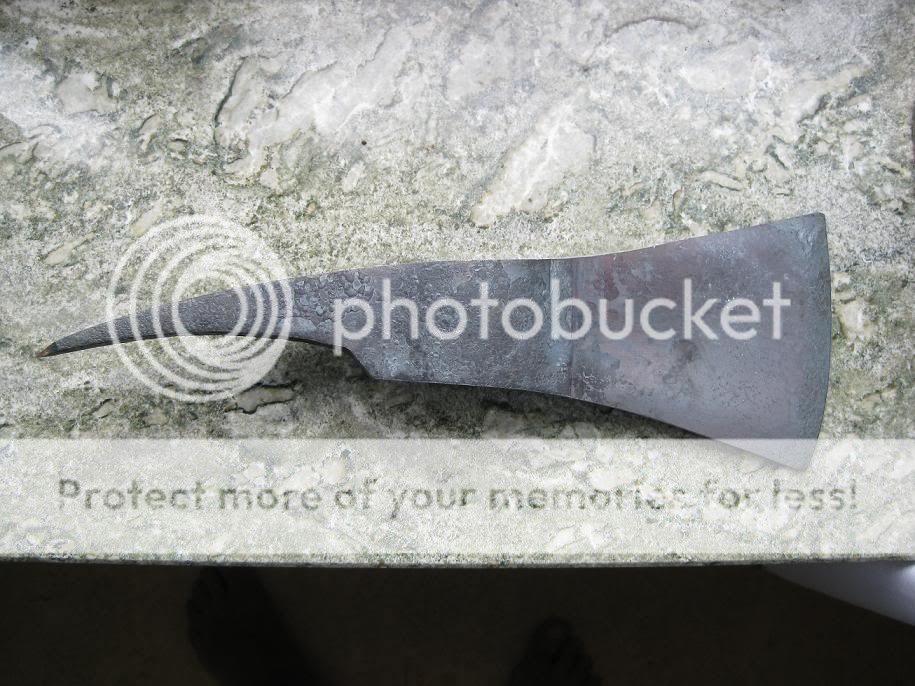

Hey!
Today i try to forge a hawk and it look like this :barf::D
how much shall a hawk weigth ? and how long and more .
I think it more look like a fireman´s axe :D

For some reason I get the feeling like seeing the top of the head would help to tell if its "hawk-ish". I can't tell how the head is shaped, even if i could i'm no expert, it looks good on this side :D

a good hawk weighs one ounce per inch of length.
length isn't as important as this ratio, but 24 inches for a 24 ounce hawk is an awesome thing to wield.
more or less weight is getting away from what a tomahawk is (to me) and going towards an axe, or more of a specialty weapon.
i like the head, brother - good job.

I like the shape...She looks pretty sweet.........
lets see some photos when you get done....
The angles and proportions on that head are just right for a spike hawk! Nicely done,

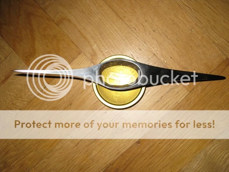

Hey!!
Here are a profile pics on the Hawk

Cegga I think a good design is a small rather than big...I talked to an axe man this weekend and he said the smaller the hawk the faster it is...so maybe 6/7/8 inch accross not too heavy (but good enough for chopping) and 12-16 inch handle length....but I am not an expert...

The spec are lenght are 270 mm edge are 90 mm and it´s weigth 0,7 kg
