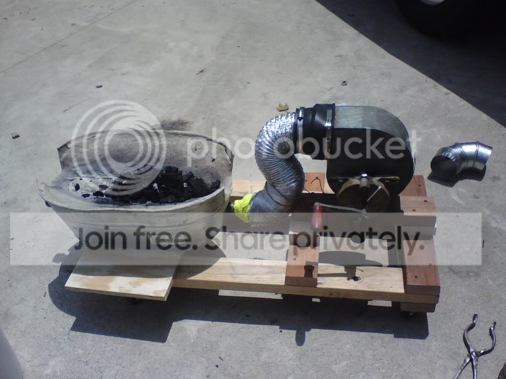

I think you should have mounted your anvils on a big hunk of wood. That concrete only makes them a b!#@h to move. Weld on a couple of tabs and use a couple of heavy lag screws and viola, easy anvil. This is how I mounted mine.
As for the forge, I think you need a better blower than a hair dryer. Just doesn't have the "umph" you really need. If you can find an old gas furnace, one that no longer works, you can pull an almost ready made blower from that. Not the big fan that moves air through the home, but the smaller blower that forces air into the combustion chamber. Llike this. To control it, all you need is wire in a simple dimmer switch.
Put it all together and it will look like this.
One last thing. If you can come up with a way to create a cover, same shape and size, like a clamshell, with a round opening on one end and you'll have a much more effecient forge.

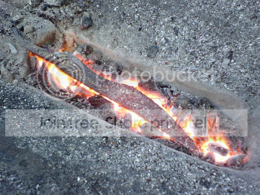

I made one a while back, I love it. I have improved it a bit since these pics.
RR Track anvil on the left

If you don't want to use all the tuyere length you can block some of the holes with wet ash then pop the holes open if you need the full forge length.
You can take chunk wood and put it around the top of your fire and it will char and then you can rake it into the fire... kinda like coking green coal while working a coal forge.

Not a whole log but chunks and bits like you'd use to make charcoal. Put it in a ring around the top of the your fire.
First, learn to keep a fire... it's actually a little more complicated than whoosh fire forge, not much but where to put the steel, how to keep it running right and all that, then move on to charring wood as you forge.
When you can find one ( watch ebay) get a hand crank blower.
First - They are designed to deliver air to a forge, most small blowers and fan motors aren't.
Second - You only are supplying the blast when you need it, at the amount of air you need. This will save a lot of coal/charcoal over having the forge blower running all the time.
Third - Cranking a blower is just way cool!
As to Will's post about the wood - Cut your wood into small blocks and chunks. From about walnut size to fist size. Set a ring of that wood around the fire, and as it chars down, rake some in as fresh fuel. You want to be forging on burning coals, not a fire.
