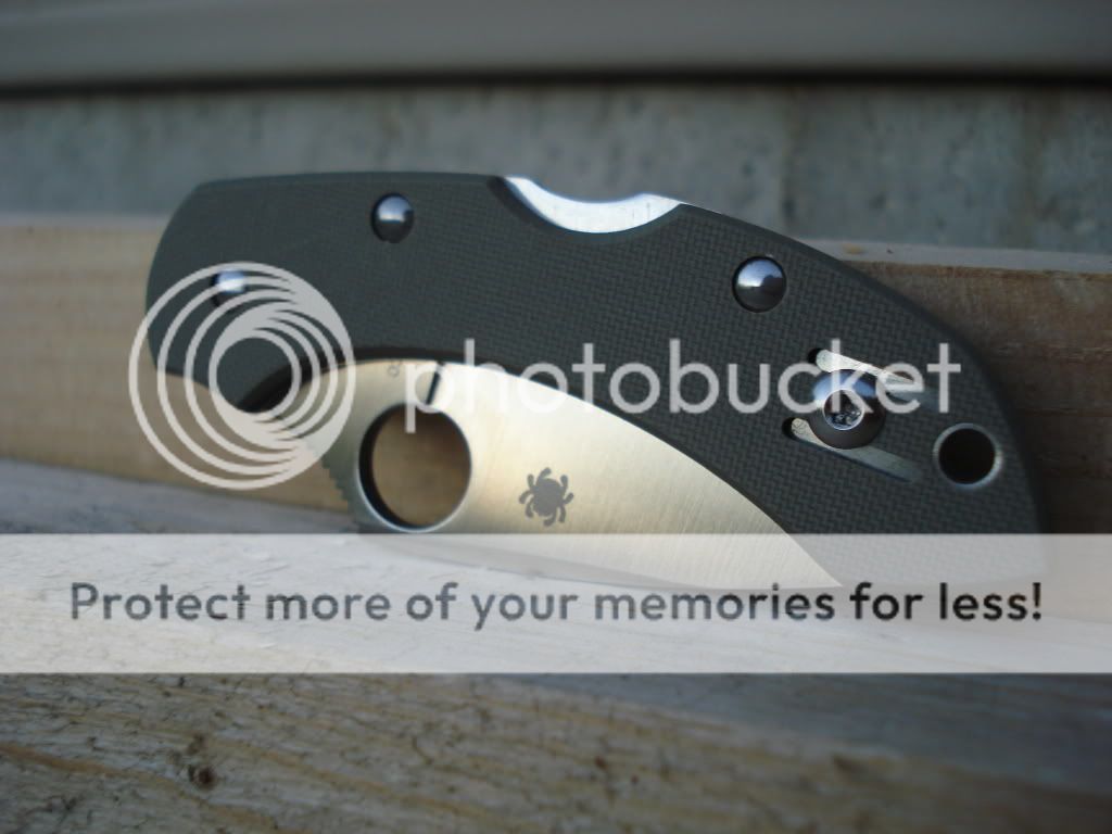

Awhile back I purchased a ZDP-189 Dragonfly 2 and I have thoroughly enjoyed it. It's light weight and thin, full-flat ground blade make it a dream to carry and use. ZDP-189 is good stuff :thumbup:. I'm not a big fan of FRN, especially in comparison to G10, so I thought, heck, why not swap handles with the G10 version? Warranty? We don't need no stinkin' warranty! :D
Taking the blade out was no problem, but reassembling the G10 variant is far more difficult than the FRN version. The G10 Dragonfly has separate liners, handle scales, and backspacer as opposed to the solid one piece construction of the FRN version. But it all came together in the end. The look and feel, IMO, is fantastic.
Very nice. I put one of these together too. The thickness of the G10 makes the knife much easier to open and close with one hand.

That's a killer combo. As much as I like FRN G-10 can't be beat for traction. Also as of lately ZDP-189 has grown on me a great deal and is slowly becoming my favorite spydie steel. All in all Spyderco needs to take note of this configuration IMO.
