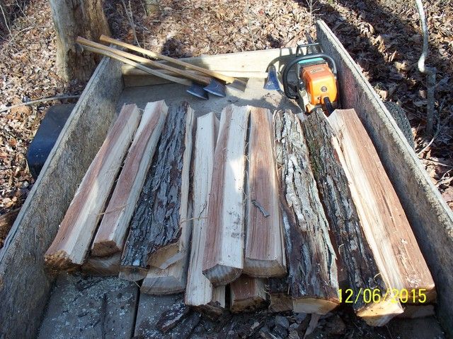

I just got don't quartering this log up. I'll probably try to go get some more logs out of the woods tomorrow. It's been bitter cold today and too windy to fell.
Also, I read somewhere that the heartwood wasn't used in handles so I split it out of the good material. Am I right to do it that way?
Really good advice has already been given! The only thing I would add, if I didn't miss it is I would leave the bark on the staves for a few months to slow the drying rate as much as possible in the early stages. After the staves lose the bulk of their moisture the bark can be removed to speed the drying up a little.
You may experiment with a couple of staves by putting them in an attic in late spring,or early summer after quite a bit of the moisture has been lost. The hickory should be plenty dry enough for a handle by next winter if you were able to do that.
Here are the staves I split out a few years ago. As you can see, I removed the heartwood from the staves before I hauled them out.

I may try to source some dry wood local and make a few handles. Or I may even know where a kiln is if you guys think I could dry a few that way. Here is what I have so far
http://imgur.com/a/YcD846p
Those are about 2"x6" pieces and the heart woods is up at the top of the photo. The length of them is 45 inches
I suspect that is white glue I see there to seal the ends? It's my standard operating procedure but I get a lot more debris stuck to the ends.
How does watering work for this hickory I wonder? Has anyone experience? With ash I am pleased with the result but wood species not being equal some don't take to watering at all, holly, which otherwise is a great handle wood, for example will just explode.
