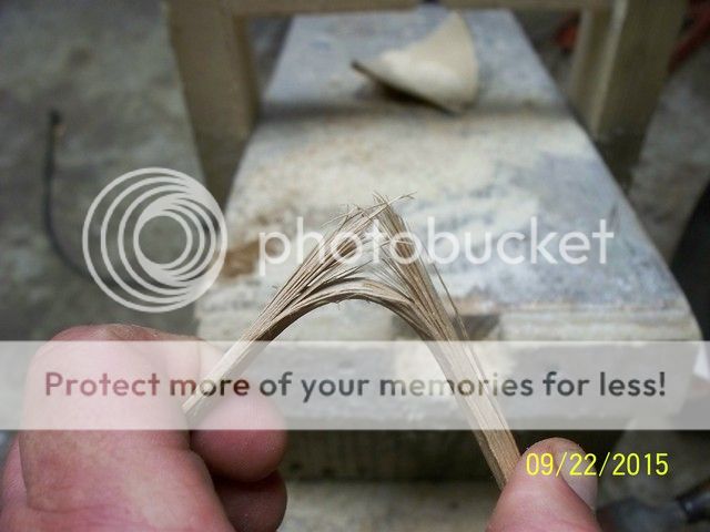

I can't say because I'm not there, but I'd say it looks like ash.
That was my original feeling, its hard to say why, im going to post some more pics that might help. The color is definitely a little lighter than many of the hickory handles ive bought.
Try breaking a sliver of the wood, hickory does this, ash don't.
Im gonna run out to my shop and try this. Is ash likely to just snap clean?
Ash won't have the fine feathering like this hickory sliver, it will basically snap.

I snapped a sliver from an old hickory handle that broke and compared it with the scraps from making this handle. They behave diffrently, but are pretty similar, the hickory slivers were more springy and bent a little more before breaking.
I could be wrong but man that resembles ash...
