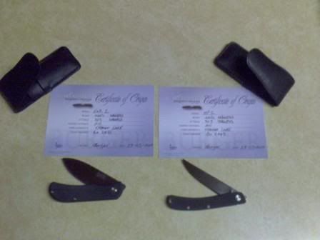

Opened up the envelope and immediately took out the knives, one for my father and the other for myself…..looked back into the envelope and behold…another envelope containing certificates of origin…what a nice touch!

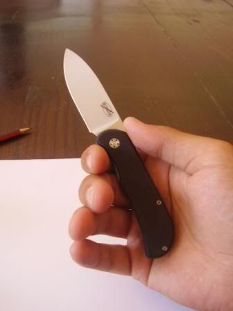

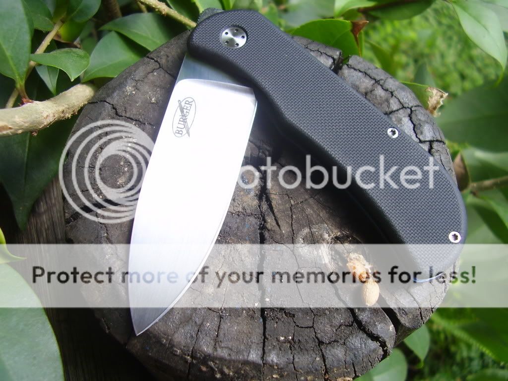

My knife (EXK1) is the one on the left and my father’s one (HP1) is the one on the right.
Statistics on my knife:
Blade: 440c
Overall length: 6.5 inches (162mm)
Handles: G10

1. This knife is light!
2. Opening with Lip is easy and very smooth.
3. Fits the hand nicely.
4. The fit and finish is excellent.
5. It rides easy in the pocket.
6. It’s small but efficient and I love knives with blade length close to 3 inch.

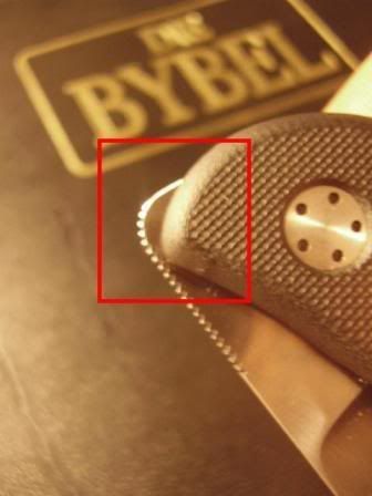

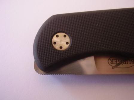

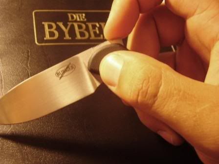

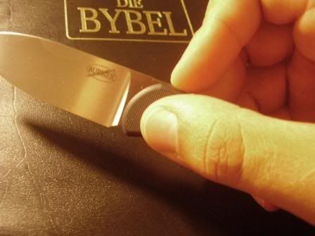

The Lip: Ambidextrous ( Right and left handed opening)

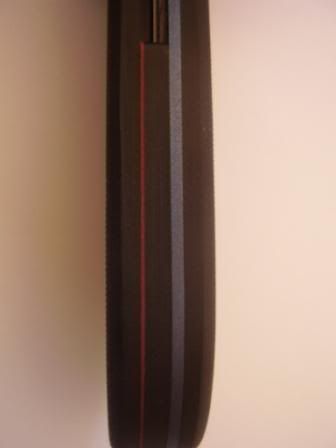

Detail: Red line between spacer and g10, coloured titanium liner.

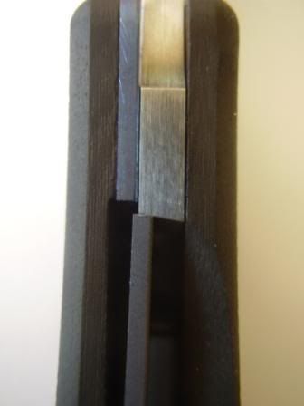

The Lock:
Lockup is solid with no side to side or up and down blade play. The liner lock’s up solidly and really has a nice click to it. (I am not big on liners but am truly impressed by the lockup) The liner has broken in a bit more but lockup is still solid with no problems.
The liner is hidden somewhat when you hold the knife so that you cannot disengage it by accident. One side of the g10 has a small cut-out on the inside of the g10 for your thumb to disengage the liner.

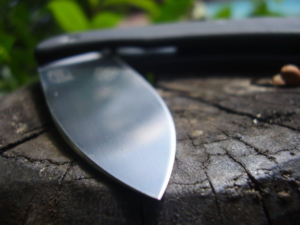

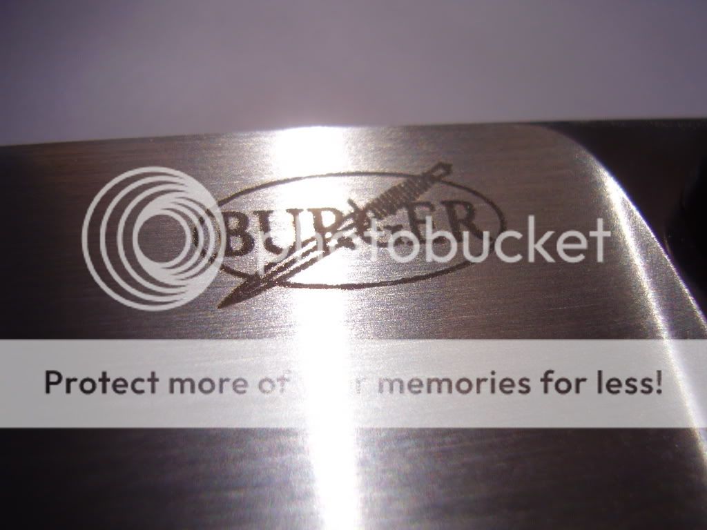

The blade:
Drop point fully flat ground blade….both styles that I love. Really a nice slicer and very sharp!!!
The blade is very thin at the edge but at the spine of the blade it is thicker that my Delica4.
Ergonomics:

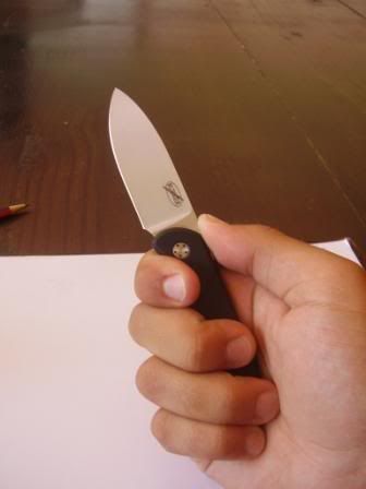

Because the knife is so light it really feels nice in the hand. The handle is a bit shorter than the D4, but the blade is longer, because of the smaller distance between the pivot and the nearest part of the cutting edge. (Does that make sense?)
The knife fits my hand like my swiss climber that has been with me for 17years.(Love those swiss)

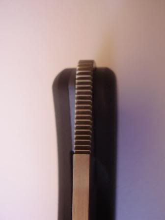

The jimping on the spine of the blade holds your thumb securely in place.

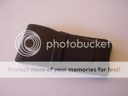

A great knife that is really light. Great to edc and is comfortable in the hand. It is really a pleasure to own something that has been made by hand. The leather pouch is so nice and really protects the knife from dust and debris. I really love this knife and will buy myself another one in December when we go visit Burger again.

Looks like a very well made knife, love the grind
nice shot of the blade there too...

I just have one question. I am not a big fan of liners, most of my liner locks have blade play, have you experienced this at all with your burger?
What is the "ambidextrous lip" that you mentioned? I noticed there isn't any visible way to open the knife with one hand unless you flick it open with your wrist.
Great looking knife by the way :thumbup:.
batosai117

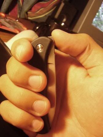

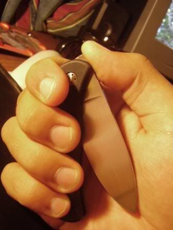

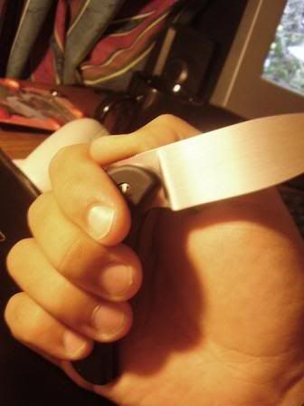

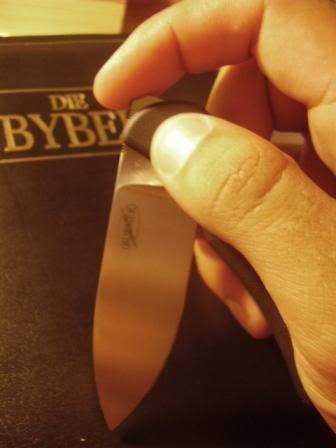

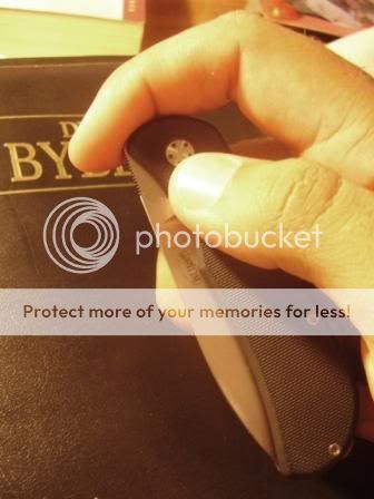

Here are a sequence of photos I took to show how the lip works. My friend is a lefty and he has no problems opening the blade.
