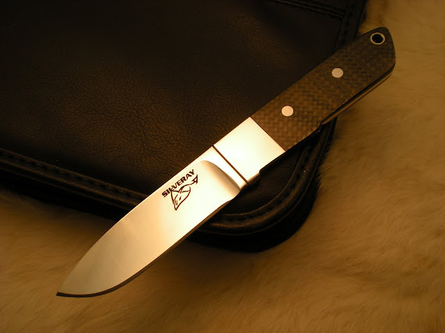

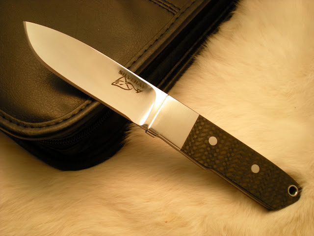

This is the first time I have tried an integral knife. Let me know what you think!
overall length: 7 1/4"
blade length: 3 1/4"
I kept this one thin in the handle for a slim and concielable profile.
This is out of 1/4" 440c stainless heat treated and cryo traeted to 59-61 rc
handles are fine weave carbon fiber with stainless pins and ss lanyard tube with a taperd tang!
She is $125 delivered to the CONUS and comes with a kydex sheath. I accept paypal or usps money orders and all international shipping will be extra!
All your comments are welcome.
Jason
Looks great. I love the step work you did along the bottom hilt area/finger line. Really makes it stand out and "talk". Very sweet and clean.
Gibby
Thats a cool knife. I particuarly like the stepped handle and the hollow grind that goes all the way to the spine. again, again
Very clean and classy looking. I love the thinner profile and the all around attention to detail. Great work.
