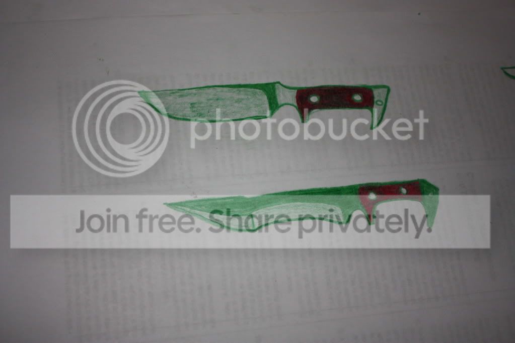

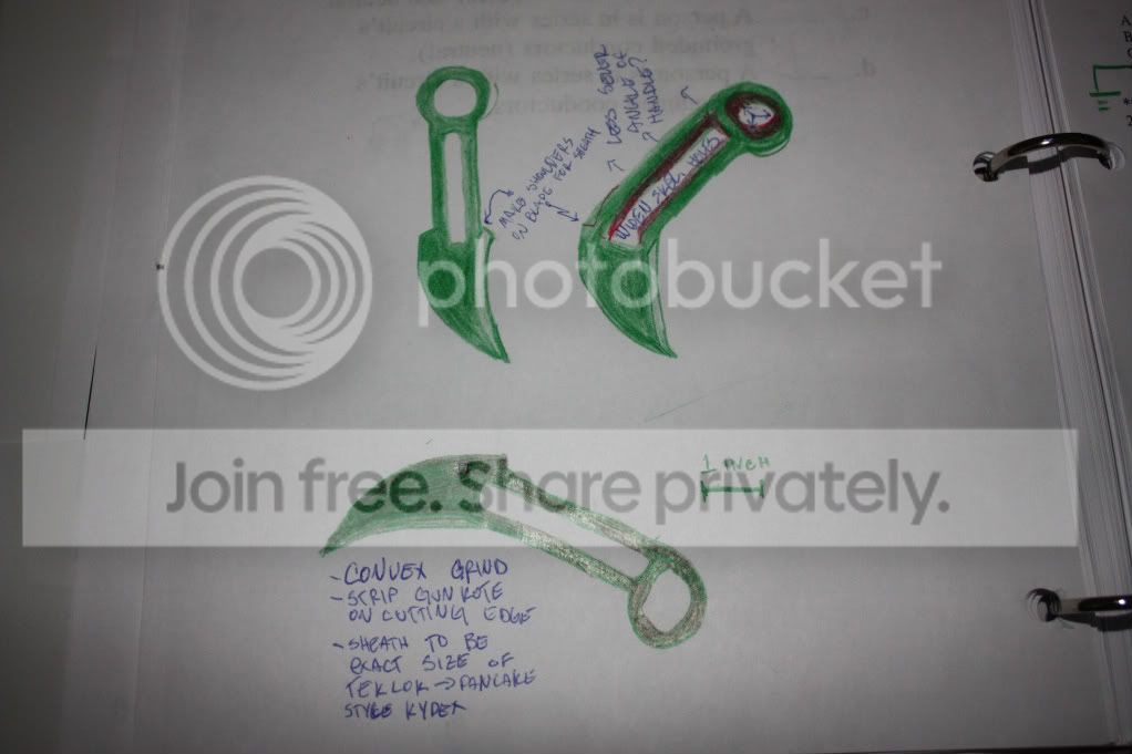

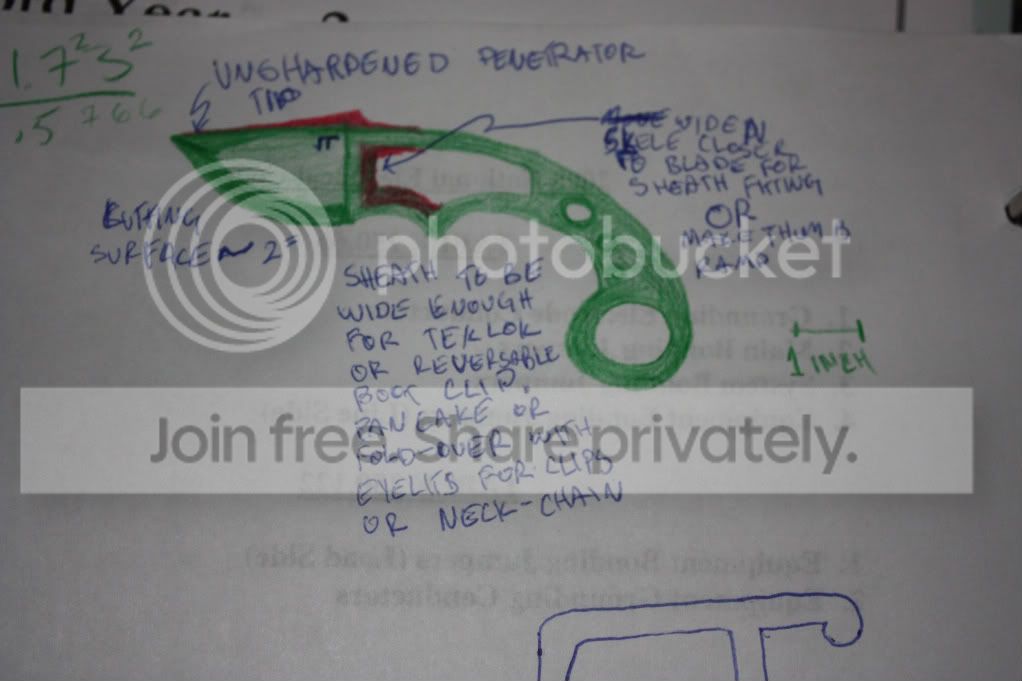

I'm looking for some criticism on my knife designs. I.e. problems with cutting/grinding these shapes, recommended steel for these applications, etc.
I'm considering purchasing some scrap metal from a local saw blade manufacturer. Does anyone have any experience buying metal from these type of businesses? Do they usually reforge their scrap and recycle it for more product?
First necker.
Second necker
A Camp style knife and a sabre ground fighter. One of these will be my "first" and will be my safe queen.

First, It is good to draw the knife out and see how it looks. making cardboard cutouts and seeing how they feel in the hand is the next step. Asking for the critique of others is also a sign of a serious craftsman.
All that said, not one of those does a thing for me. They look impractical to make or use, and seem like they would be very uncomfortable in the hand. There are other issues, but they just don't appeal to me. Other folks may like them, and if they appeal to you, by all means make them. But since you asked, I answered honestly.
Not to discourage you at all, but those are some pretty complicated designs for your first knives. You're going to have trouble with the grinds and some of the profiling. I would suggest starting with something a little simpler in profile with fewer curves and tight spots and a more practical blade shape. This will let you get a feel for grinding and handle the basics.
I would also have to echo Stacy's thoughts on the practicality of them. Not really good designs if you intend to use them.
But all our tastes are different and if you're set on making them, I say go for it. Don't be afraid to make mistakes because that's how we learn.

IMO these border on the fantasy knife world.If thats what you want to make that is fine,but they are not practical for use.As said most will be a pain to rofile and grind.
Make a few simple knives so you get the feel of removing metal and getting thing to fit and then do what you desire.

3. Not sure why you'd need a penetrator tip, but unhardened steel is nowhere near as strong as properly tempered hardened steel.
4. You might find that the compound grind you've got on the big knife is trickier to grind than it seems... might be better off saving that one for a future project.

I agree go for something less complected at first. If you intended to make a kerabit you would be a lot better off training under someone who understands them prior to making them. I think Steve Tarani is still based in California he would be a great place to start.

I like your designs because I like seeing where knife making can go. Nice orginal stuff. My only comment is on the first three I like to have something between my finger and the sharp edge, a little slip could be painfull.

Each of the knives in the first photo look dangerous. And not the "holy crap, that's totally awesome" kinda dangerous. The "you will cut your hand off if you try to use it" dangerous.
