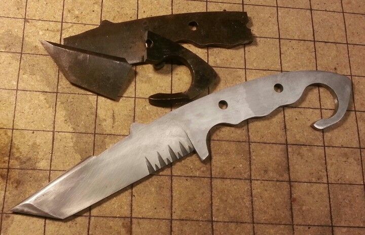

What, angles like this?
(BTW this is a rough 320 grit quick wipe down after HT... not even near what I would consider finished. However, flip it over, turn it around, everything is spot on.... Feel free to see my WIP thread to read yourself in... :)And in the background is one of two sacrificed blades for destructive testing. I even tested the blade in a -25f cold environment as it will live in Colorado once the new owner gets it. Just didn't want anyone to think that was a screw up that got hucked in the wood chipper...)
Yeah, no offense, but trust me, don't even think about it until you have a few knives under your belt. And if you think you are gonna cut it on a mill, what about the cleanup of the lines? That's what separates the men from the boys... Oh, and there is about 500+ hours of r&d in that blade you see above. Notice it is angular in the blade, and curved in the handle... Straight handles just don't work. Look at your hands, see any straight lines and fixed angles in there? It will be hot spot city. And blades don't need to be "stealthy." They are by nature small and easily concealable and frequently do not have much of a radar cross-section... ;)
