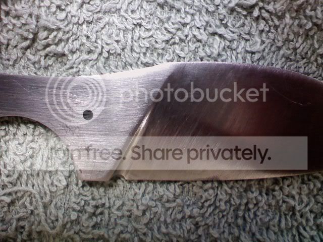

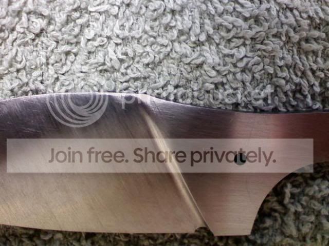

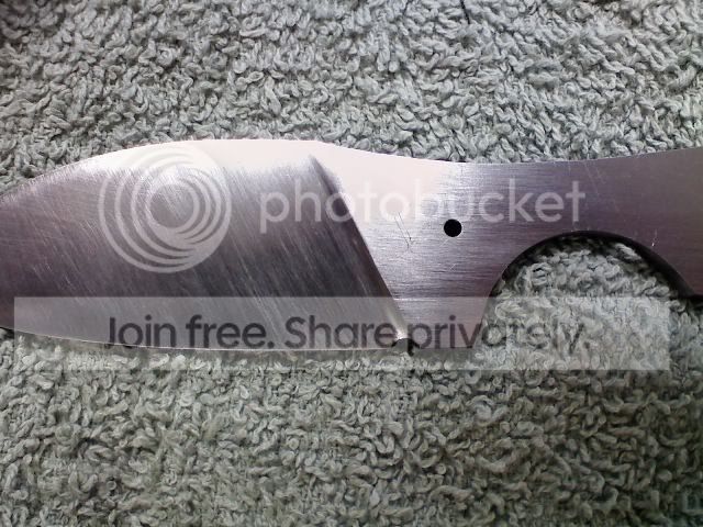

Here's some crappy progress pics. Ignore the flats and the tang. I blended the transition from the flats to the spine. It's not perfect; in fact, I would call it mediocre. I'm trying not to let it bother me too much; after all, I'm correcting mistakes on my first knife.
Anyway, I chased my plunge cuts with a chainsaw file, and am almost finished making the plunge cut and the blade grind even. Once that's done, it's time to work on getting the deeper scratches out, and getting the knife to the finish I want before sending it off for heat treating. Oh, I'll also be reducing some weight from the tang.

I use a block of plastic with leather glued on the bottom and then sandpaper wrapped over that to handsand. You don't want to skip grits and changing direction between each grit helps a lot to see the previous deeper scratches so you can be sure they're all out. For the final finish try to get all the scratches going in one straight direction. Never worked with D2 but, yes, hand sanding sucks. Keep at it, man!
