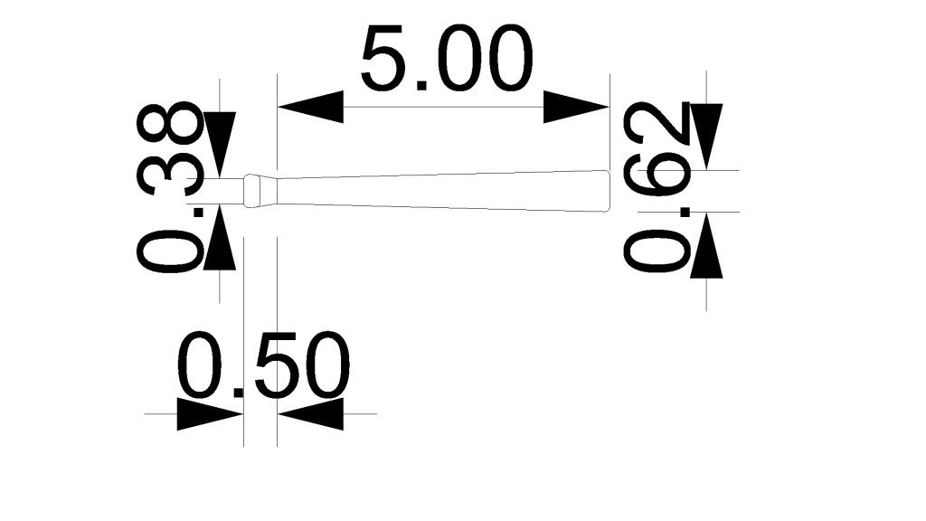

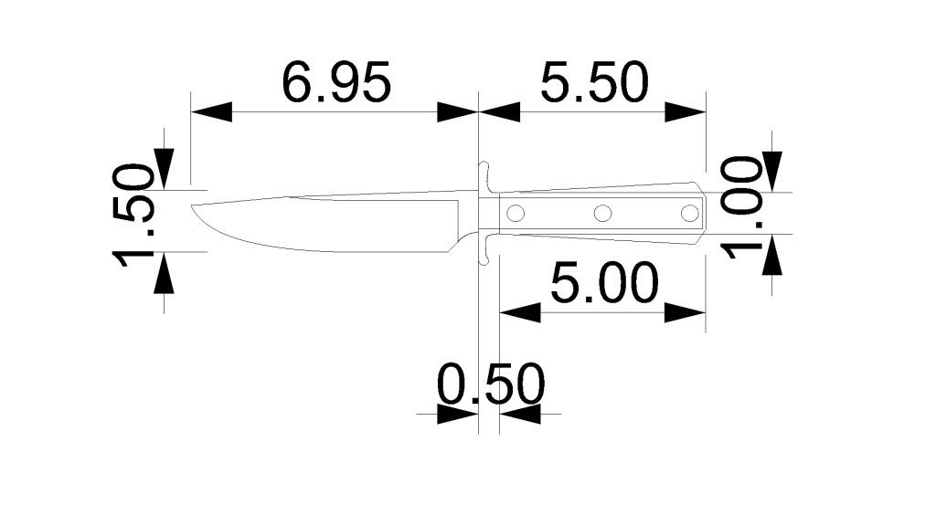

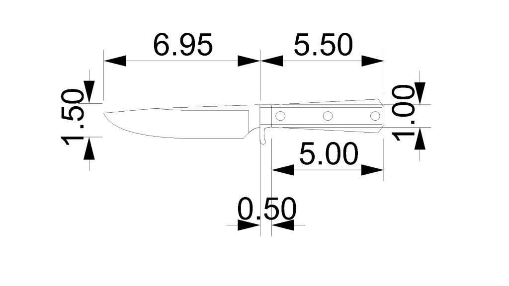

So here are the dimensional drawings for the next one, any comments or suggestions welcome
profile
Handle shape top view
dimensions will be rounded to the nearest common fractional inch
Aesthetics are subjective.... so of course any thoughts I may have are my opinion and we know what those are worth ;)
But since you asked! :)
I think it's a cool start, but with a few small changes could be a REALLY cool knife!
It could flow smoother in the handle/guard/blade transition. The lines don't quite flow together... and I say that because my eye stops at that transition.
I think if you just altered the choil/ricasso area a bit, and made the guard thinner and with a smoother radius it would make all the difference in the world.

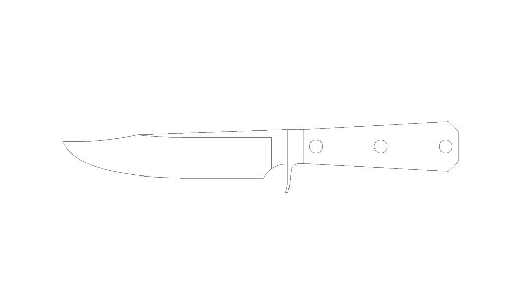

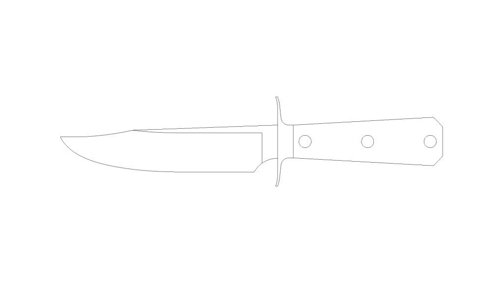

Ok here are a couple of revs based on what I understood from NickWheeler
and while I was at it, I tried this one, where I dropped the spine to be level with the top od the handle and chopped off the upper guard.
I know things are not symetrical in the edited pics I just worked them free hand in photoshop. I am not sure what to call this, but its inspiered by the coffin handled Bowies I have seen and I put a mild clip on the point although its not too noticable
Now see, to me, that makes a HUGE difference in the overall flow of the knife.
It is probably just an optical illusion (and if so ignore this part). In your bottom revision with the single guard, the spine of the blade and the top of the handle are all in a single plane. This is natural and flowing to me. In the first revised drawing there APPEARS to be a slight dip in that spot.... kind of like a speed bump from the handle to the blade.
Don't be afraid to really thin out the guards. I sure like them there to keep the hand from sliding onto the blade, but for both looks and weight, I like them to be reduced to a minimum. A guard that's overly thick can INSTANTLY make an otherwise "light and fast" knife look CLUNKY.

Its not an optical illusion your eyes are seeing things right, I am rendering up a proper image now and I see now exatly what you mean by a thin guard. Int the new picture the top of the blade and end of the wood section of the handle are in the exact same line, but the guard section drops ever so slightly so I will fix that when I get home. I have to run to the shop and grab my files before someone uses them and dulls them out on me.
Thanks for the input and I really like the looks of the guard on the first picture, thin yet solid looking
Okay so here are a couple of better edited line drawings the nthe first two
upper and lower guard
Lower guaard only
Anyone can comment and put thier two cents in here, I am trying to get a feel for what other people like, and not just myself and Nick:p
I like the second drawing better. Double guards really don't do it for me. I really like the handle, almost a coffin handle style if I got that right. Good stuff.

Definitely like the looks of the second drawings better. To be honest I don't mind either one just a question if you want a single or double guard.. Personally if I had to choose on a larger knife like that I just feel the double guard looks better. If you're that undecided make both :D
