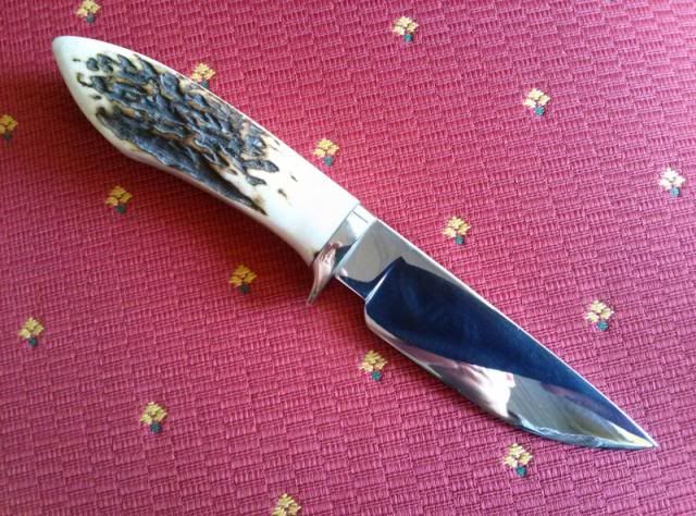

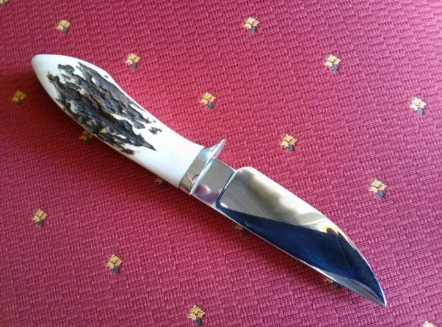

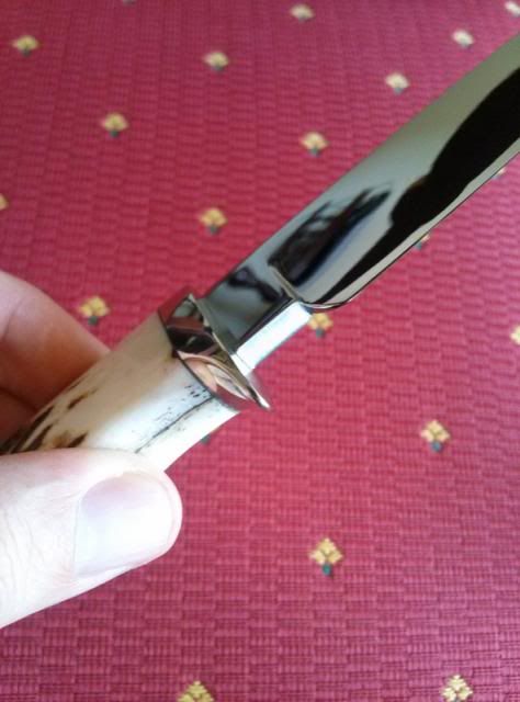

Hello,
a few years ago, I made a knife from a stock Leuku blade, this time, I wanted to make everything by myself (except hardening, wich did Rodrigo from 2Gknives).
Blade made of 01, convex ground, little dropped spine, 5mm stock, 10cm long with recasso
German Silver guard and european stag scales (with lot of pores I didn't see at the beginning).
Regards
surfer

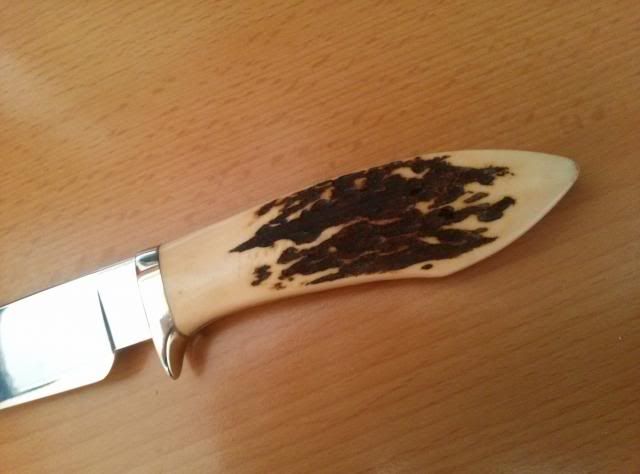

I was a little disapointed about the pores that show up in the stag.
Do you have an idea how to dye the stag to a reddish -yellow ?

Use an amber analine dye. I get mine from Lee Valley, but there are many places to get it.

Hello,
I managed to dye the stag to a light, old ivory like, yellow.
I put the handle in a glass of water for a 10 minutes, where I boiled onion skin before, with a little vinegar.
