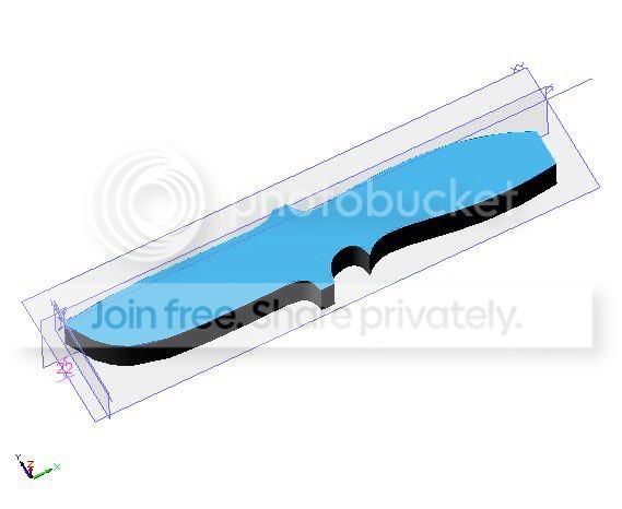

The specification:

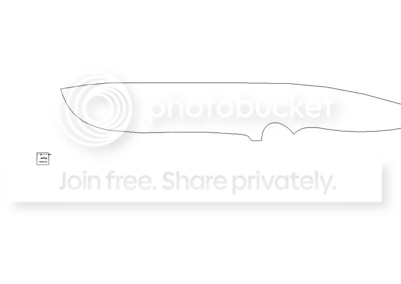

Design - Refer to drawing - Drop point
Steel - Bohler N690
Total lenght - 260mm
Blade leght - 130mm
Thickness - 4mm at the spine,flat grind to the edge

I have changed the design slightly due to material limitations, but I am very pleased with the overall look of the design.
As I have mentioned before I am water jet cutting the profile of the knife and I will take delivery of three blanks on Monday if all goes to plan.

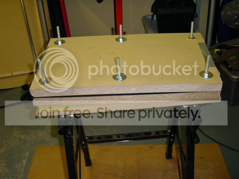

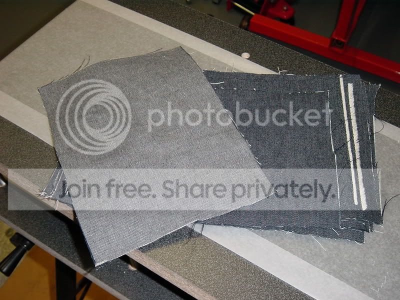

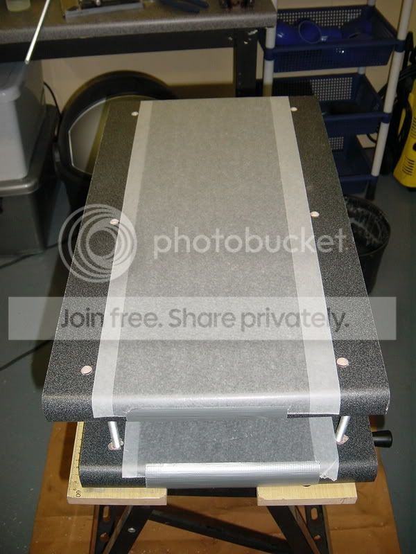

I have recently come across an article/ tutorial on how to make Micarta from jean material and since I am building my own knife I decided togo the full distance and experiment with making my own Micarta handle material.
To make the Micarta I used two pieces of Formica table top slabs with six (6) holes drilled through them to serve as my press.
I used plain threaded bar to make the bolts that will tighten up the press.
I taped some wax paper to Formica slabs to help with separation once the material and resin has dried.
I used a dark and light jean/ cotton based material alternating between the two shades, I really hope it works out well.

With my very limited micarta making experince I'd suggest one thing.
You are going to get alot of ooze. You might want to built up the sides where
you taped the waxpaper down to direct it when you want it to drip.Multiple layers of tape,thin wood stips you get the picture. You can elevate one end as well. You can have it drip into anything disposable. This will avoid alot of chipping/clean-up later

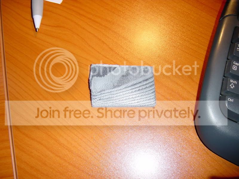

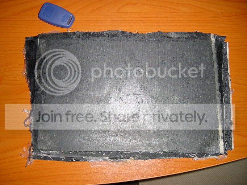

Hi there, thanks for the advise, a picture of the Micarta as it came out of the press, reeleased with no problems and looks very solid, but a strong chemical smell to it.
I left it outside and hopefully the smell will tone down a bit.
Sweet, Cant wait to see what that micarta looks like when you get into it. Ariel's twist micarta is really nice too. What is the scale on the most recent knife blank drawing you posted?
Hi there, if you want to I can send youa scale drawing of the knife in pdf format, just let me know.

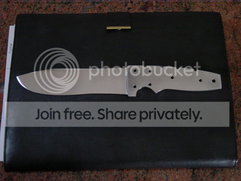

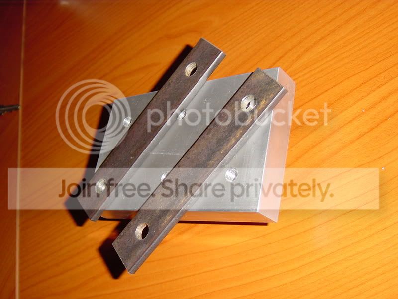

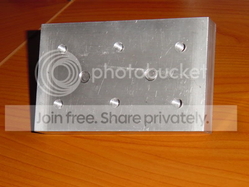

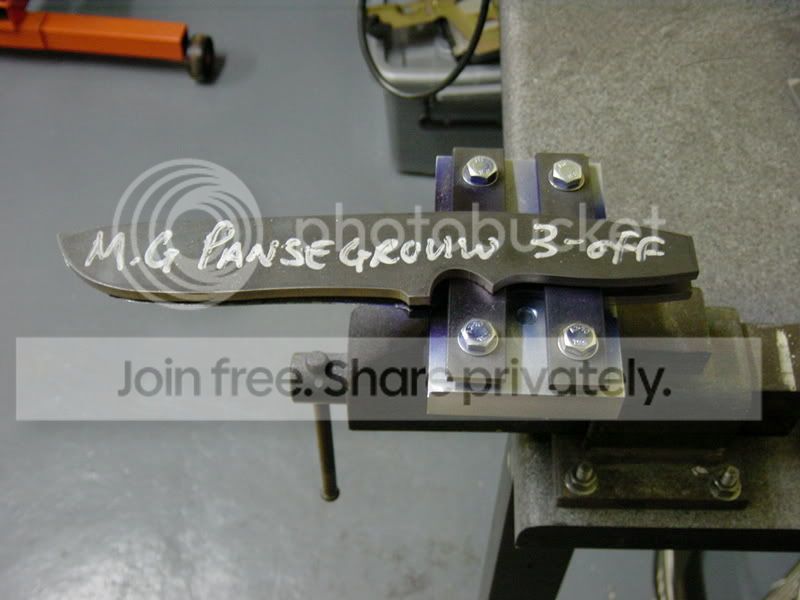

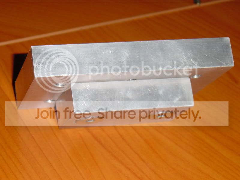

If all goes well I will be getting my water jet cut knives today and in preparation of the big filing exercise I made myself a knife clamp yesterday.
As always comments and usggestions are welcome :D
It is quite versatile and I can use it for big and smaller sized knives. At the moment the clamps are made of mild steel but I hope to replace them will stainless steel pieces as soon as I get to my local metal dealer.
It is made from aluminium with stainless steel bolts to hold it all together.
Had a go at the Jeans Micarta this evening and it looks promising, I am getting the blades on Monday and I cannot wait to start work on my knife
Neato. Show us more of your shop. Looks like its clean as hell in there.

Good design, great clamp. nice micarta! I'm about to try making some using railroad tie plates as the press (with clamps around the sides), but I have to wait for my glass fronted sanding boards to dry.....

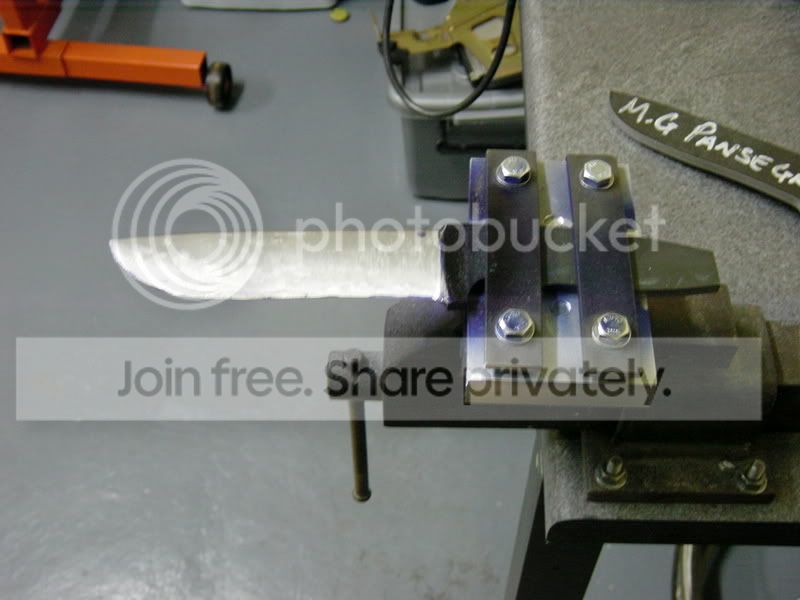

Hi there,
The work on the knife has progressed nicely and it has been heat treated to 59HRC and hand finished to 1200 grit.
This week I will do the bolsters and the handles and the final touches.
