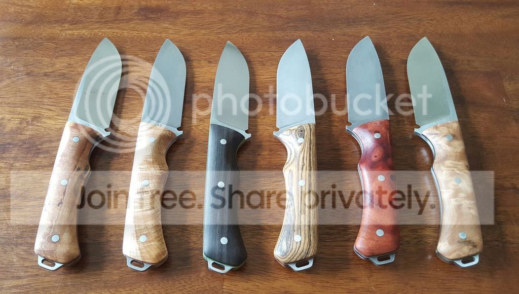

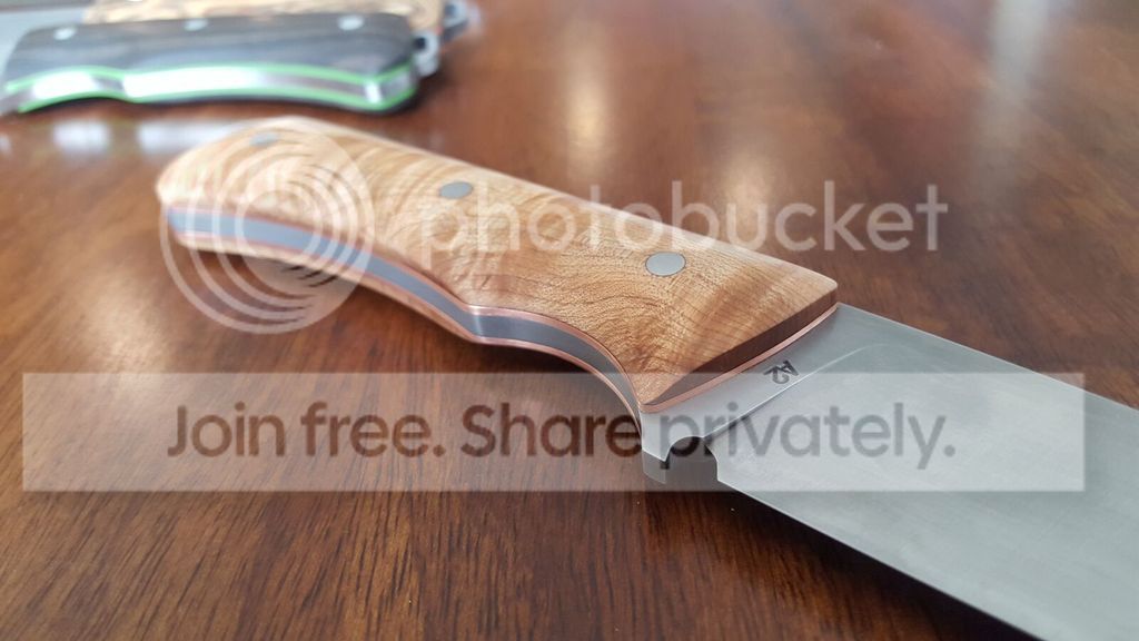

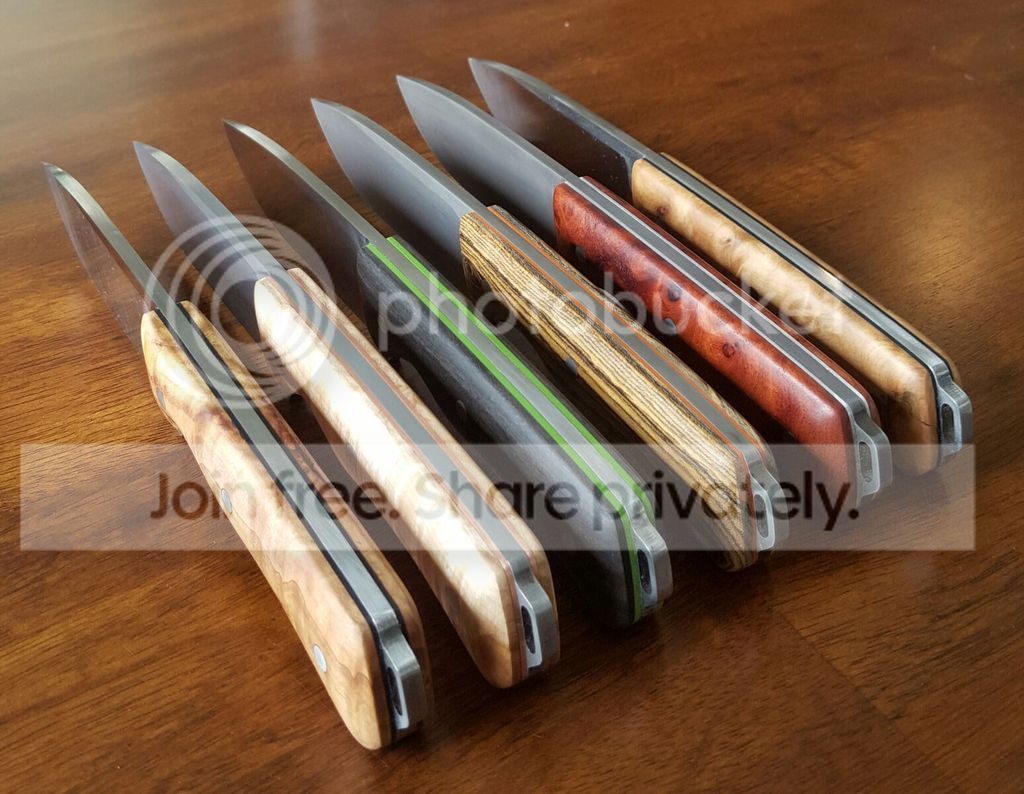

Just want to say thank you for all the help on the forum I wouldn't have been able to make these knives without it! I started out to make some knives for my groomsmen 5 months ago and I think I succeeded fairly well. I still have one question though would it be a good idea to coat the blades with some gun oil to prevent rusting ( the steel is A2 )? How will it effect the wood if I get it on it, the exotics are just hand sanded and have no coating. I have attached some pictures of them, the apricot handle knife ( far right ) has some marks on the blade from some tape, but I decided to leave it as is. Thanks again!

First knives?!? Holy crap, good for you! It's obvious you researched lots before doing anything. Very very nice!
