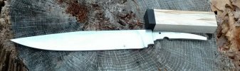

Haven't made much progress on anything this winter with the ongoing shop remodel but finally got around to reprofiling the old knife. I'm going to cut the end of the tang off a bit and use a clevis for this one. The handle block is not the one I'll use for this project but is very similar. The actual handle is out for stabilizing right now.
What's up with that notch in the tang right next to the pin hole. Looks like a week point.
I think the tang is fine and I'm guessing that was already in the steel or he notched it so epoxy will settle in there. I've seen guys cut small notches all up and down a hidden tang for a better glue hold.
I'd be more concerned with the angle of the tang. The way you have the finial holding the butt cap on, makes me think this may need to be a hinged two piece tang to keep the angles right.
The other thing I was thinking is whether or not I would like it better with a clip, it looks a bit like a fighter to me.
Aside from that I really like it. Definitely reminds me of Bill Moran's work with the wire inlay. Looking forward to the progress updates.
-Clint
That is the remnant of a bolt hole from the spring's prior life.
And yes, it would be a weak point for sure. But, the tang is huge on this knife. From the top of that hole to the top edge of the tang is over 3/8" and the tang's thickness is a heavy 1/4" in that area. I suspect a handle will give out before the tang.
With the amount silver inlay going into the handle I doubt anyone would ever use this as a chopper or fighter, and "fighters" aren't really fighters anymore. Also, this one will be permanently mounted in a display case, never to be sold, or used.
Definitely couldn't use that in a knife to be sold.
A Augus7us , the clevis will be the hing point, at least that's the plan. :)

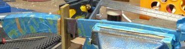

Shop is still blown apart from the remodel, about all I can do right now is piddle with the new work stations. I used the mini mill to inlet both scales for the tang ( just practice pieces to get used to the mill). Can't believe how easy this process was with the mill, and how tight fitting everything went together on the first try. I rubber banded the two scales together and there is just no wiggle room anywhere.
Wonder if maybe there is such a thing as too snug?
The tang was cut about an inch, and a clevis formed for a hinge point. Handle will not be shaped further until the guard is installed and the spacer is in place with reference pins installed. Have started carving a reverse mold for the forming of the butt cap. The open area near the file guard is for the guard and spacer.

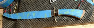

Had a few minutes just after lunch to work on my personal project. This was the first time I had used my guard jack, I'm very pleased with the press fit. The first handle developed a crack so I've replaced it with a new one.
A few more minutes on this today and a few more baby steps in progress.
