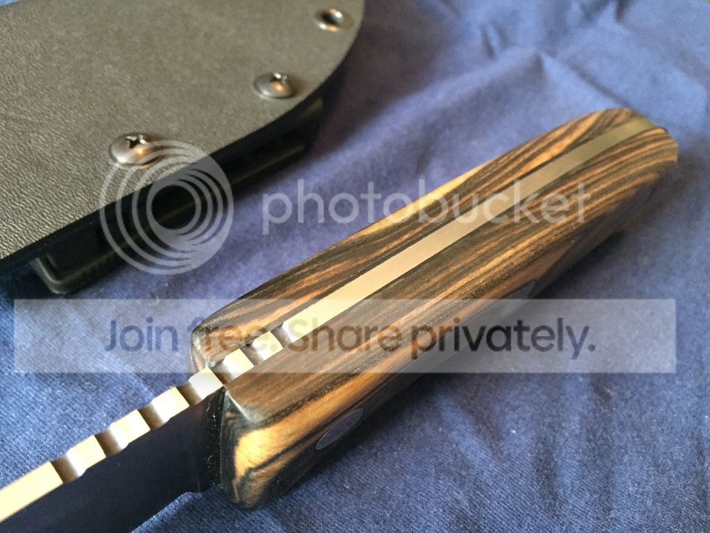

I had actually planned to slim it down a good bit more, and actually sculpt the handle to give it a coke-bottle-like shape. However, when I felt it squared off, it felt perfect. I was pretty shocked, because it's REALLY thick. I do have very large hands, though. I doubt it would fit most people's hands, but it feels great to me. I was also very shocked how I lucked out with the balance. I played with the thing for a few hours over the course of a couple of days and it just felt perfect. Then, I noticed that it balances right where my index finger goes on the grip. That was definitely accidental, but couldn't have worked out any better.
I'm still considering slimming it down maybe 0.1" on each side to make the screws totally flush, especially since I'm about to add another 0.06" in spacer material, but I may leave it alone. We will see once I get the blade back and get the spacer material on there.

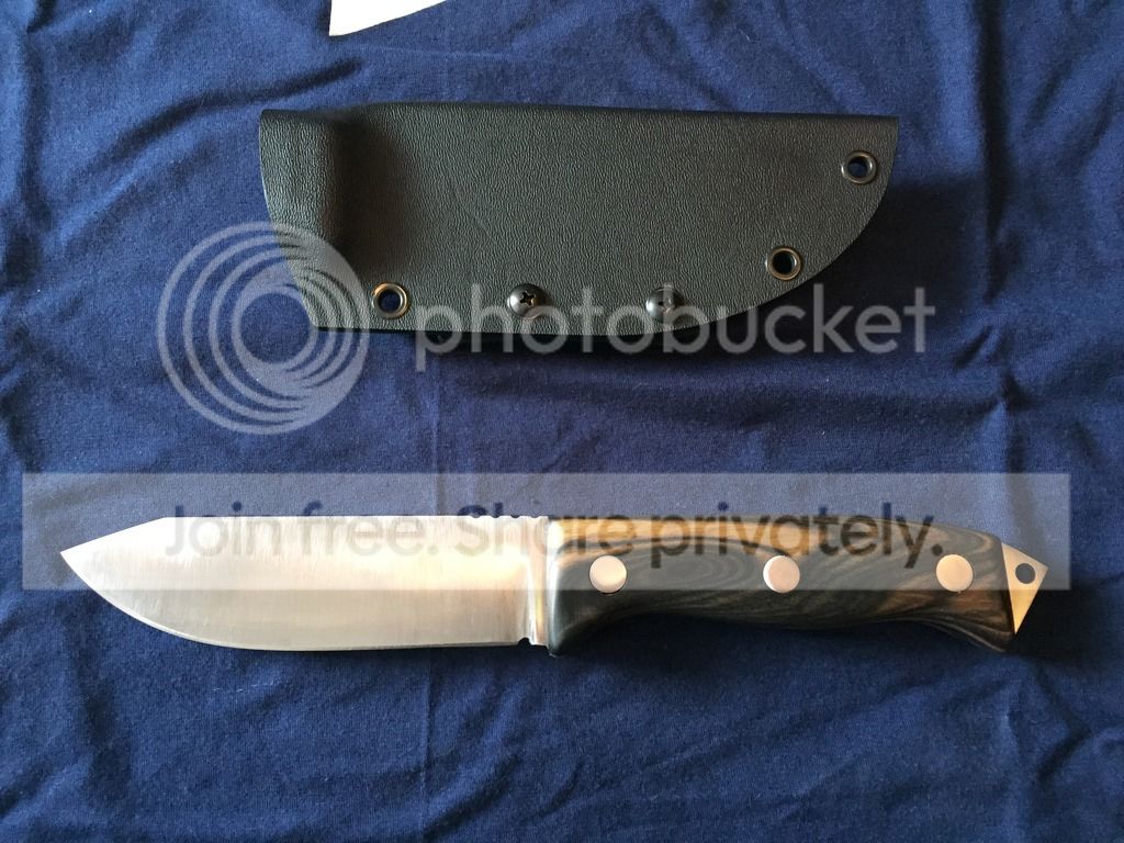

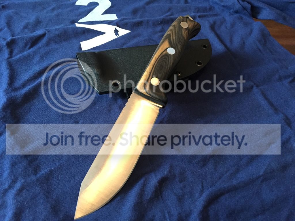

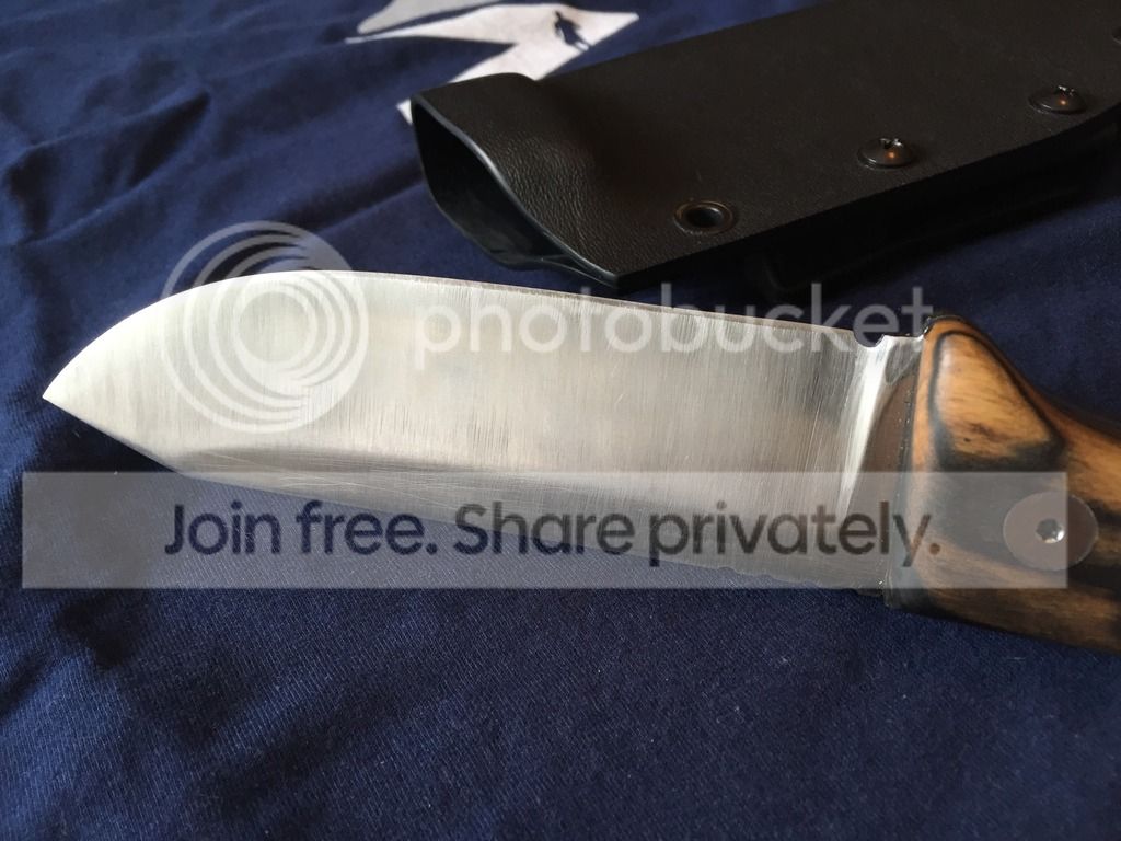

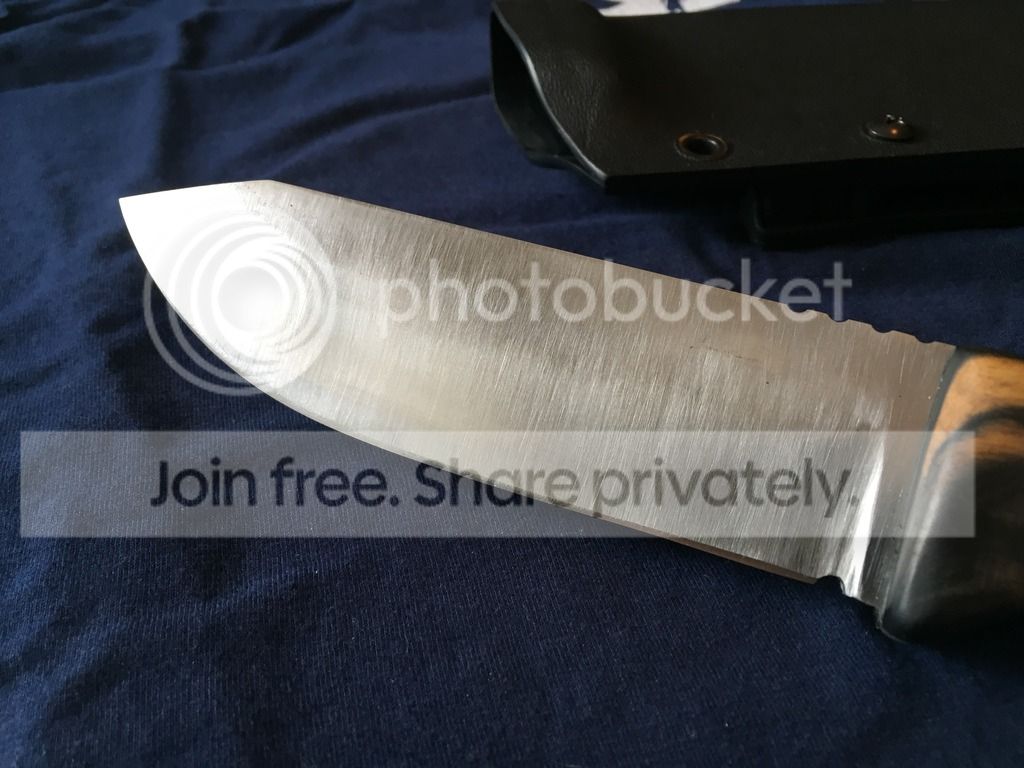

Well, I got the blade back from Peters Heat Treat, cleaned it up, and finished it. So far, I'm really liking it. It hasn't seen any hard use yet, but it will in the future. I am somewhat concerned about how tough the blade will be. I didn't really do much thinking about what hardness to request from Peters, and said 63-64. They went with 64. It is certainly hard as all hell. Sandpaper is essentially useless. I'm glad I had already sanded it to an acceptable finish before sending it in, because grinding off the scale was about all I could do. I didn't feel like eating up a bunch more belts, so I just left the grind as is.
The steel seems great so far. It cuts very aggressively, and hasn't lost any of its edge yet. This steel is incredibly wear resistant. Not only did I about kill myself trying to sand out some deep scratches, but it also ruined a Lansky extra coarse diamond hone. That hone has reprofiled hundreds of blades of all different kinds of steels. It was probably down to about 60% before I started sharpening this knife. For whatever reason, I decided to go straight to the Lansky, and not put any edge on it with the belt sander. That was a mistake. Despite the edge only being about 0.018", it took forever, and like I said, killed the hone. However, it did sharpen up nicely. I achieved a razor edge much easier than S90V.

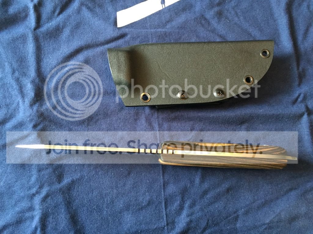

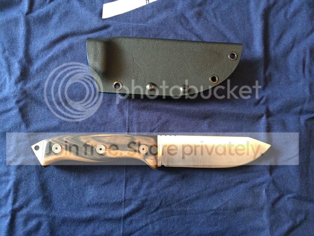

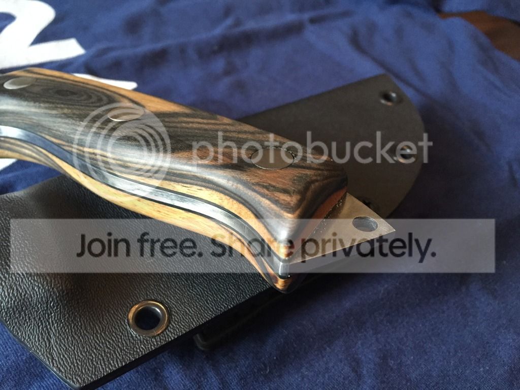

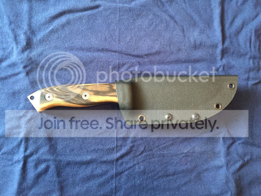

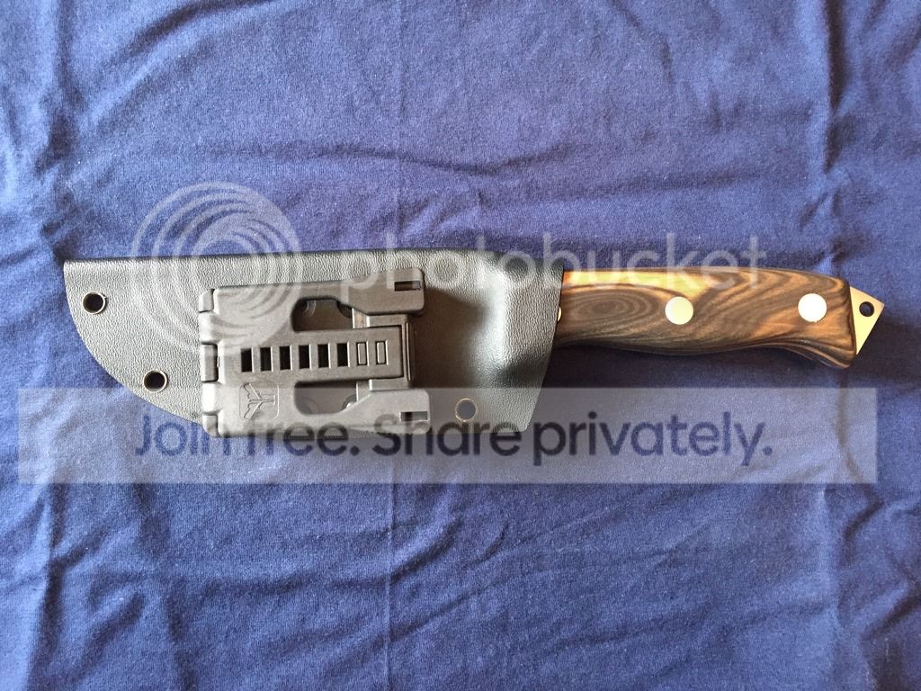

I made a kydex sheath for it last night, which was my first time messing with kydex. It was super simple, and really makes me wonder why there are high end knife makers that don't supply sheaths with their knives. That's just crap. As easy and cheap as it was to make this sheath, those makers should be ashamed. Anyway, here are some finished pictures:

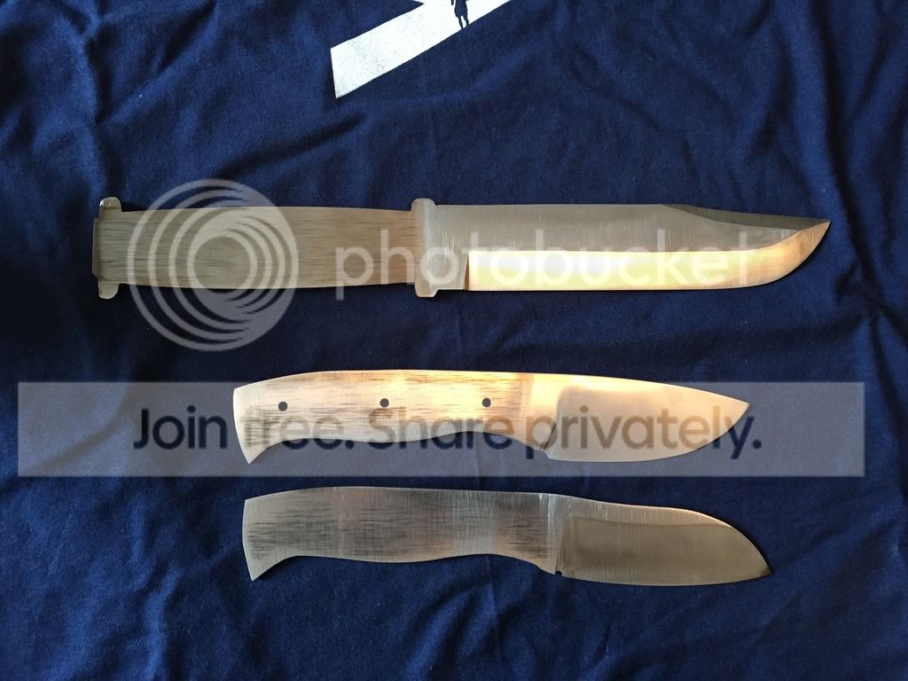

Here's a sneak peak at the next few. I have enough CPM 20CV to make about 7-10 knives, depending on the size. The top one, that looks like a KABAR is for my cousin who's in the Marines. He wanted a modern version of the KABAR, so I'm making it full-tang with green canvas micarta handles. I think it will turn out pretty cool. The smaller two are likely for me as a carry fixed blade. I like the the little Wharncliffe came out, but the other one I screwed up the plunge on the grind. I wanted to do an angled plunge, but messed up. Good learning experiences.
Even though it has no green canvas micarta and it's not residing in my Jeep it's still a nice knife, it'll be much better in green canvas micarta and riding in my Jeep. :D
Nice looking knives.
On the one going to your cousin, hit those inside corners with a chainsaw file to round them. Those sharp 90° corners can create a location for stress risers to propagate.
And see if the top guard would be more comfortable as a thumb ramp on the handle side.

I can't thank you enough for all of your advice and shared experience. It definitely makes my life easier and my knives nicer. I will definitely round out those corners a bit. As to the thumb ramp thing, I wanted to make the handle with a molded-in guard instead of a separate metal guard like the actual KABAR. I'm not sure if this will make sense (or even work), but what I'm planning to do for the handle is use thick micarta (like 1/2") and grind it down so that it is basically a round bar with the same cross section as the handle you see. It should end up looking like it was turned on a lathe. That will give it a guard at the top and bottom. I have no idea if it will work, but we will see.

I carried my knife today while at work. First, I love it. It works great, and got used hard on its first day out. It sharpened pencils, cut plastic wrapping, chopped through a few small pieces of hardwood (poplar), chopped/cut some MDF, scraped rough edges off some plywood I cut with a sawzall, opened boxes, and various other tasks. The edge is still razor sharp. I was especially impressed with its chopping performance. I never use knives to chop stuff, but just so happened to need to do so today. Normally, I wouldn't have used my knife for this, but since I had a large fixed blade with me instead of my usual folder, I figured why not?

Great first blade. Good, useful shape and looks like a comfortable handle. You're definitely on your way. Great first sheath as well. Kydex and the other Kydex like plastics are great and very forgiving.
