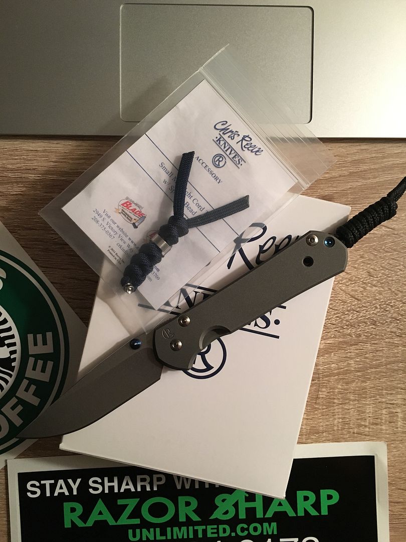

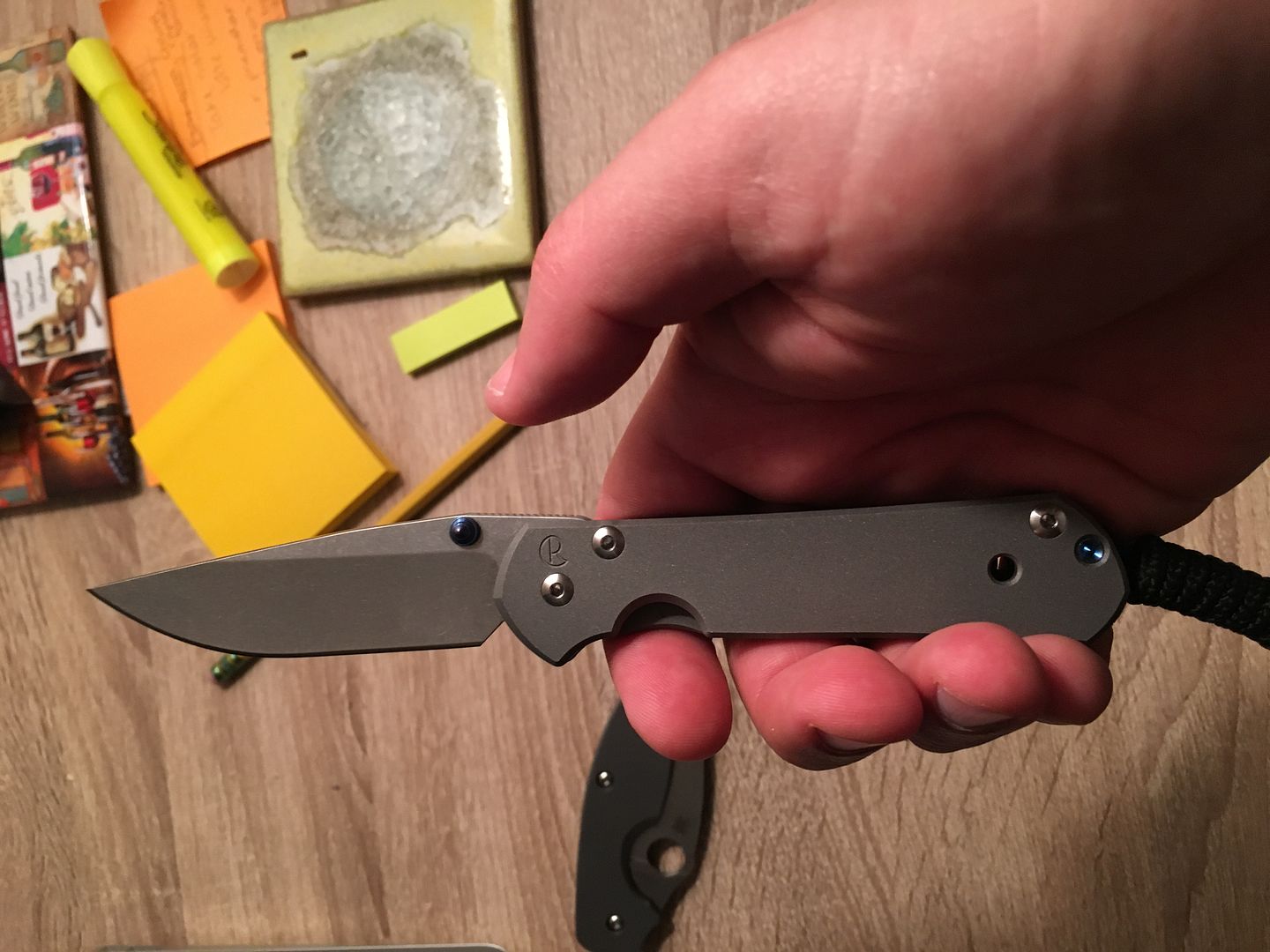

I just picked up my first Sebenza from a great local Chris Reeves authorized dealer. A Small Sebenza 21 Plain.
My first impressions:
Beautiful looking knife. Bigger in person than I thought it would be. Fits my hands great! The Large Sebenza looked and felt way to big in my opinion for EDC.
I'm hoping it is because it needs to be broken in but the deployment is so tight you can feel the ceramic ball riding on the blade as you open. I've heard people say Sebenza smooth. Im hoping I feel that as I break the knife in. Flicking it open is a no go right now, and after unlocking you could not shake that thing a smudge back into a closed position. Ive heard people say theirs took some break in time but I was at least expecting it to be smoother out the box than my Sage 2 but that was not the case.
Born on date for this small Sebenza is Jan 2016. It has been sitting in a glass display case since then. Does a CR typically need to be lubed this soon? Any feedback from Sebbie owners who bought brand new would be much appreciated.

Great pics, yep, that one looks like it will serve you well.
Post some more pics when she is truly yours with the marks you've put on it from use.

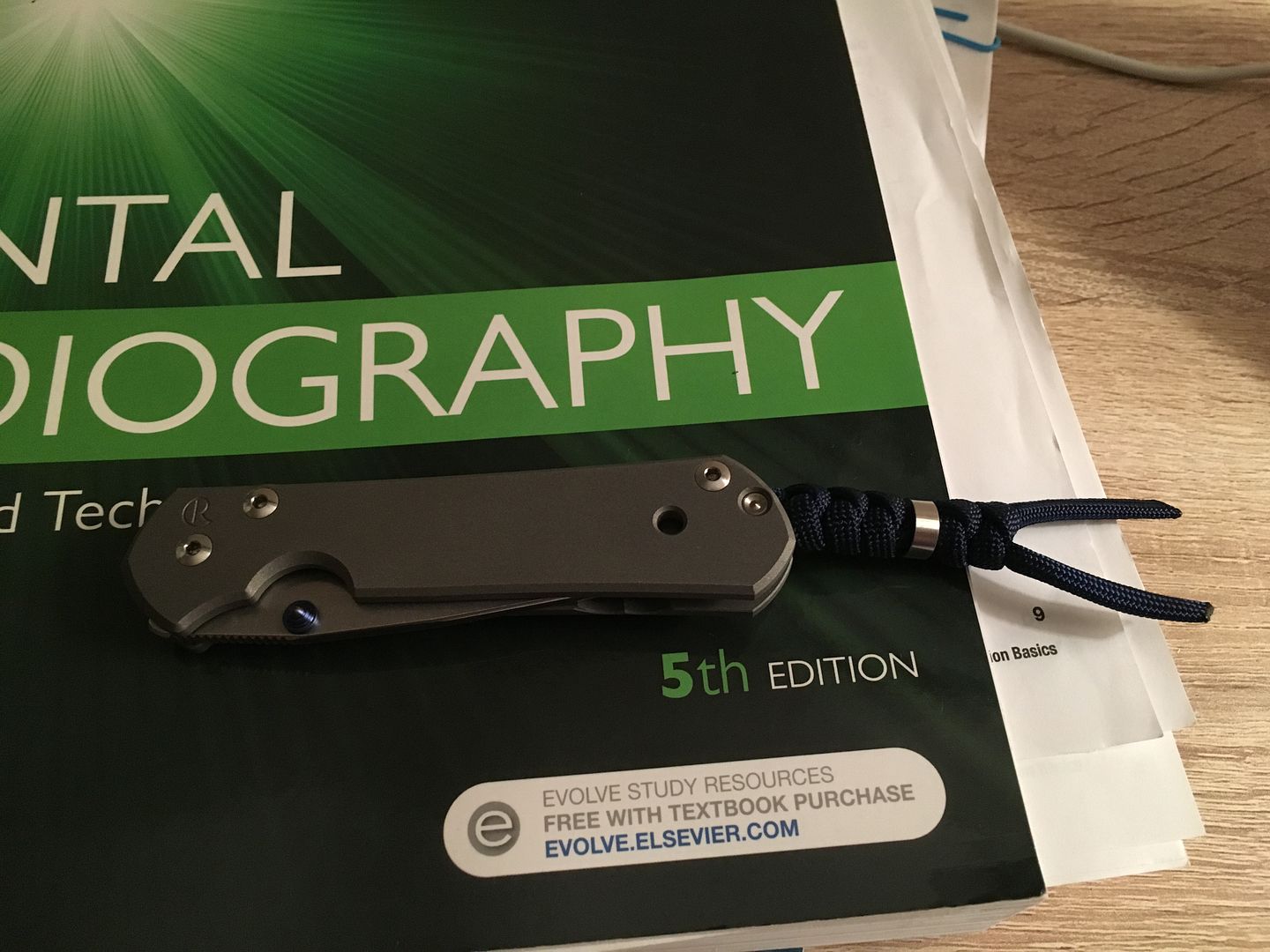

Just cleaned, lubed and installed new lanyard. Definitely smoother! Not 100% broken in but no friction. Was a little bit of a pain to reattach the scales. Bringing the blade to an L position was the trick that allowed everything to fall into place. Thank you Youtube. Heres a pic with the new lanyard.
Just make sure when doing assembly not to do it like a sandwich. Put the scales together and then slide the blade in with the washer and pivot bushing all together.
