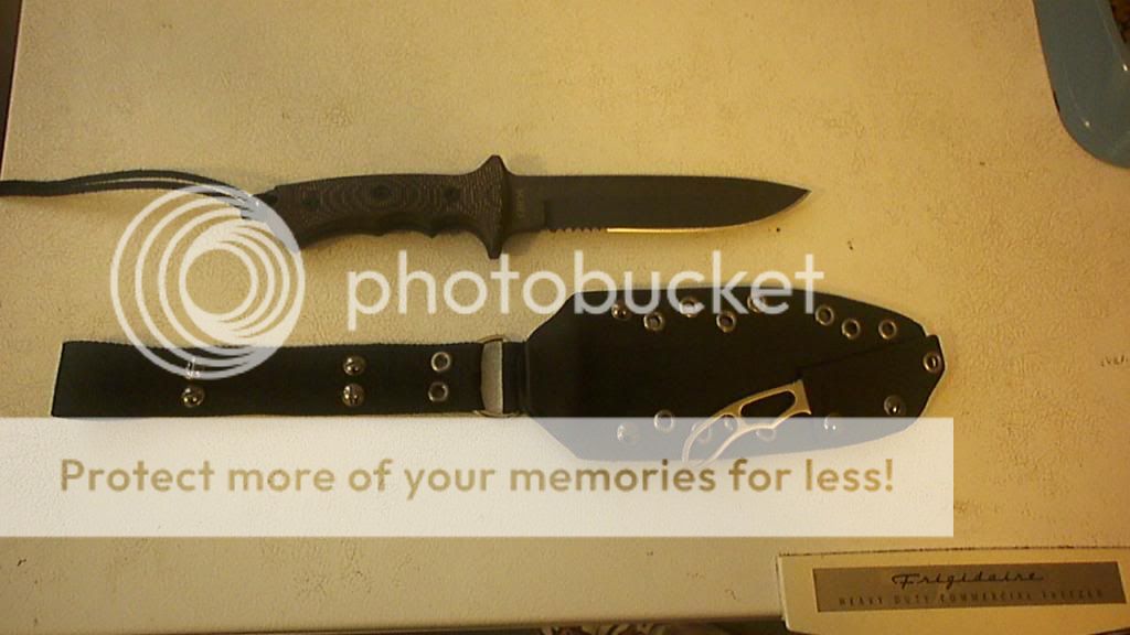

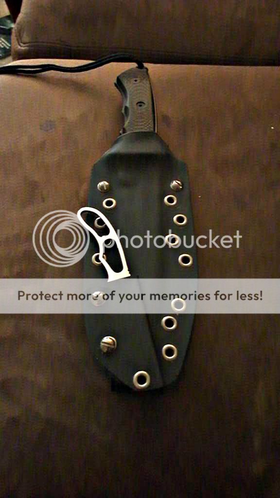

So I make my first sheath using what materials I could get at my local Tandy leather store.
0.93 kydex
1/4 eyelets
1/4 eyelet setter.
Chicago Screws.
Already had the toaster oven and heat gun
Made a press from scrap wood i got for free, and bought foam at Cabela's.
used a dremel cutting wheel to shape it. Hand drill to drill the eyelet holes.
The piggyback sheath is made from 0.60 kydex
I made the mistake of setting the first eyelets to far out, so set some closer to the blade. that the reason for the offset eylets.
So what i learned making my first sheath?
Don't buy Eyelets for Kydex from a leather store. they are almost to short. especially with 2 sheets of .93 kydex.
I am gonna try .93 and .60 on my next sheath.
Also plan to make a order from a proper supply company.
thanks for looking.
It's a bit scruffy but ho hum, good effort. If it's any consolation I can tell you that I was looking at a Kydex sheath the other day by a well known maker and it was rubbish. It had 50% of the width of the blade either side doing little useful. I know there needs to be some welt margin for the fixings but that was ridiculous. Quite why someone would want a sheath that's 100% wider than their knife is a mystery to me. Given that one was a professional effort yours is doing just fine.
Nice, Looks a heck of a lot better than my first! Is there a purpose for the staggered rivets? What is the big knife? Try reducing the size of the welt section a bit (the space on the sheath between the edge of the blade and the edge of the kydex).
Maybe not perfect, but it looks good and functional! You can buy rivets for the thickness of kydex you use. Knifekits sells each size in different colored packs of 100.
Big knife is a Schrade extreme survival model. I'll snap pics when my battery is charged again.
Small is a Kabar johnson piggyback.
Eyelets are offset because I drilled some holes closer to the blade.
Now I need a tuitional on how to make the slots for a leg strap.
Thanks for the comments.
