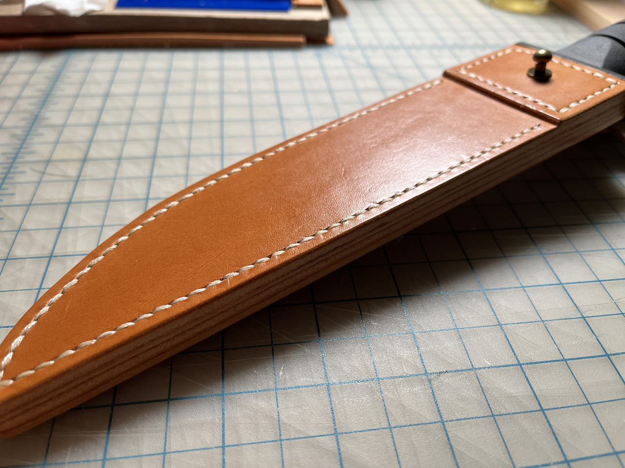

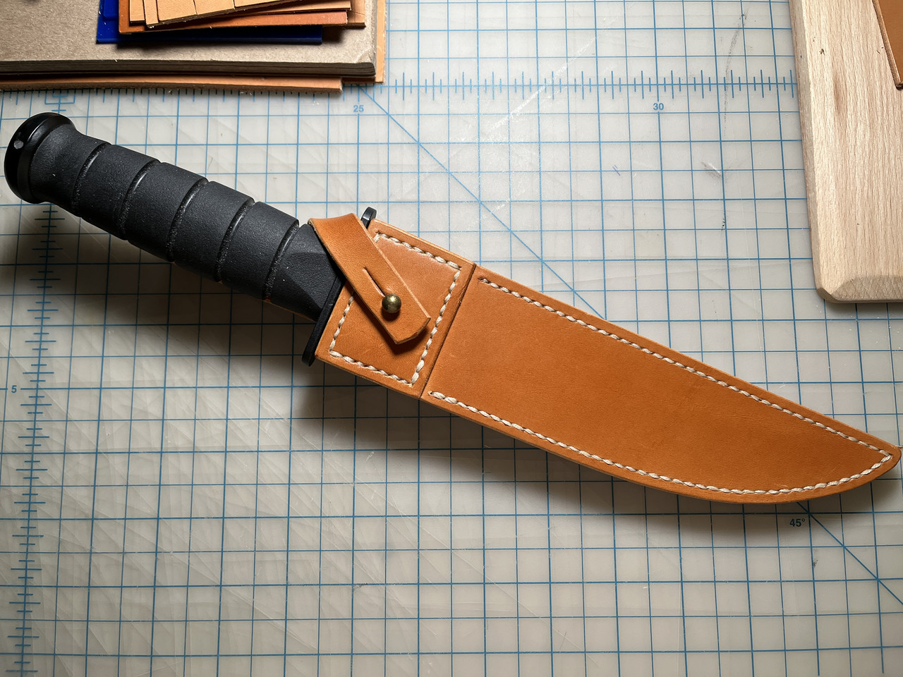

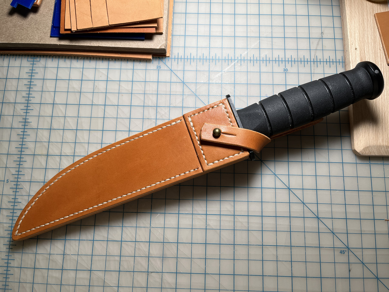

Built for a KaBar 1266 Modern Tanto. Wickett & Craig russet skirting leather, hand-stitched with Barry King stitching awl. Far from perfect, but I learned a lot, and my next sheath will be an improvement.
My vision was for a functionally minimalist, geometrically clean, visually restrained working sheath designed for fast, quiet, unobstructed draw, informed by traditional forms filtered through restraint and proportion.

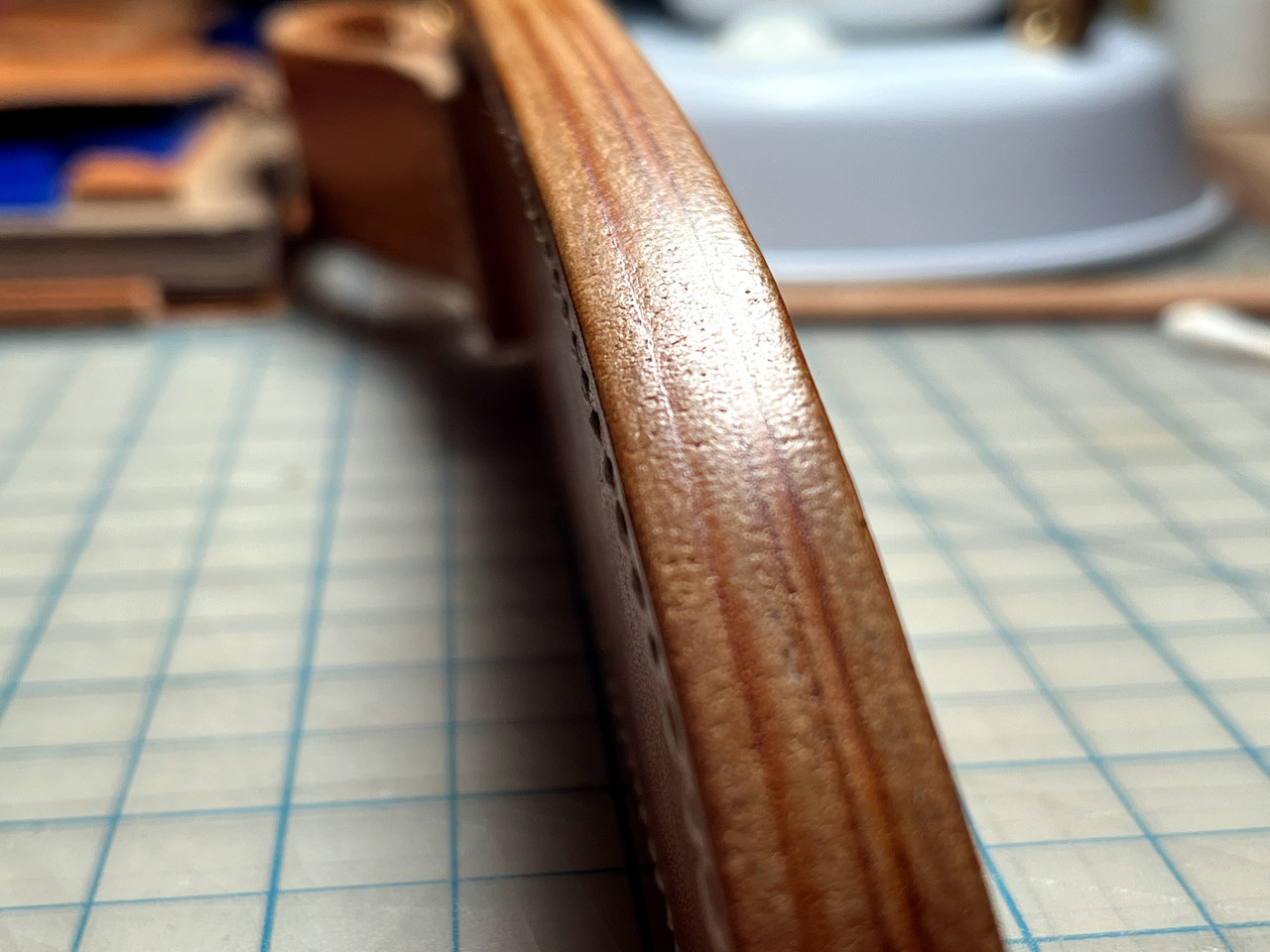

Awl stitching is somewhat challenging at first. The Sam Brown button placard stitches were done with a C.S. Osborne #54 stitching awl that I tuned and polished. I switched to a Barry King awl and a large haft for the main body, and cut a stitching groove on the back panel, the same offset as the front panel, so I could watch where the awl wanted to come through, and I could adjust as I went. After a bit, it became a little easier - nice when the awl penetrates perfectly in the center of the back panel stitching groove - but it definitely requires attention. In the next iteration, I will focus more on maintaining consistent stitch tension.
