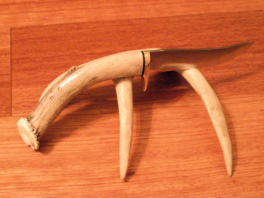

This is a skinner I just finished for my brother-in-law. He's an avid hunter and this will be a birthday gift.
The blade is 4.9"
The handle is white tail deer shed antler. (no deer died to make this knife)
The guard is 1/4" brass bar stock.
What do you think? Pros? Cons? Be honest, where can I improve?
Thanks,
Lance
First, welcome to Blade Forums Lance.
You state this is your first Skinner, how many knives have you made total?
In my opinion you have made a very good effort here and the knife shows you have skills and are off to a good start. Your guard looks pretty good and I'm impressed (from what I can see) with your handle/guard fit-up. Would like to see a photo of the ricasso to guard fit-up. These are two areas where new makers really struggle early on.
I would like to have seen you use a straighter stag carver for the handle as your knife suffers a little from an ergonomics perspective. A dropped point may have worked better here than your upswung tip.
Try tapering your blade from base to tip on the next one.
Hope I haven't bumped you out too much with my critique, as I said you do show skills and determination. Please continue to show your work here. :) :thumbup:

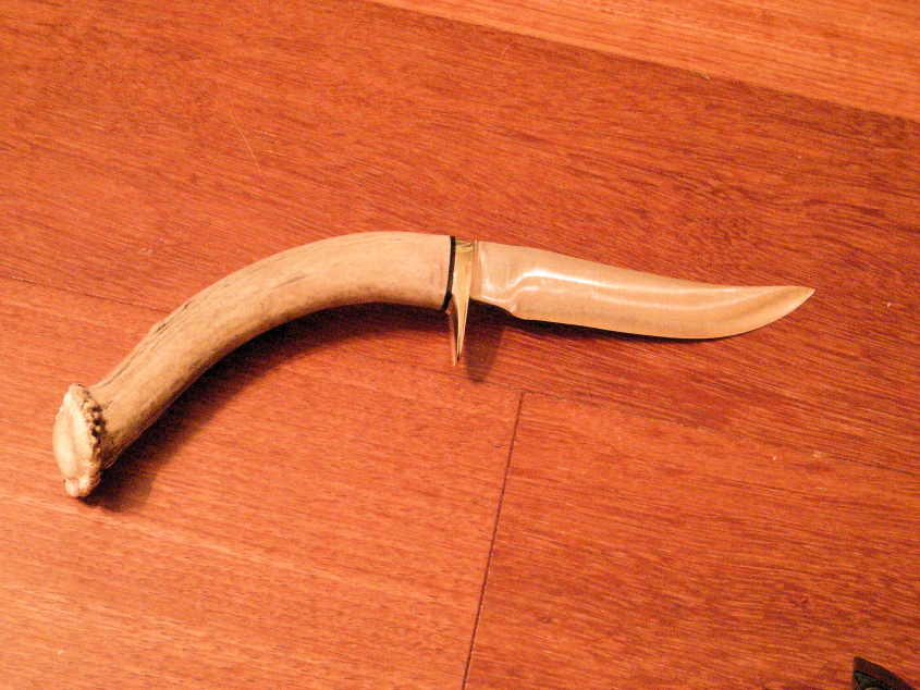

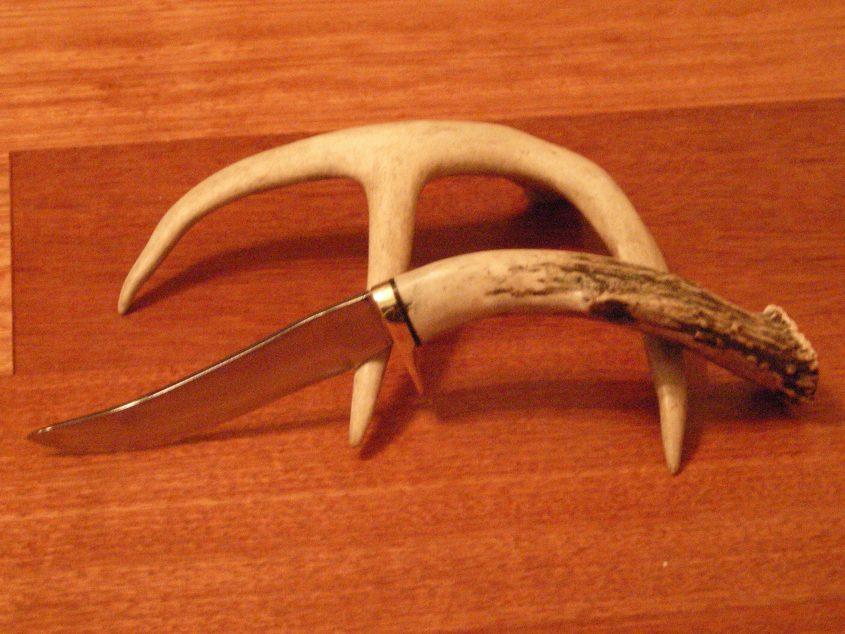

Actually, this is only my 3rd knife, and I probably shouldn't count my first at all. I took a 1 day class with Ken Largin (Kelgin Cutlery) a few months ago. My first knife was with him, and I think he did more work on it than I did by the time it was done.
Here's a picture of my first knife EVER (the one I made with Mr. Largin's tutelage):
My second knife was a full tang made from an old bandsaw blade. Not much to look at...
This is my third attempt at a knife and I think I'm "starting" to get the feel for it.

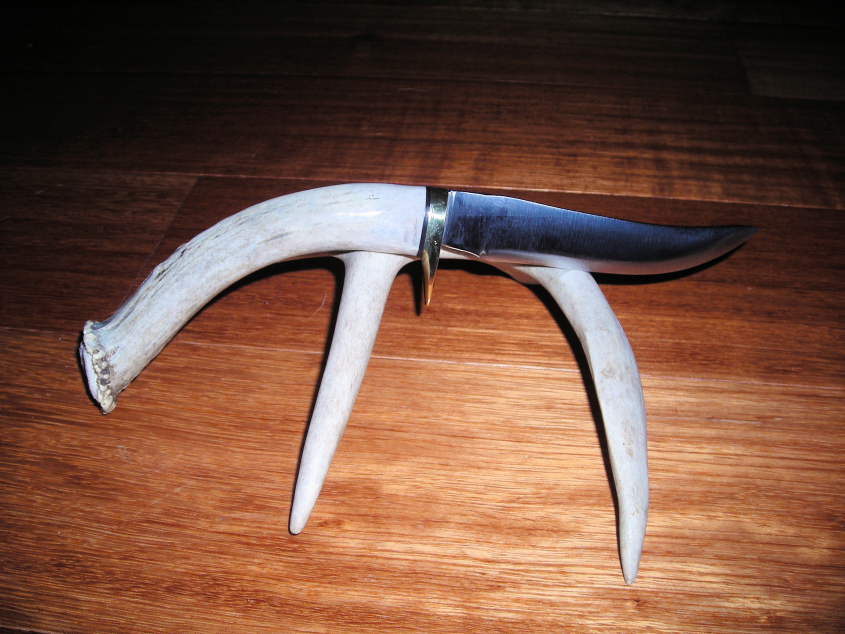

Here's a closeup where the ricasso meets the guard.
I got it pretty square to the guard and you can't tell where the tang goes through the guard into the antler.
What do you think? I'm sure there's some improvement I can make here. I think perhaps a little more time on the buffing wheel might improve things more.
Lance.
Last night I finished up a sheath to go with the knife. I'm no leather worker, so it's a VERY simple sheath I made from a kit. But I can't give a knife as a gift without a sheath to put it in.
Thanks for the additional photo.
Still impressed with your handle/guard/ricasso fit-up at such an early stage.
Your polish will improve with a little more time, experience and use of buffing wheels/compounds.
