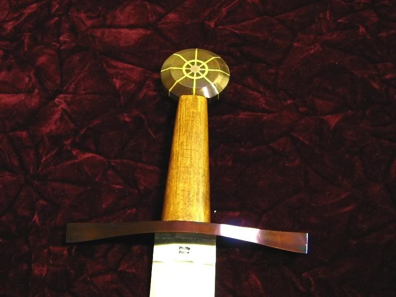

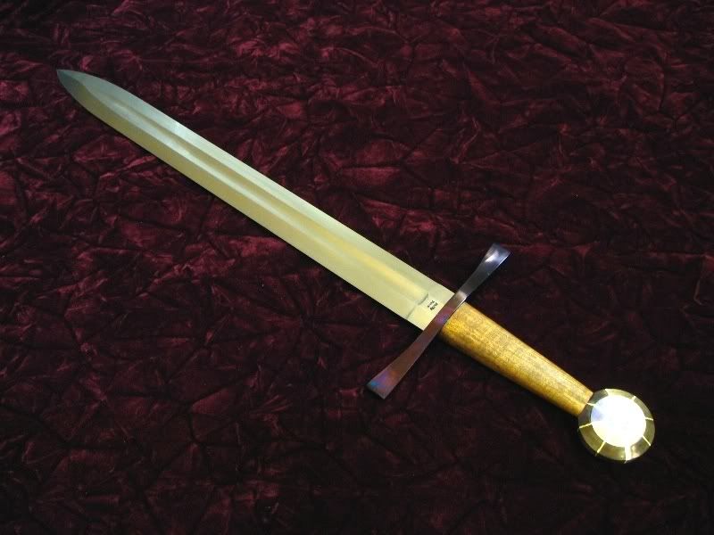

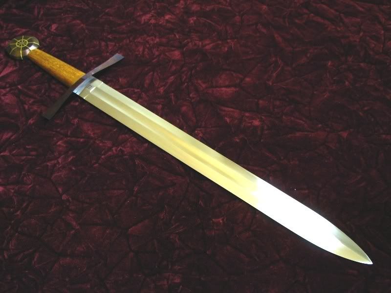

Howdy all,
The pieces for this sword have been laying around for over a year now, (I actually started working on it 2 years ago) and yesterday I finally got tired of looking at them. So last night and today, I worked on it and got it finished. (No, this wasn't for a customer. :D) The blade steel is 5160, the guard was forged from 1" re-bar, hardened to 45 RC. I don't know what the wood is, but I like it. :) The pommel is mild steel. It's the part that was left over when I used a hole saw on another project. The blade is just over 20" long, overall length is 28".
The pommel and guard have been heat colored.
Thanks for looking,
Phillip

The handle looks like ossage orange or ( hedge ) To me.
T.A.Davison
Thanks guys!
The handle is definitely not Osage. I forgot to mention I dyed the handle. The wood was very light colored, and not real hard. I think it might be ash or maple.
But your right, the handle does look a lot like Osage Orange. :-)

Forged? How'd you HT that badboy?
It was a little hairy, but not too bad. My gas forge has a front and back door, so I moed the sword in and out, checking it with a magnet once in a while, until it was as close as I could get it to being the same temp all over. I probably won't be doing any longer swords until I build a sword forge, like Don Fogg has. :)
For tempering, I used my Evenheat oven, which is 22" deep. I couldn't shut the door, so I plugged the opening with Kaowool, and tempered it one half at a time. :D
