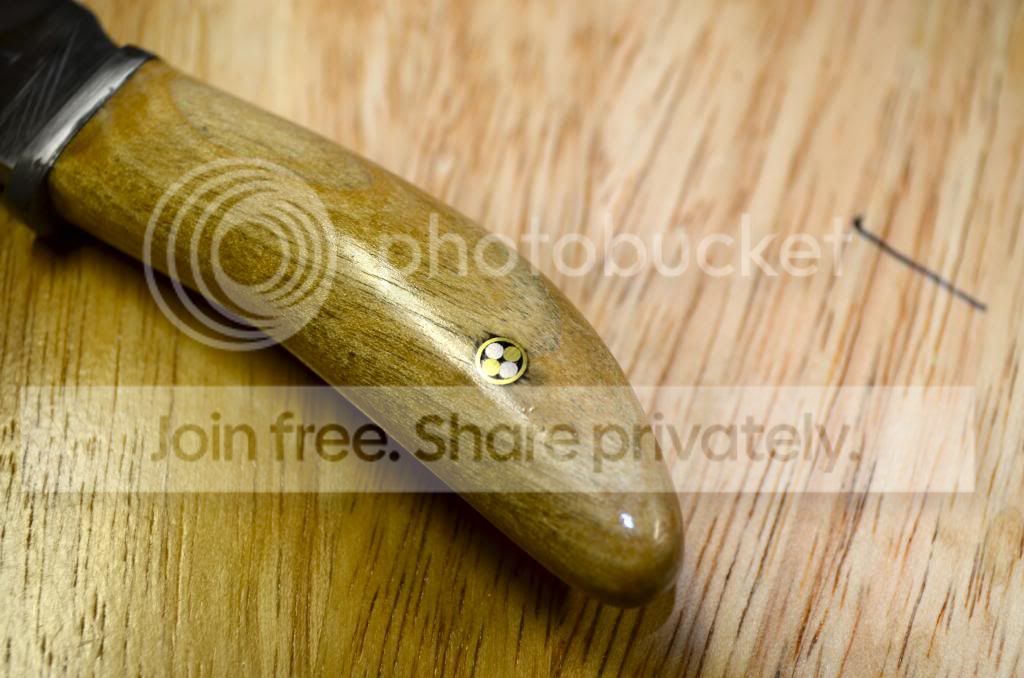

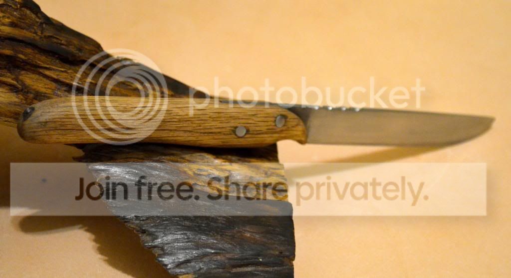

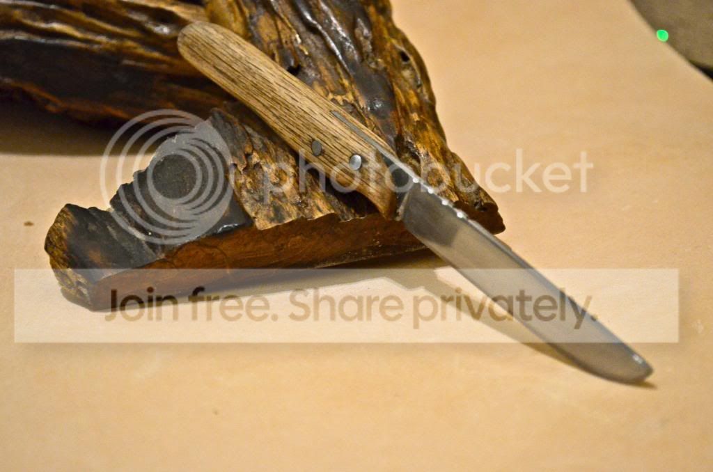

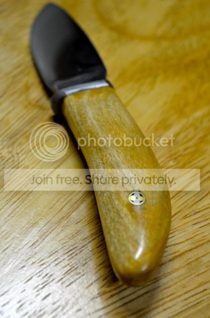

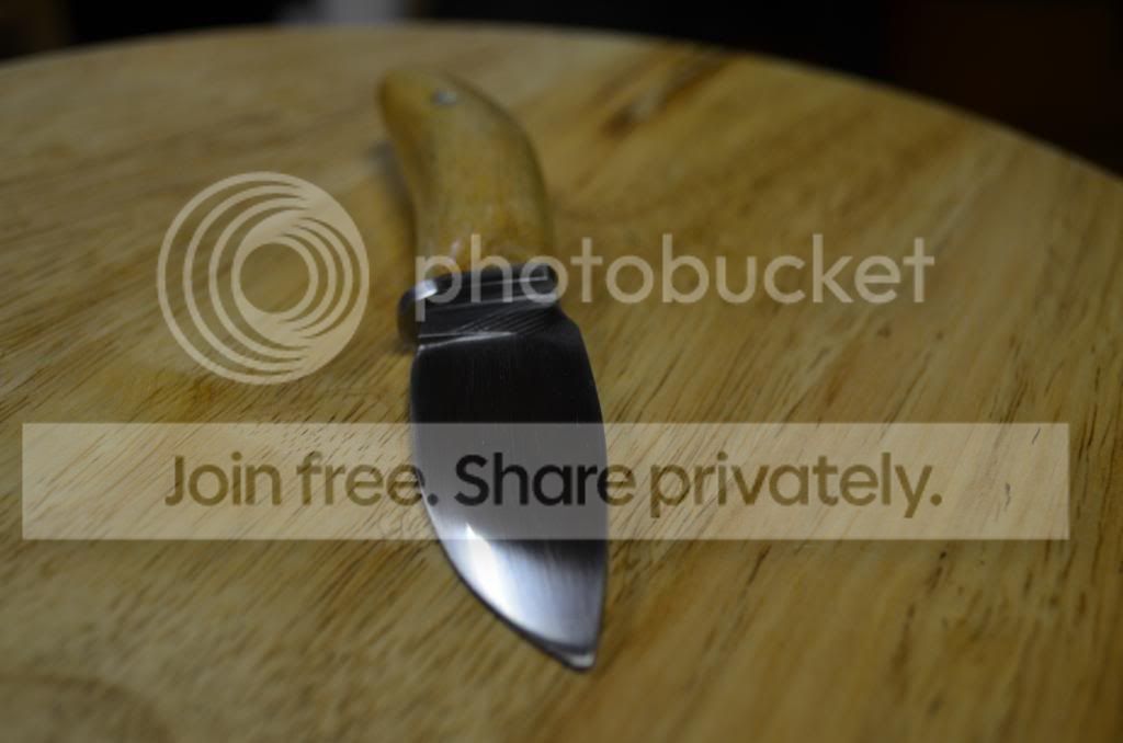

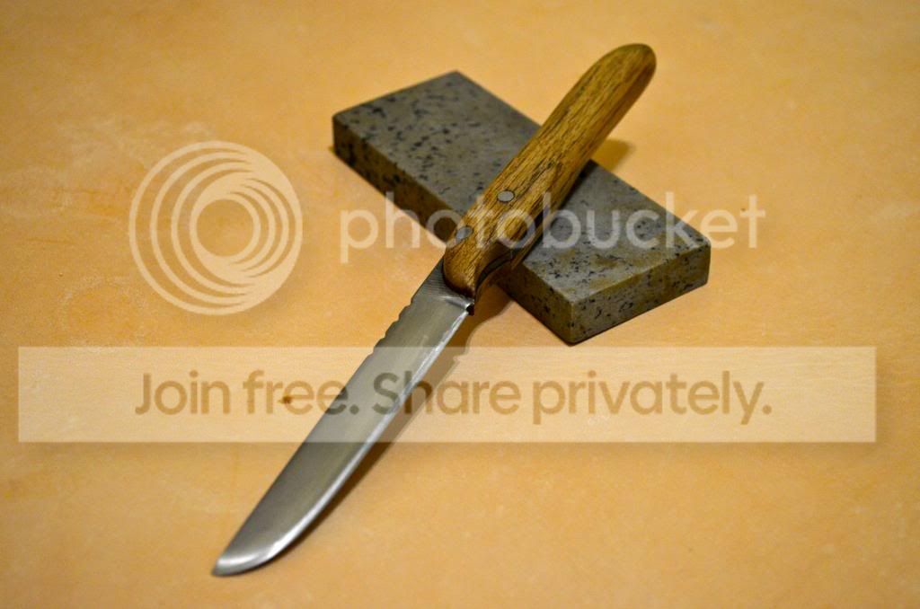

I recently attempted to make a couple knives from old files. I had zero knowledge about knife making and minimal tools but it was a fun challenge.
What do you think? any advice for a new guy?
This was the first one.
Here is number 2. It needs to be cleaned up...still some tung oil on the guard.

Those are good first knives.
The only thing that might be a problem is the short tang length on the riveted handle knife. It could split the handle if any pressure was exerted when cutting hard. A full tang that goes all the way up the handle is much better.
The second blade is a hidden tang ( AKA - Stick Tang), and if the tang goes 1/2 way up the handle, it should be fine. Is the mosaic rivet in the actual tang, or just decorative?

Thanks . I appreciate the advice. The tang on the first knife does actually run the length of the handle. Because of the taper in the file I used, I was not able to do a full tang the entire length(had to work with what was available). On the second knife the tang runs about 3/4 of the length and stops right before the mosaic pin. I made the pin myself so I wanted to see how fitting in a handle worked.

I started making knives by grinding hard files. That's a tough row to hoe. Just wait until you start working on new stock that comes annealed -- it's really a pleasure. Unless you have some way to heat the knife and maintain a temperature, sending out for heat treating is a good way to move your craft forward without getting discouraged and bogged down with technical troubles.
Thanks guys for the positive feedback.
Roadracer, I am planning on ordering some steel and sending those out for heat treat. Any suggestions in PA?

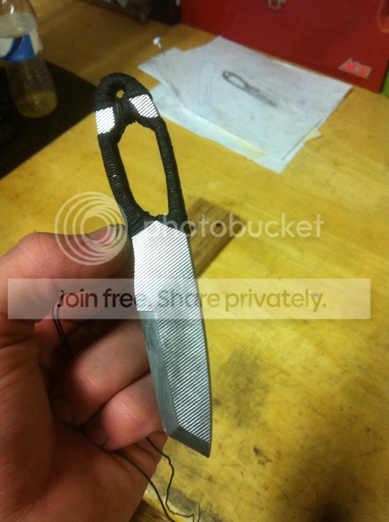

I also started working on this neck knife and was thinking about wrapping the handle in wax thread. Yay or Nay? I still need to clean up the blade and attempt a charcoal forge, heat treat.... but I was just testing the wrap idea.
