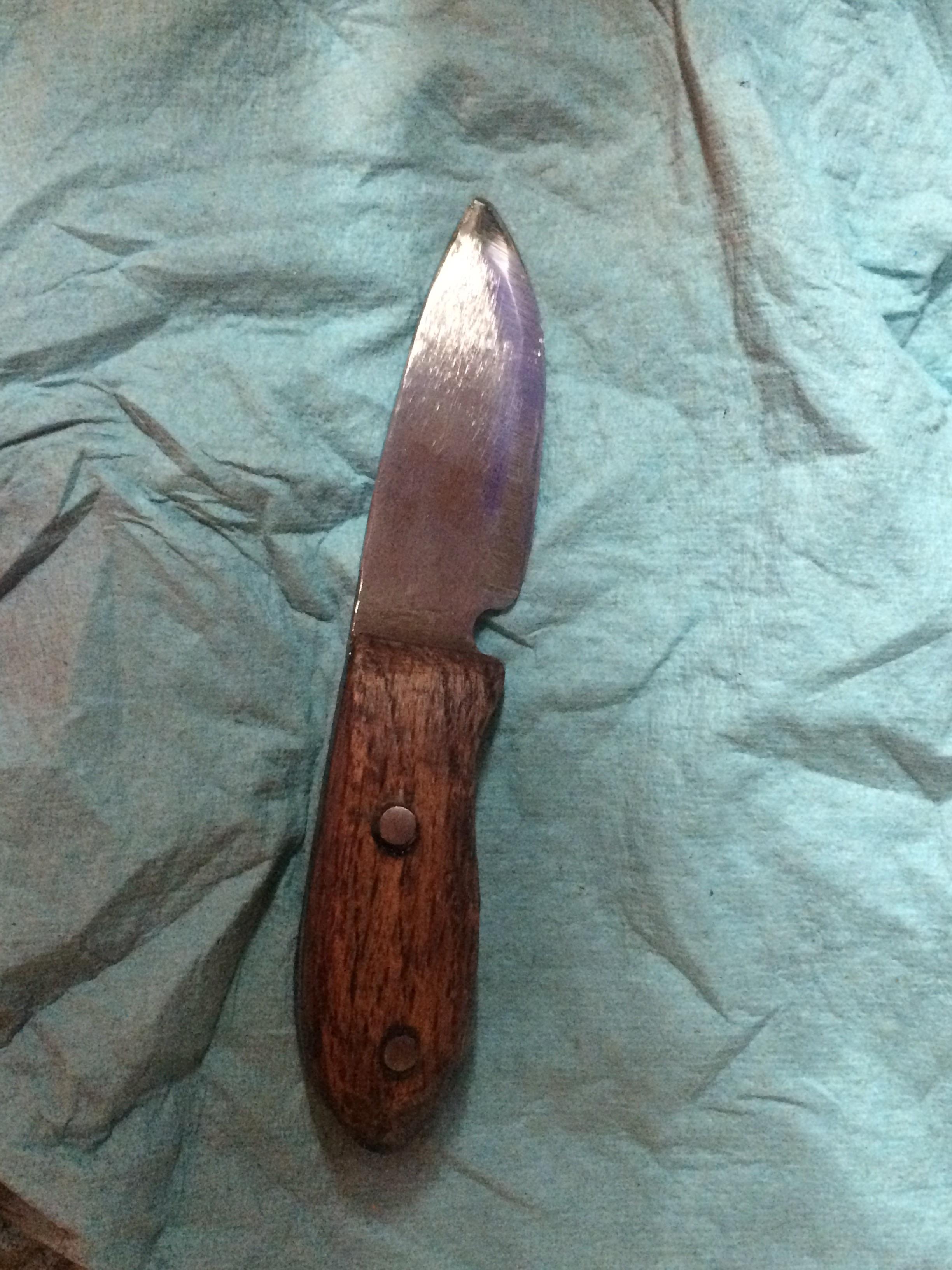

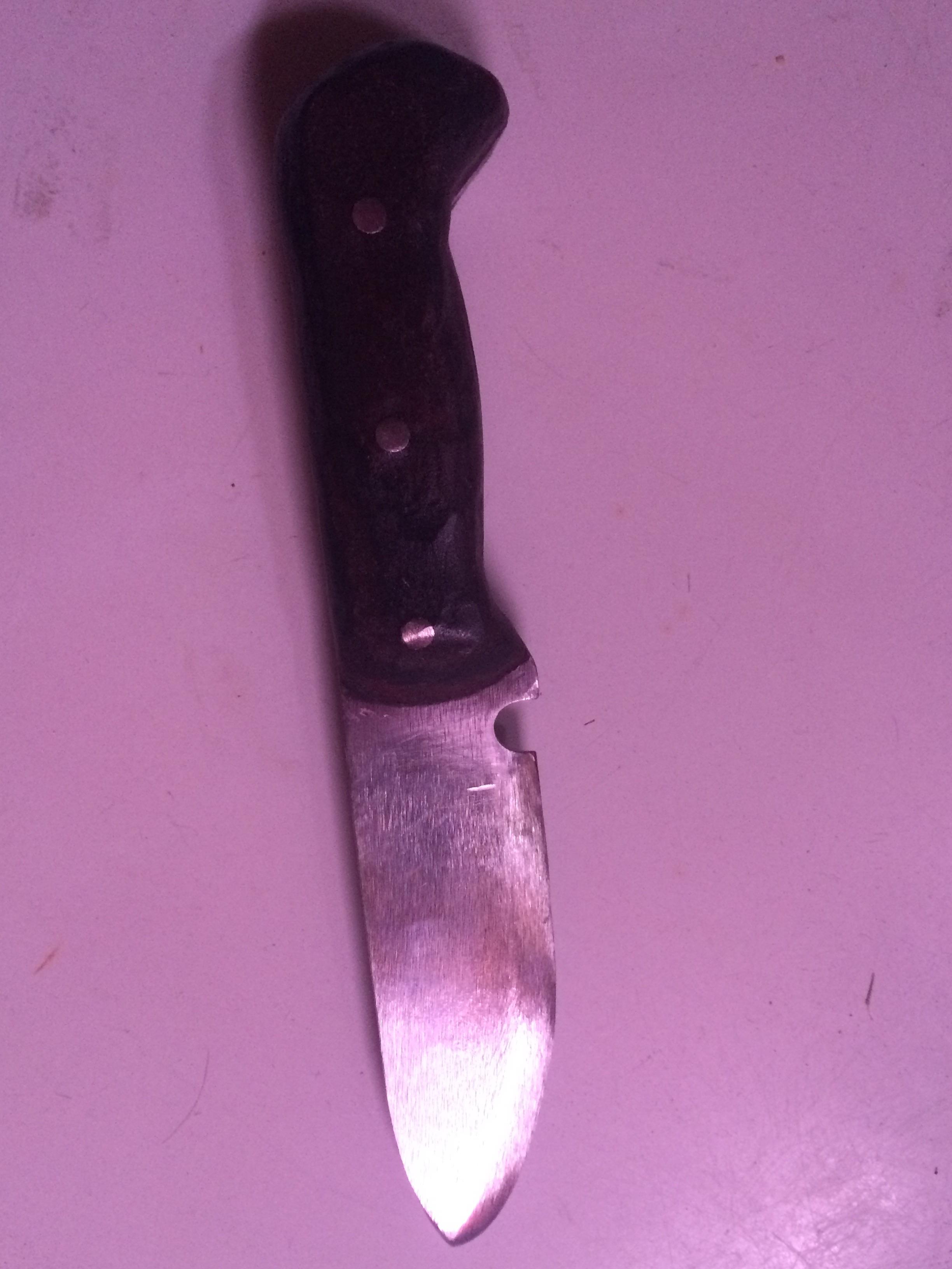

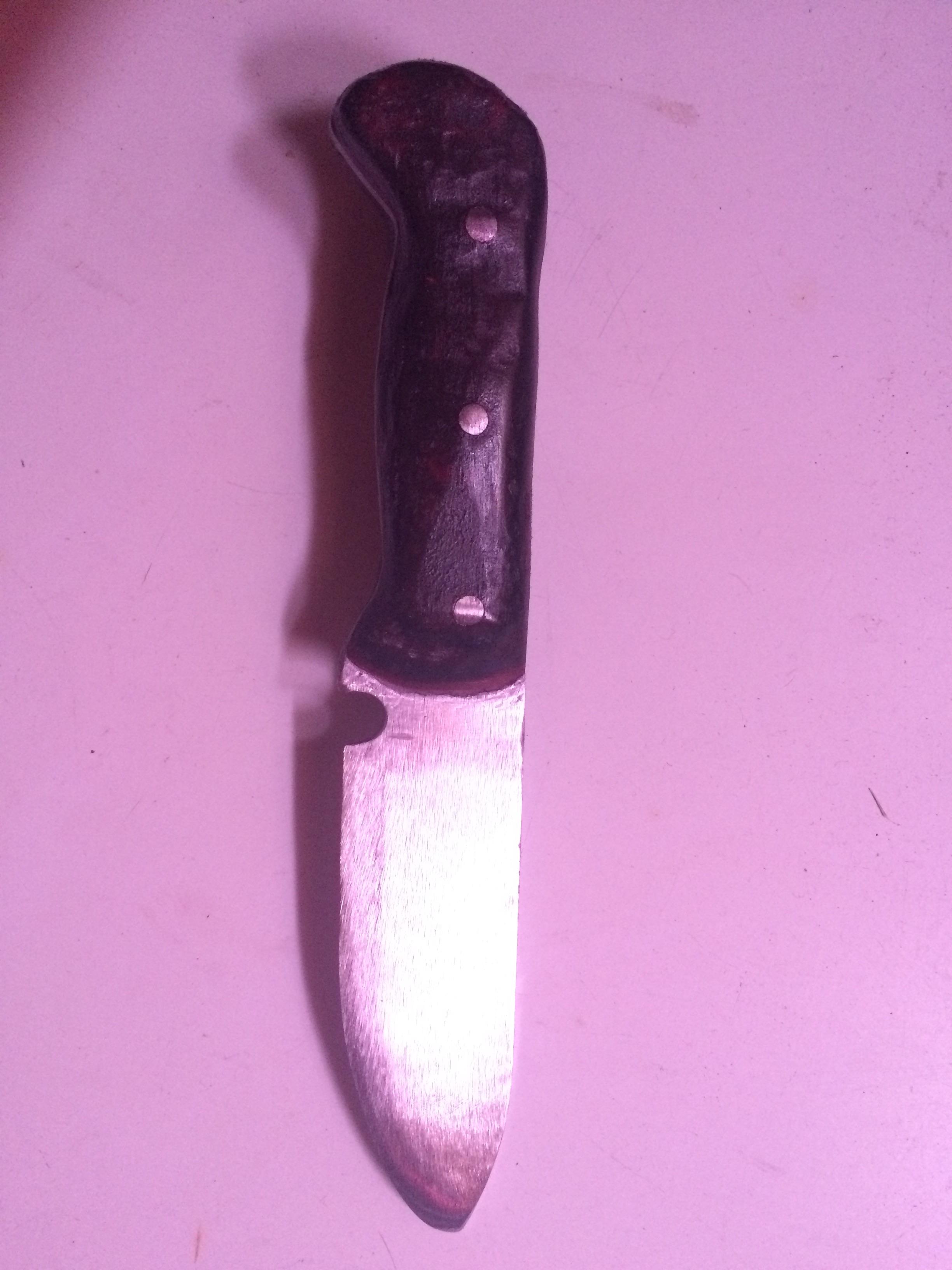

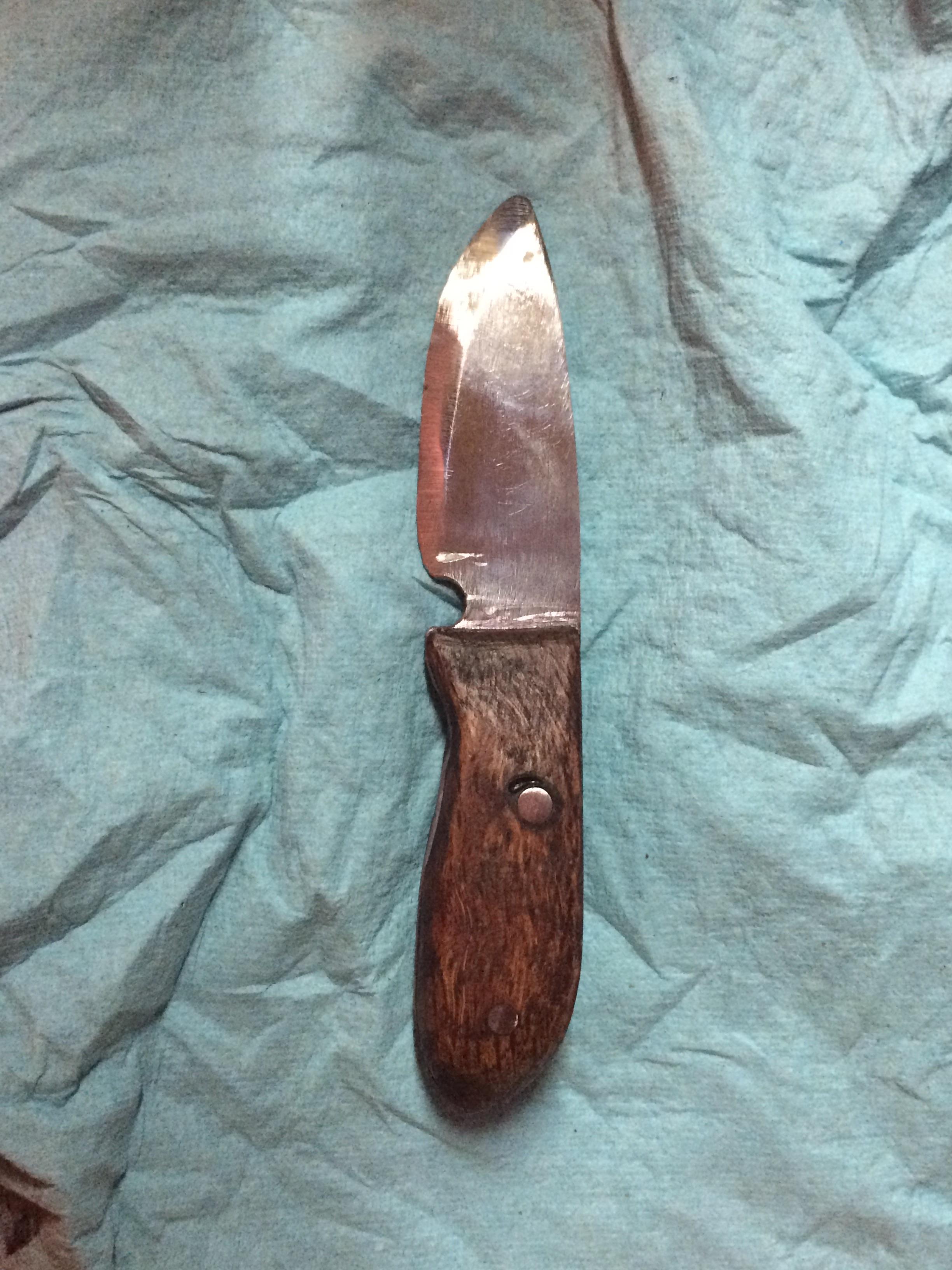

My first two knives
Jul 11, 2015
2
I definately need some advice, (aside from get a better bench sander, yes I do use the 4x36 harbor freight one. I will be getting better one as soon as I can feel free to give some reasonable recommendations) the first one is red oak with a stain and the larger one was my second where I made a Micita handle which I was not impressed with ( probably my fault, I used a felt instead of regular fabric because it's all I had and was pourus and dark. I'm wanting to make more and do better all advice is accepted. These are 1095 carbon steel.

Congrats on finishing your first two knives. Keep them for life, and look at them to see how you progress in the future. Overall, they aren't bad at all for a first pair of knives.
There are some issues on them, as you know.
1) The finishing has a long way to go. You should have sanded them a lot more before assembling the handles. Hand sand to above 400 grit and get all the scratches out before moving on the assembly.
2) You burned the rivets by grinding them down on the grinder after glue up. File them down, and don't let them get hot in later handle shaping on the grinder. Hand sanding the handle is a good way to get it smooth. All divots and scratches should be sanded out before any finish is applied.
3) Rivet placement is off. It should be symmetrical with the handle.
4) You can't make Micarta at home. It is a phenolic based industrial product. Making MyCarta is fun for some people, but rarely gives a good product unless you use expensive resins.
5) The choil on the second knife is a bit too deep. It only needs to be a semi-circle at most.
Take your time and don't rush it. If it take a couple weeks to sand all the scratches out and get the handle smooth, it will be time well invested.

I'm not going to lie, I just knew I was going to get a lot of snack or rude comments about the terrible job. But I didn't and I thank you for your polite advice. It's a good start here on this forum. I'm sure you. Can tell the first one uploaded was my first made. The rivets where a dead give away ( I invested in a cheap drill press before the second one) but they also got hot because I grinded them down. I agree on the finishing. Also any advice on getting a better edge and bevel on the blade? That's one of my largest problems I think along with needing to do more all around hand sanding.
File the bevels by hand if needed, to get things straight and flat. Take your time on the belt grinder. The one you are using is probably a bit fast and scarry. Using a grinding magnet to hold the blade may help with control.
