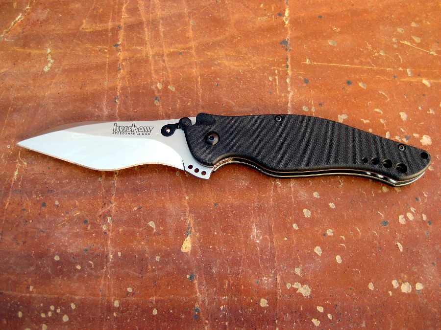

Before receiving the 1200/1600 ceramic stones and the diamond sprays with the leather strops, I used the WEPS on my Orange Skyline I carry for summer shorts due to the light weight as my first WEPS project and to get some experience. I put a nice, hair popping edge on it but stopped just short of a mirror finish on her. I was learning. The profile is even and the edge is nearly mirror but I just wanted to get my feet wet with a low value knife first. Plus the Skyline is a summer activity knife anyway and needs a working edge as opposed to a LASER edge.

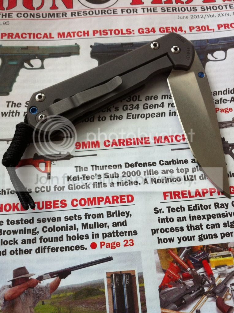

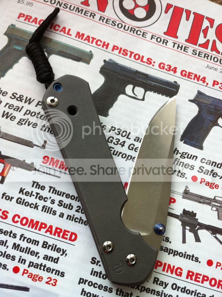

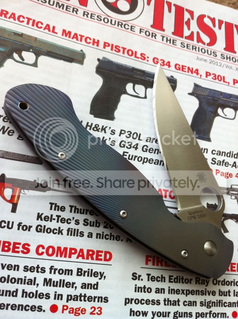

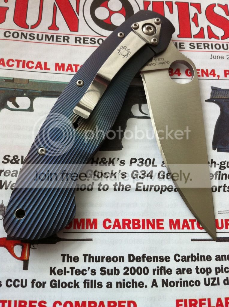

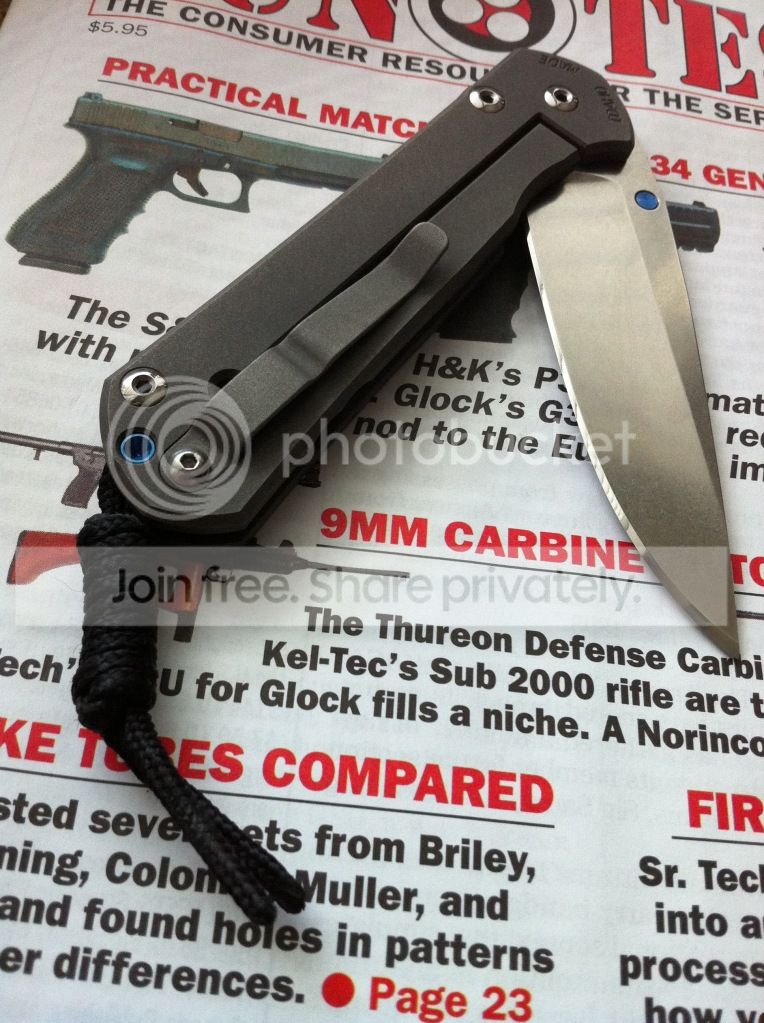

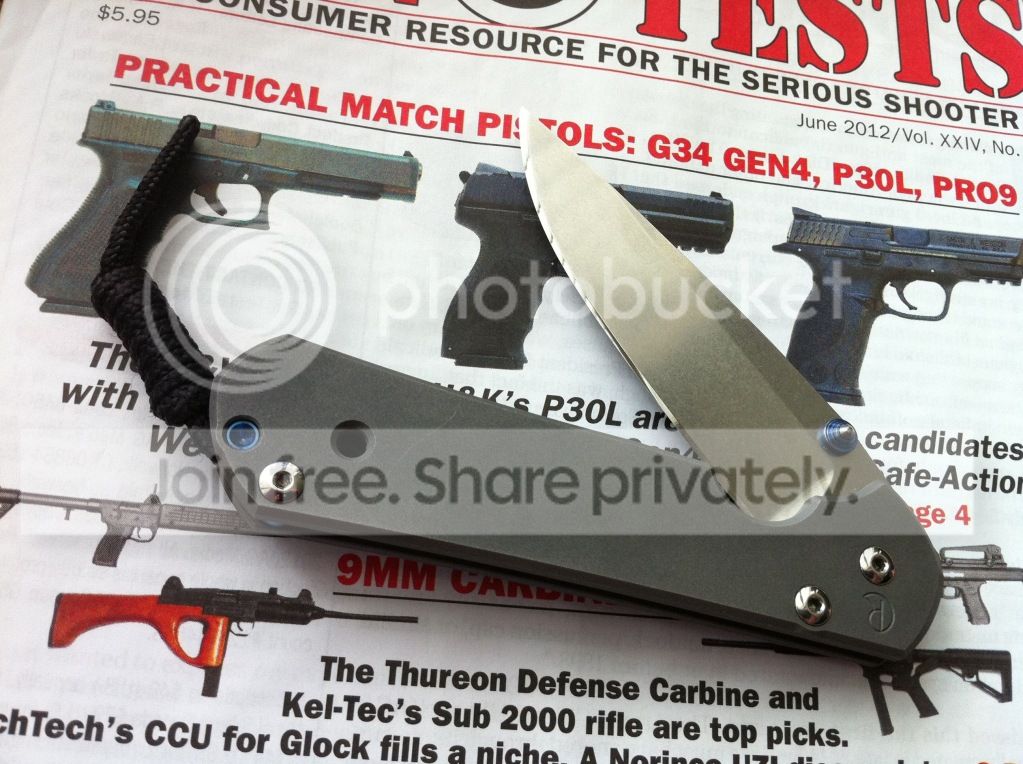

After getting the 1200/1600 stones and the diamond sprays, I jumped head first into my Fluted Millie and my S30V Sebenza since both are in my weekly rotation now. I'm delighted with the results. Here they are, my first ever mirror edges on two superb knives :) And let me preface the pictures by saying I have never had a sharper knife in my entire life. These knifes take the phrase "scary sharp" to a few levels higher. I can literally use each of these knives as a straight razor and that's no joke. And by that, I mean they shave just as easily as a straight razor minus the ergos of a straight razor. The hair just glides off at the skin level with no discernable resistance whatsoever - the WEPS makes a knife edge a LASER! I will proudly carry these knives even more now and look forward to showing the edges off any time I get the chance :D

All three knives I did were reprofiled and logged so I can repeat them later for touch ups. 15 degress for Skyline and Millie (The Military is a LASER slicer now :D) and 18 degrees for the Sebenza and I would say I have 40 minutes average on the Fluted Millitary and the Sebenza, each, and that's it. Once you get the device set up, it's a pretty fast process. This is the graduation I used in 40 minutes or so for each mirror finish - 100,200,400,600,800,1000 diamond plates, then 1200,1600 ceramic stones, then 5, 3.5 diamond paste on balsa strops (which aren't much finer than the 1200/1600 ceramics), then I finished them off with the .50, .25 micron diamond sprays on leather strops.

This is the epitome of sharp. But like I said with the Orange Skyline, I left a "working edge" on that one
