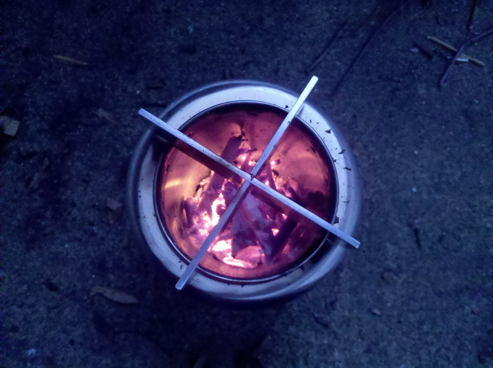

Okay folks here it is. Finally got it finished this weekend, burned some random stuff in it, but didn't really get a chance to use wood until this evening. I took the boy outside, we gathered a couple of sticks, and this is the result.
I took my ferro rod and my trusty BK14 and a PJCB and lit this sucker up.

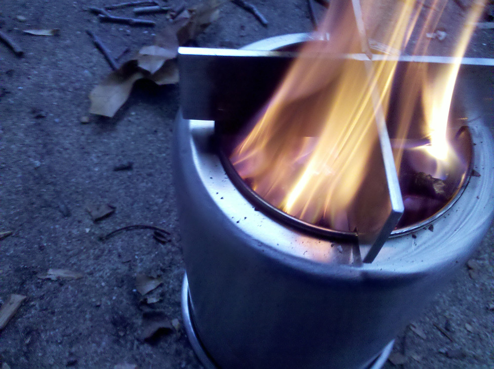

It went out fairly quickly after it started, but when I went to relight it, there was a distinct "fwoosh" of some type of gas igniting. Woodgas. Word to your mom.
Woodgas.
Fwoosh.

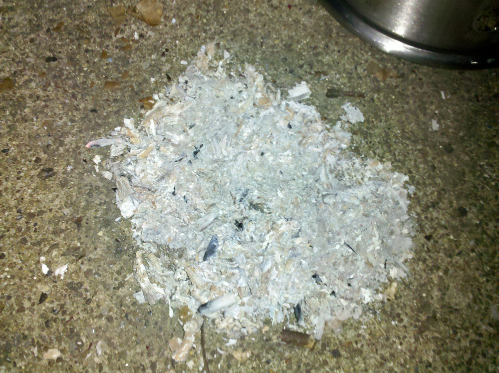

What we are left with.

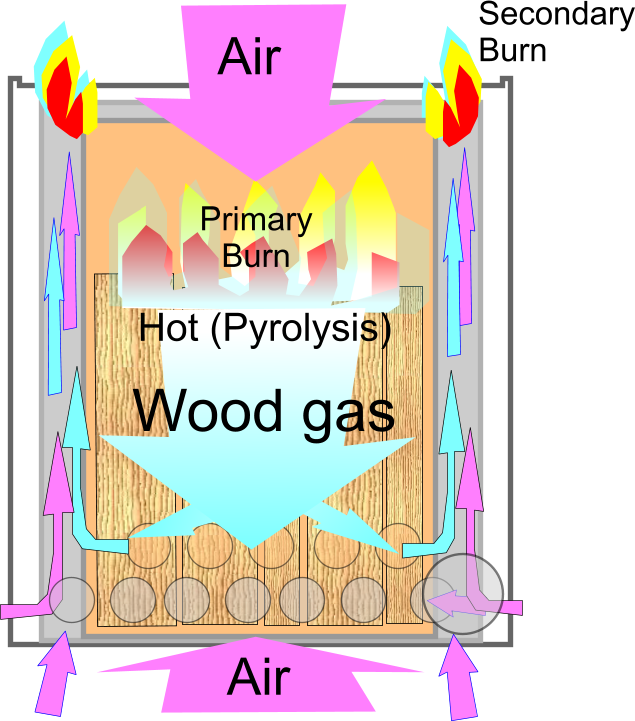

Okay, since Bladite lives under a rock, here are some more details. Basically, when you burn wood, it gives off gases that are normally just released into the air, making for a very inefficient burn. What a woodgas stove does is to add air to those gases, thus making them burnable as well, making for a much more efficient fire. More heat off of less material, and less waste left over in the process. Hence why this stove, off of a little over two handfuls of sticks was able to burn for approximately 30-40 minutes, and also why there was nothing left but very fine ash once the burn was complete.
As far as the construction, here is a diagram that depicts the process a little better.
What you have are essentially two chambers, the inner and the outer. The inner holds the material you are burning (charcoal, corn husks, wood, etc...) and has holes at both the top and the bottom. The outer chamber has holes at the bottom. Together, with the way they are made, air is able to flow with the gases that then exit at the holes in the top of the inner chamber, where they are ignited.

Anyways, as the wood burns in the inner chamber, air is drawn in and up through the area between the inner and outer chambers, and is forced out through the holes in the top of the inner chamber. There it mixes with the gases given off by the burning wood, and ignites, resulting in more fire.
After I initially lit the stove, it went out after a couple of minutes due to me not having enough material on top to properly catch. However, when I went to relight it, there was that same "fwoosh" you get when you light a regular gas stove where you let the gas run for a bit. Meaning the gases were still hot enough and mixed enough to generate flammable woodgas.
