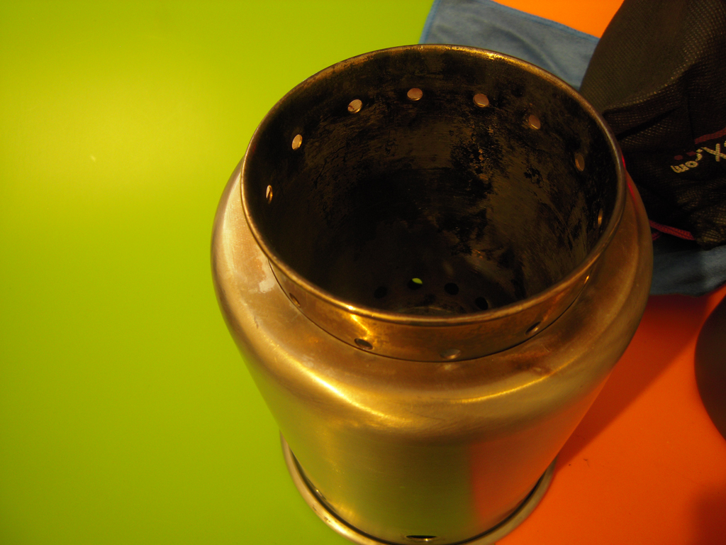

Hi Derekh, yeah I was talking about your stainless steel version. Couldnt tell from the picks the dimensions. It looked quite big. Heres a link to a set on ebay that is my exact setup, only my pot stand is a little different.

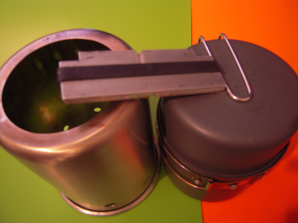

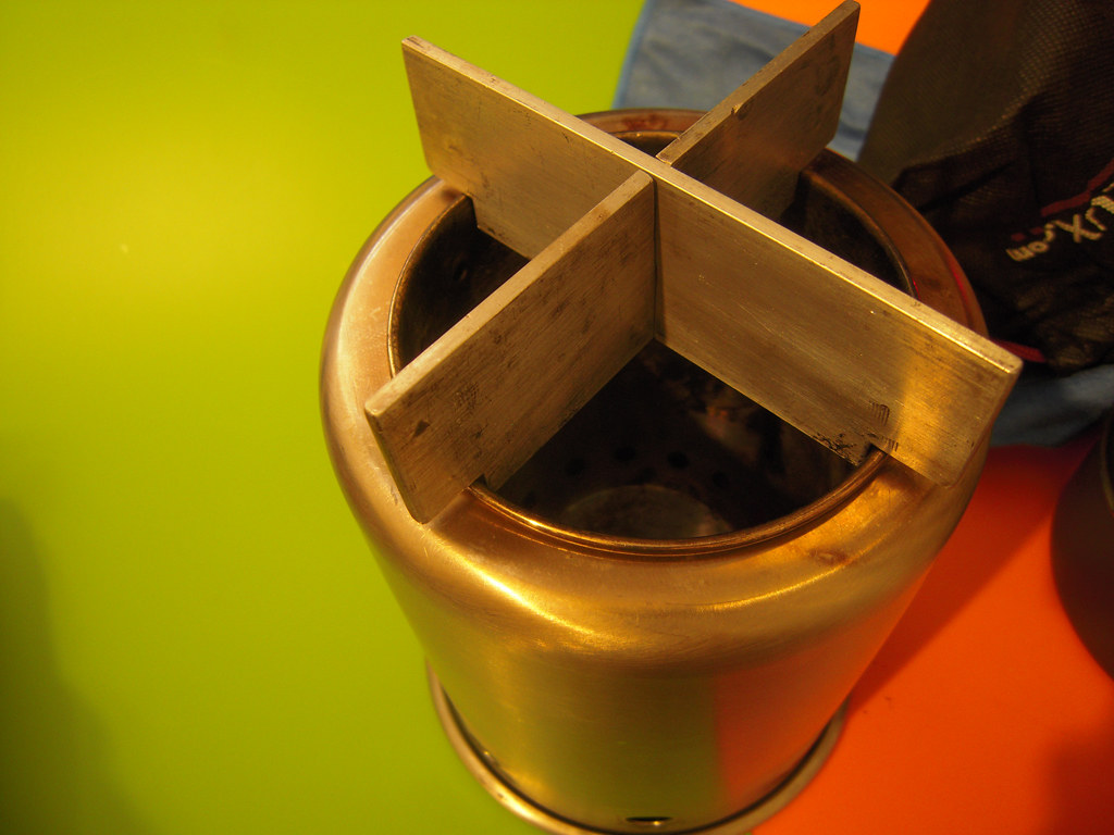

Sure thing. I will get more pics later (provided I remember) but in the meantime here is how it goes together.

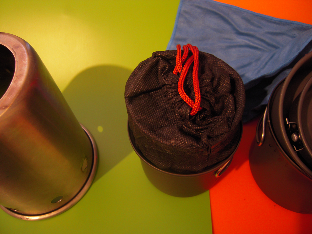

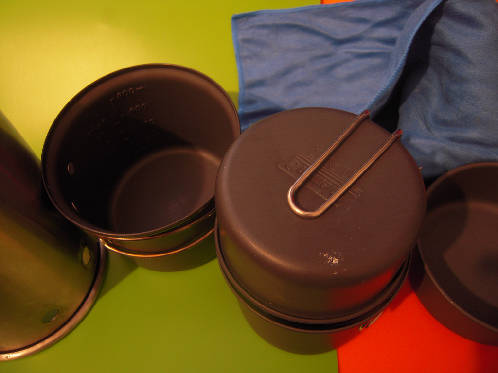

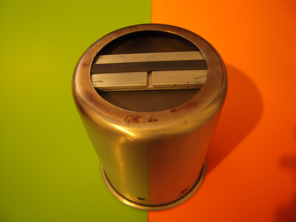

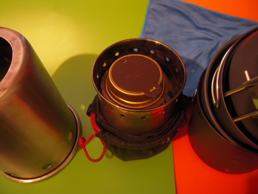

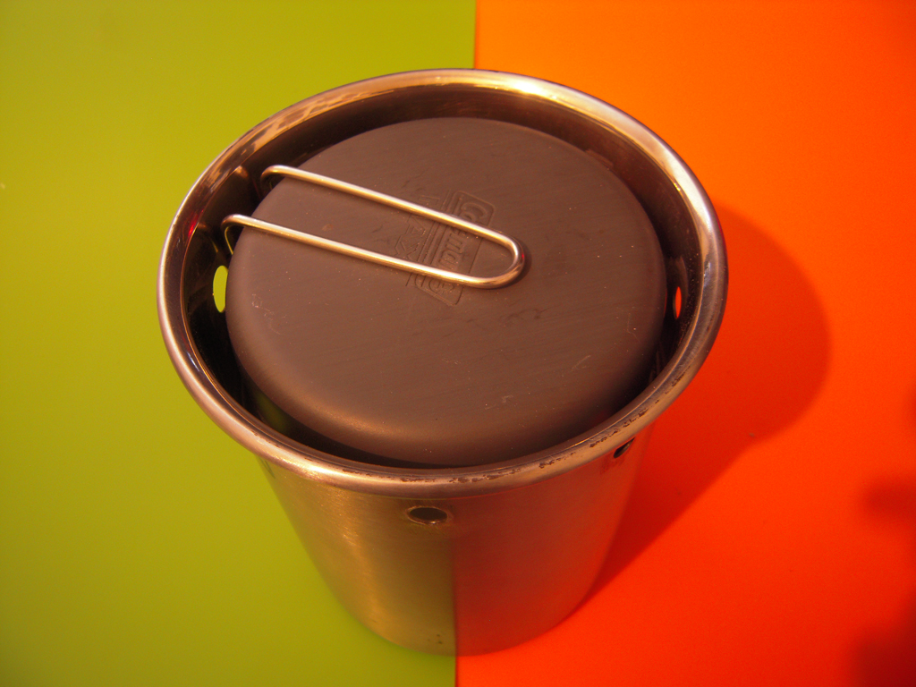

The stainless steel pencil holder in the middle goes into it's own bag, preventing it from contaminating the cookset, then fits inside the smaller set (the two pieces in the middle in the background). These then get wrapped in a towel (to cut down on clinking and clanking) and stuffed into the larger set, just as you normally would assemble it. Then the large outer container is turned right side up (if it were still a utensil holder) and the pot stand is placed flat into the bottom. On top of that the assembled cookset goes. It is a very tight fit, but it does fit, then the whole set is placed into the bag that the cookset came in and looks like this:

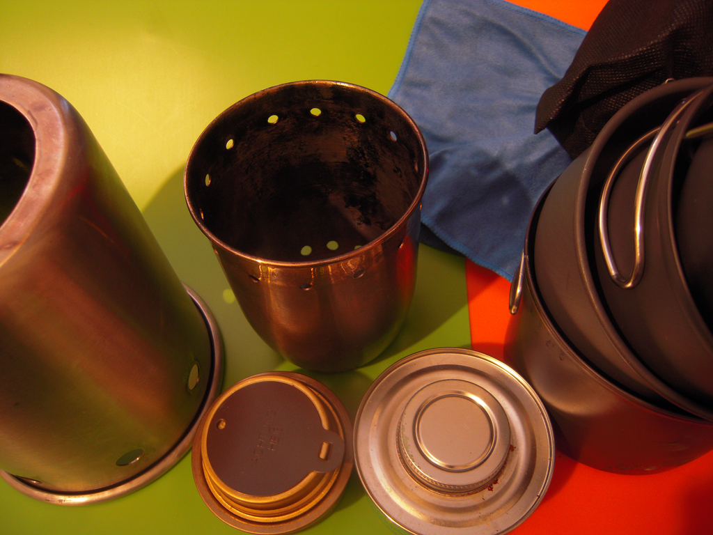

The very center piece has plenty of room to hold an alcohol stove and a can of sterno, or other such goodies, a fire kit, etc... Like I said, I will try to get pics up in the near future of how it all goes together.

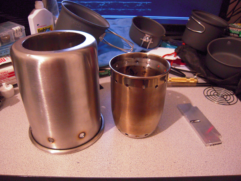

Oh, Thats perfect. The cook pots you have in the back ground are the same ones I was talking about. I also love how it comes apart (for easy cleaning/ repair) awesome. Well now Im on a mission to find suitable stainless containers to copy your design. Hope you dont mind, after all, imitation is the highest form of flattery. Thanks again
That is how it all comes apart, scroll up slowly to see how it goes together.
