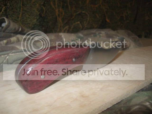

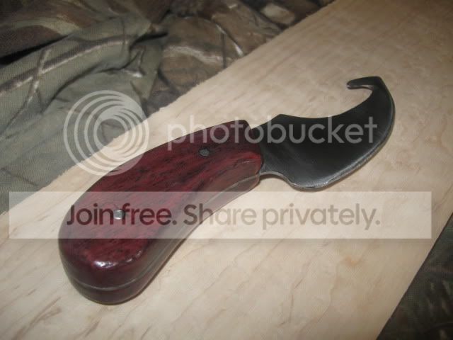

my first
Nov 3, 2009
103
made with an old saw blade and purpleheart for the handle.its not the greatest but i want to hear what you guys think!

If you drill the scales from the outside in, any splintering out of the hole will be on the inside of the scales.. (That is a little chip by the back pin isn't it? This moniter is getting old and dark.)

You undertook a difficult blade for your first. Nice job.

actually that is a grind mark from when i grinded the pin down! thanks for the tip though. any tips for grinding the pin?
cut it as close as you can then use a file to get it flush.

What did you use for a finish on the handle?
