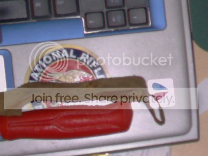

Stingray- I really like the sheath you have for yours. I've made a couple of similar sheathes that were stitchless for a Nessmuk and the first Puukko I made.
Is yours one piece stitchless? It looks like two pieces...does the tip poke out the bottom if you sheathe your knife too tightly? (A problem with my own) Any hiints or suggestions on how you did yours?
Very nicely done!

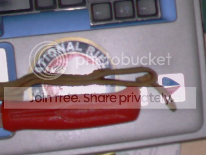

Yes it is one piec stitchless, and no the tip does not poke out of the bottom. The bottom is open and I can see how it could, but I made mine with a little extra length so it can't poke out. Like I said it is stitchless, but the way the design is the loop is too big and if you try to take the knife out one handed the sheath follows you halfway up, so I poked two holes through the loop and added piece of leathere strip and tied and glued it in the back so that the loop is only just large enough to accomodate a belt without any play. I also had a problem with the handle wanting to pull away from my hip because it is top heavy and I used fairly lightweight leather, so I added the keeper loop you see to the top of the belt loop. It just slips over the top of the handle and keeps the knife riding close to me.

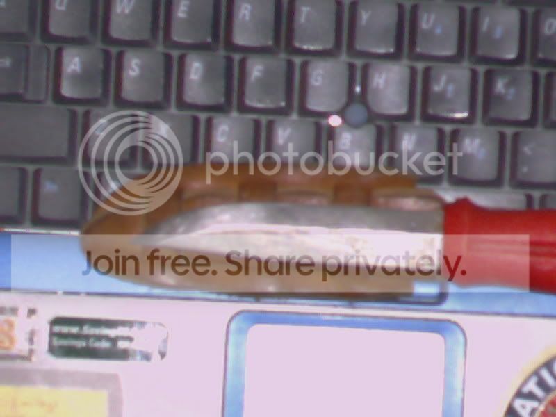

Here is a pic to illistrate how the sheath is longer than the blade so the tip doesn't poke out.
And here are a couple of photos so you can see how I added the keeper loop and the "single stitch" to make the belt loop smaller. You can also kinda see were the belt loop reducer stitch in my first thread. Anyways, hope it helps.

Another possible design problem that I noticed that could contribute to you point sticking out is that it seems that you made the sheath to go around some of the handle as well as the blade. If you noticed on mine, the sheath only excepts the blade and is folded over pretty tight so that the handle stops and can't be forced deeper into the sheath. I guess if you wanted to have the sheath cover some of the handle you could just make the slots around the blade part really tight and the slots around the handle part looser that way the knife can only go so deep before the handle can't fit through the blade slots. Hmmm... I might have to try this some time. Anyways, good luck on your next one, I'm glad I could help, and try to play with the layout until you like it befor you cut it out so that you only cut out what you want so you don't have to wast a lot of leather.
