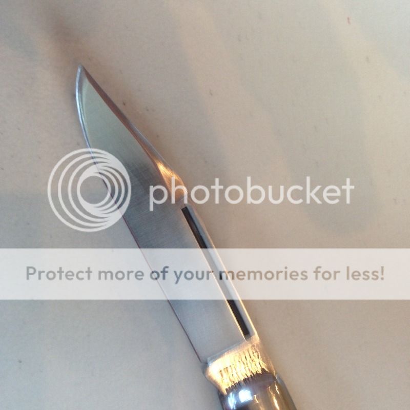

I received this fine little #14 in Gabon Ebony from my wife for Christmas. I truly liked the knife, and the spear master blade was great. But, I prefer a clip master blade, so I re-ground the spear to a clip. This little beauty spends a lot of time in my pocket now! Hope you enjoy seeing it!

How thick did the tip get as you raised it?
daizee: the tip is nice and thin, as it should be, due to the swedge being ground on both sides. It may not look exactly like it came that way from GEC, but I believe it's pretty close!
joeradza: all you have to do is take your time and make sure the steel doesn't overheat. I ground this one on my trusty ol' 4"x36" belt sander with a cup of cold water standing by to cool the blade. Never had a problem with the blade overheating.

texmex03: it took all of about 5 minutes to re-grind the blade. The only reason it took that long, was that I was going slow and making sure I didn't overheat the blade as I did it.
