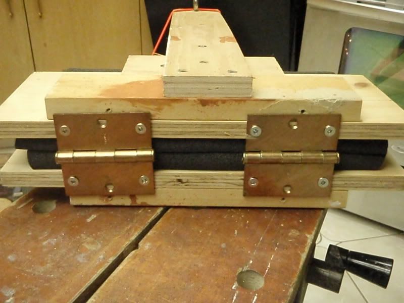

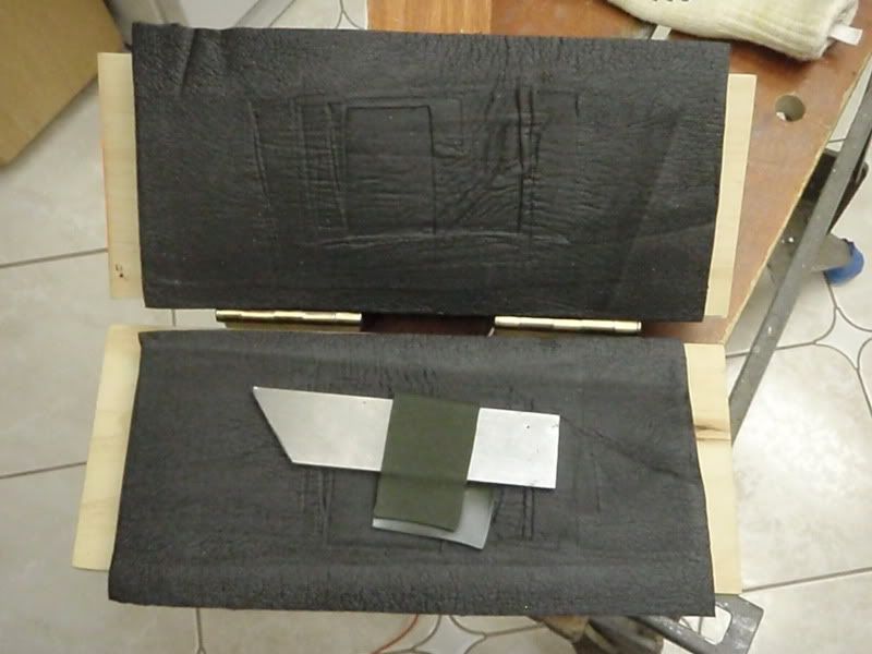

Here is my "press". It is basically a couple of 5"x12" pieces of scrap ply, held together with some old door hinges... the 1x4's are for some extra support and the long piece of ply is so I can get some leverage on it to squeeze the crap out of it. I bought an 11.5x12 piece of kydex foam from knifekits and sliced it in half to fit my narrow press. I then bolt this to an old work table... and carry it into the kitchen...

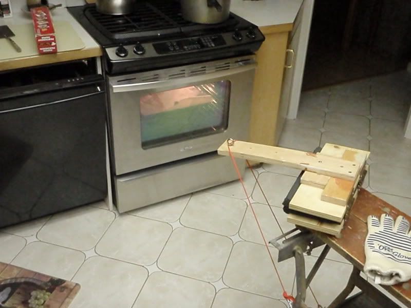

Notice my awesome "shop". It is a good thing mom isn't around when I make sheaths... and it is also a very good thing that I haven't yet stunk up her kitchen by melting kydex in the oven!
I think the reason I get such good results is because of the amount of pressure. I'm pretty sure that 50% of the time a sheath fails to be formed properly is because the kydex isn't hot enough to mold, and the other 50% is not using enough pressure to mold it. If you think you have enough pressure.... press it harder.... press it until you think your press might fling apart.
I have a pan with parchment paper and a small rock on the sheet in a 375F oven. I put the piece of kydex on top of the rock... wait until it starts to droop over the rock... reach in there and pick it up... and if it folds over easily like a noodle it is good to go!

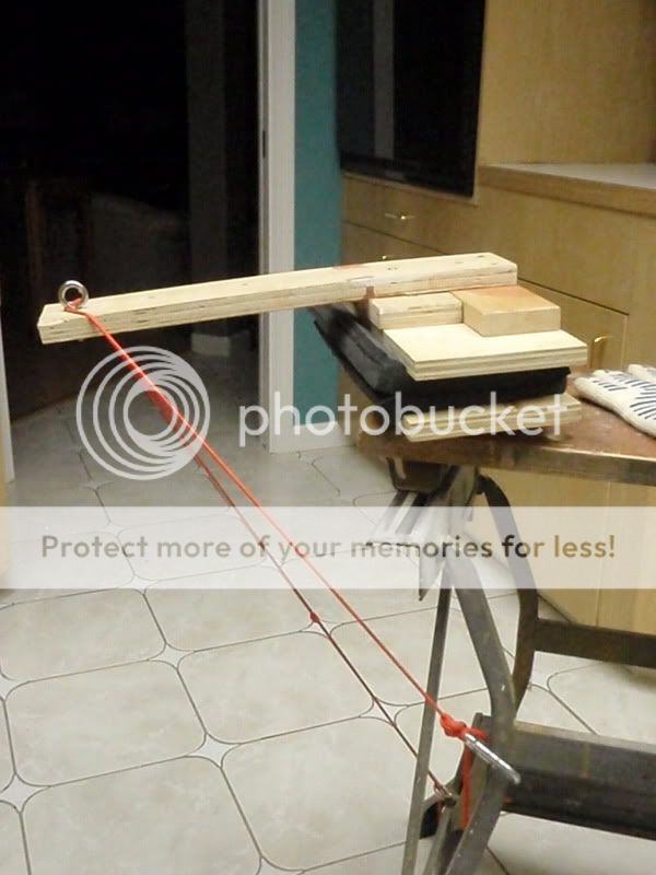

It was far too annoying to press down with my body weight for 5 minutes every time I wanted to make a sheath or belt loop... so I rigged up a very sophisticated tension device.... a piece of paracord with 2 carabiners...

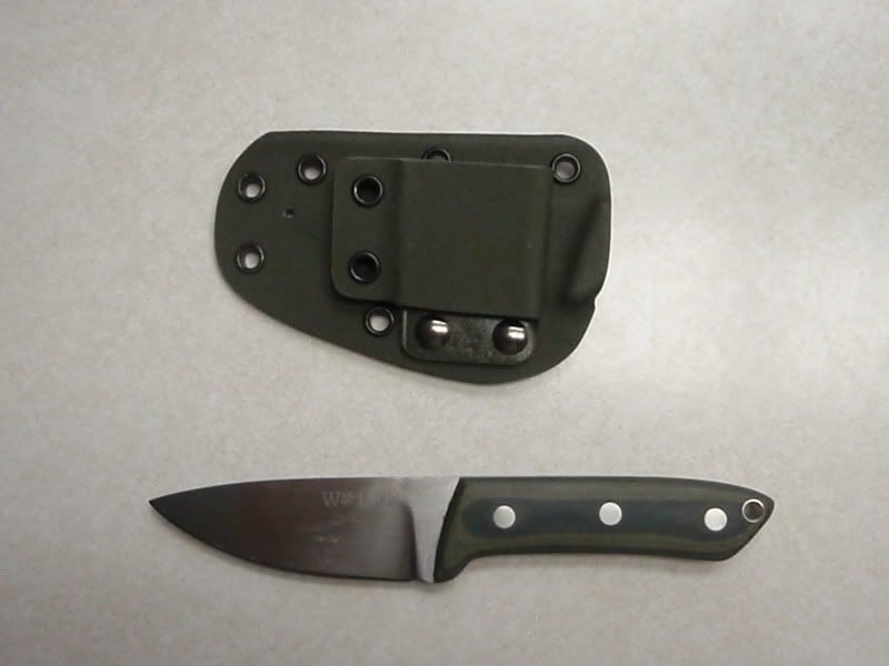

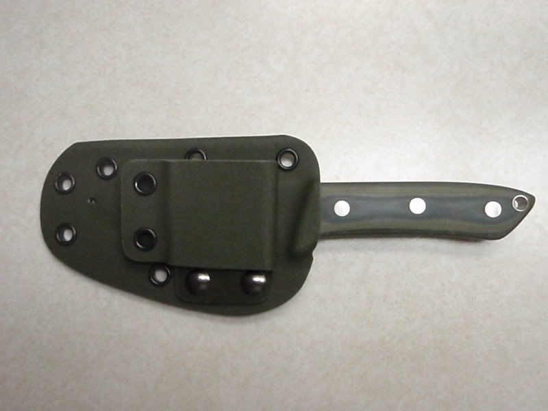

Here is the knife I just sold to my buddy and the loop he requested. All done with the above tools...
Anyways... that's just my way of doing it. There are better ways, and the kydex pros will probably get a good laugh out of this :D. But hey, all this "press" cost me was the price of the foam!

I am curious on how long this molding foam lasts, 10 sheaths,50,100?
Can you use the outer edges of the foam to mold when the center gets worn, or should you replace the foam when the center is worn and not use the outer edges surrounding the center?

@blandies I've made ~10 sheaths now with this foam... so I can't comment on how long it should last. But I think if you have to get into finding unscathed areas on the foam you should probably just replace it to save any headache. Knifekits sells bundles of foam cutoff's for cheap that would be the perfect size for this size of press

I use that blue foam (for camping - under sleeping bags) and it will do maybe 50 sheaths before you really need to change it in my opinion. I dont even have a press, I just spray glued some foam to some plywood and clamp it. Super cheap and effective!
