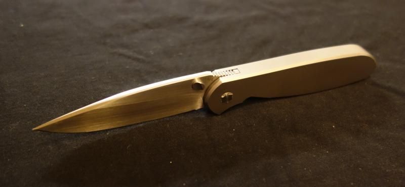

I have been EDCing my Michael Raymond Estrella for a few weeks now and thought I'd post a mini review.

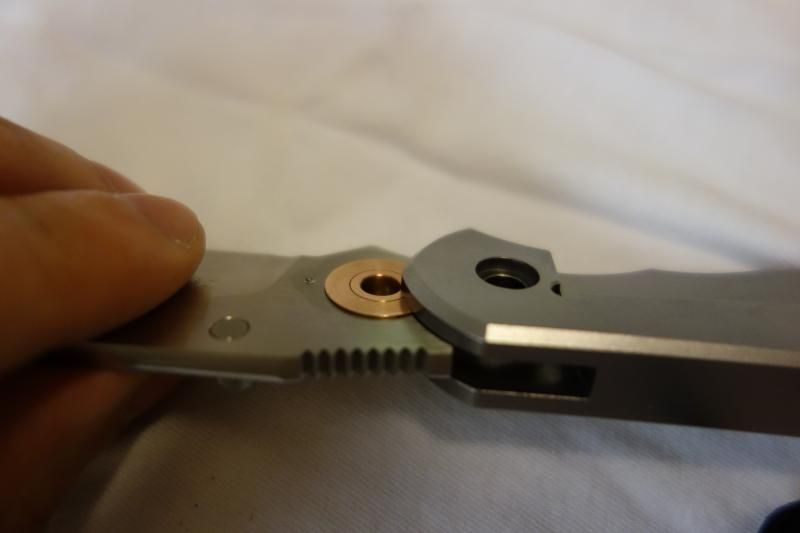

Fit and finish on this knife is absolutely impeccable! The blade action is glassy smooth. Both the lock up as well as the closing detent is bank vault solid. I love the feeling of this knife locking up! I own a Scott Cook Lochsa and the Estrella compares very favorably. The Estrella also has better ergonomics for my small to medium sized hands than the Lochsa.
Michael's knives use phosphor bronze pivot bushings as well as large phosphor bronze washers. A lot of newer knives use bearings. I am personally not a fan of bearings -- they are more easily gunked up in the field, they cannot take as much lateral stress, and they are more difficult to disassemble/reassemble. With the pivot bushing system, the washers are held in place by the bushing so they automatically line up with the pivot hole. This allows for effortless reassembly by the user. More importantly, with this type of pivot, all one needs to do is tighten down the screw and the action will be perfect every time. There is no Loctite needed, no need to worry about the screw loosening over time, and no need to fiddle with the screw to find the correct tension. In my opinion, pivot assemblies made this way are superior to other methods. Making a pivot this way is also more expensive and difficult to manufacture than a bearing system which is why we so rarely see it on a knife. Unfortunately, even Chris Reeve is moving away from this type of pivot.

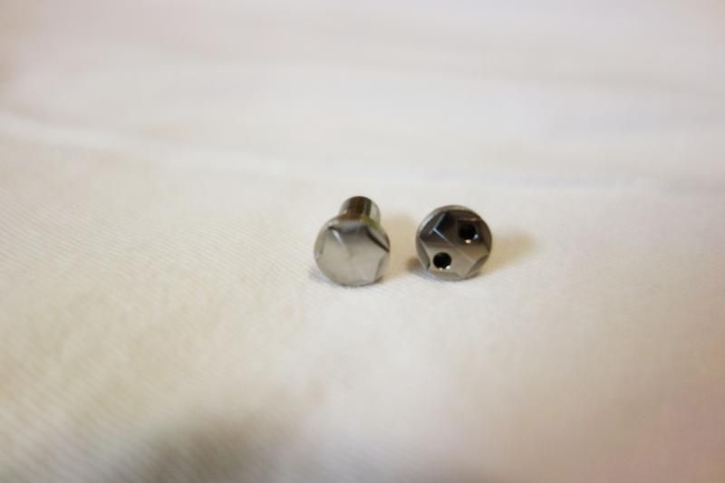

The pivot female end as well as the pivot screw is also handmade by Michael.

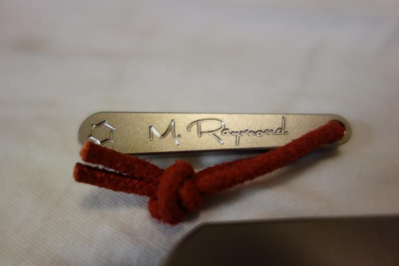

The Estrella comes with a titanium take down tool, which Michael also makes, a work of art in of itself.

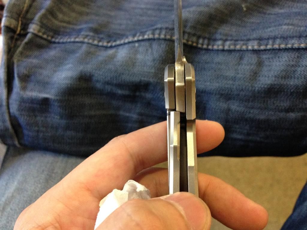

I'd like to see a photo of the lock engagement, if you feel so inclined.
Best Regards,
STeven Garsson
Here you go Steven.
Thanks!
Imo, this is certainly acceptable, but for a knife of this type, I would like to see about 1/16" or so less engagment for a new knife.
Best Regards,
STeven Garsson
Steven,
If you prefer the earlier engagement because it may increase lock life, I would not worry. If you ask Chris Reeve how many of his titanium frame locks he has had come back that have worn out due to the lock bar wearing across the blade tang, I suspect the answer might be zero; and this is with sebenzas having a 50-70% lock engagement. Many on the forums feel that an early engagement on a titanium frame lock means a longer lock life. This belief probably stemmed from the days when knife companies such as Benchmade were just starting to use titanium liner locks and they would not heat treat or harden them in any way. Soft titanium on hardened steel would obviously wear quite rapidly.
A frame lock with hardened titanium will not wear in the way many people think, slowly moving across the tang. A person may even wear out the ceramic ball bearing before the lock bar ever moves enough to hit the other handle scale.
