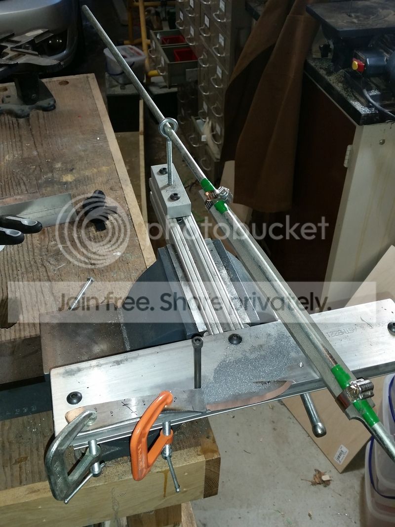

Like many DIYers, I always make it a point to walk by the scrap bin at work. I came across a few pieces of 80/20 and thought I should make a new gough jig. I am also working on scrounging up the supplies for a NWGS 2X72, but the file jig does an amazing job, especially when I'm just having fun anyway. The blade in the picture I took up to nearly a full flat grind, it only takes about 15 minutes to "grind" each side of the blade. Thanks again Aaron!

Nice, I'm going to steal your idea of using the plunge stop bolt as the blade keeper as well. Good thinking!
